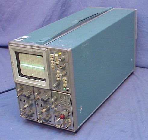

                                        Re: Oscilloscope
                                        Originally posted by Peter9DO View Post
                                        Now just so we are on the same page, when you say DSO your are referring to the Nano style oscilloscopes correct?
                                        No.
                                        DSO stands for Digital Storage Oscilloscope.
                                        It's a standard term.
                                        All it means is the scope has some memory in it so it can save a trace and display it for as long as you want to look at it.
                                        Analog scopes don't do that.
                                        They display in real time, then it's just gone.
                                        Very hard to trouble shoot intermittent problems [spikes] or see the shape of a pulse with an Analog scope.
                                        I don't even know what you mean by a Nano style scope.
                                        My DSO was made in the 80's so they call it a 'Storage' scope even though it's an actual DSO.
                                        It looks like this:
