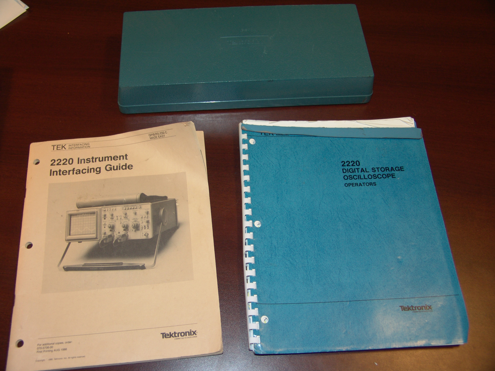

        #43
        Re: Oscilloscope
        I got the hard shell cover for the front. The original manuals, the manual holder and it's in VERY good condition! I will post a picture of it here in a little while.

            #45
            Re: Oscilloscope
            Originally posted by PCBONEZ View Post
            Yes.
            Here are the specs for the 'stock' probes for that.
            Need to get probes with a compensating range that covers the input capacitance.
            Need to get probes with the correct input resistance.
            Both the above are different between 1x and 10x probes.
            You probably want at least one of each of 1x and 10x or one with a 1x-10x switch.
            [If you connect to 50v with a 10x probe the scope only sees 5v.]
            When you get the probes connect to the test signal and adjust the compensation for a nice square square-wave on the screen.
            [That takes out error due to the cable size and length and the probe.]
            The adjuster is usually a very small screw. Location varies.
            Could be near the connection to the scope or on the probe itself.

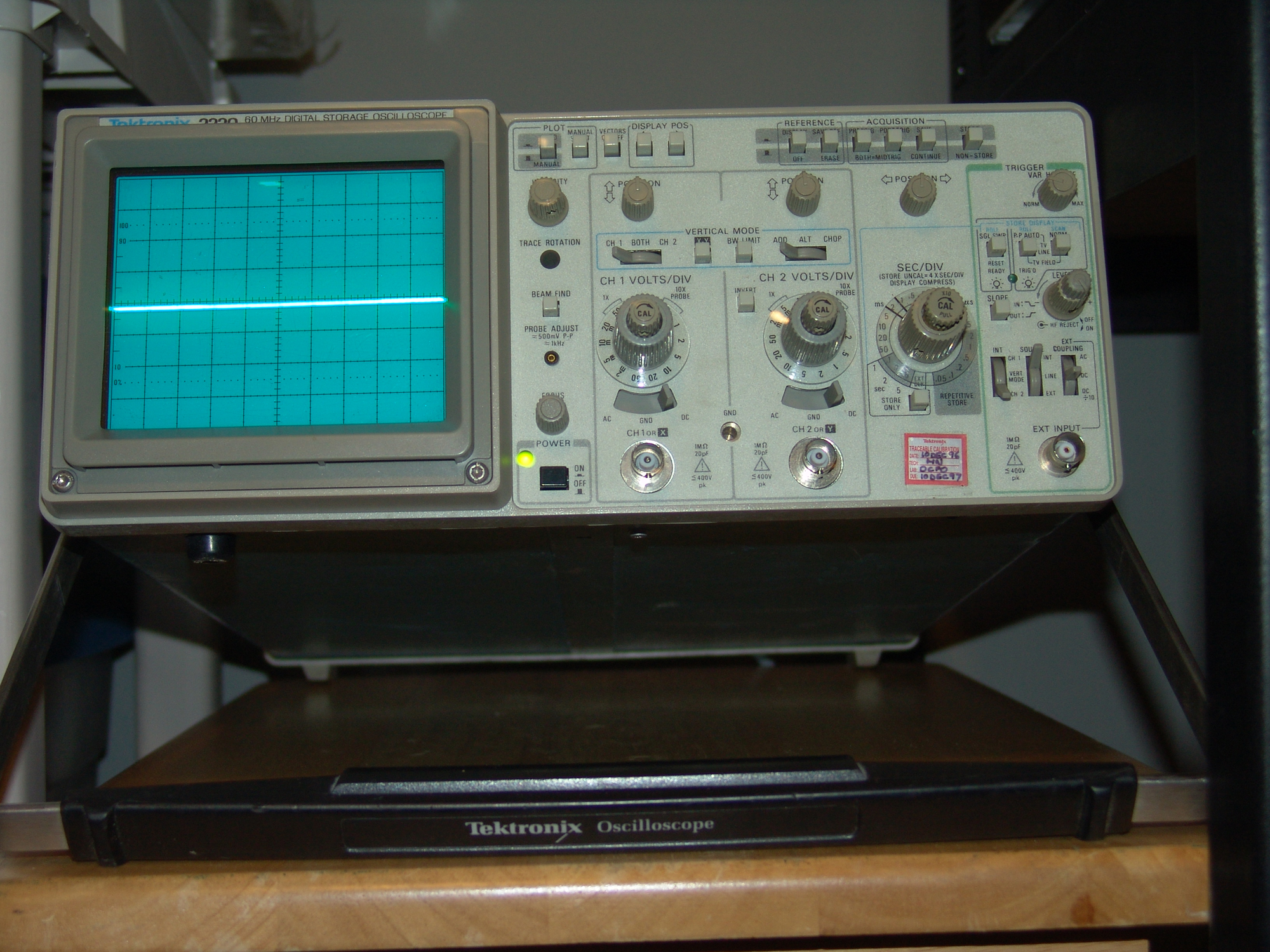

            By the way, thank you for finding this PDF for me! Here are the images of my purchase.
              #46
              Re: Oscilloscope
              Looks like a runner.
              See where it says "Probe Adjust, 500 mV P-P, 1kHz".
              That's the port to adjust compensation on the probes I mentioned earlier.
