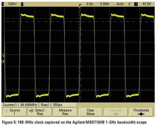

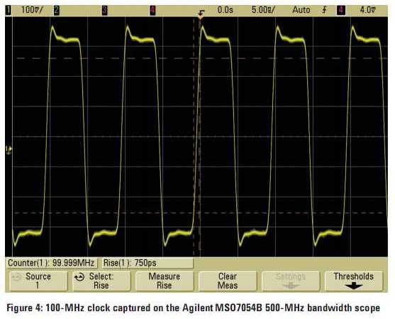

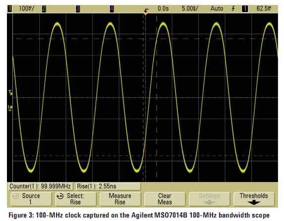

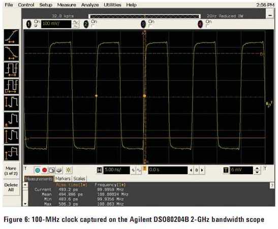

                            #33
                            Re: Oscilloscope
                            The rated bandwidth of an oscilloscope is the SINEWAVE bandwidth. A pure sinewave has no harmonics. If you're trying to measure a switching signal which is usually a square wave, you need to be able to accurately measure at least the 3rd harmonic as well (tho catching up to the 5th is preferable), so you need your scope to have at least 3x the bandwidth of the signal you are measuring.
                            Sort of.
                            I read about that elsewhere before but it wasn't explained as well there.
                            ~So~
                            For analog you want 3x.
                            For digital [like a square wave] you want 5x.
                            So a 50MHz scope would only be good for [at most] a 10Mhz square wave.
                            [And no matter what, more scope bandwidth is better.]
                            Below are some visuals out of the PDF.
                            A 100 MHz square wave on various bandwidth scopes.
                            100 MHz square wave on a 100 MHz scope. [1x]
                            100 MHz square wave on a 500 MHz scope. [5x]
                            100 MHz square wave on a 1 GHz scope. [10x]
                            100 MHz square wave on a 2 GHz scope. [20x]

                                          Originally posted by PCBONEZ
                                          Sort of.
                                          ~So~
                                          Looks interesting, I think I get it now
