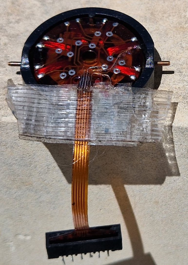

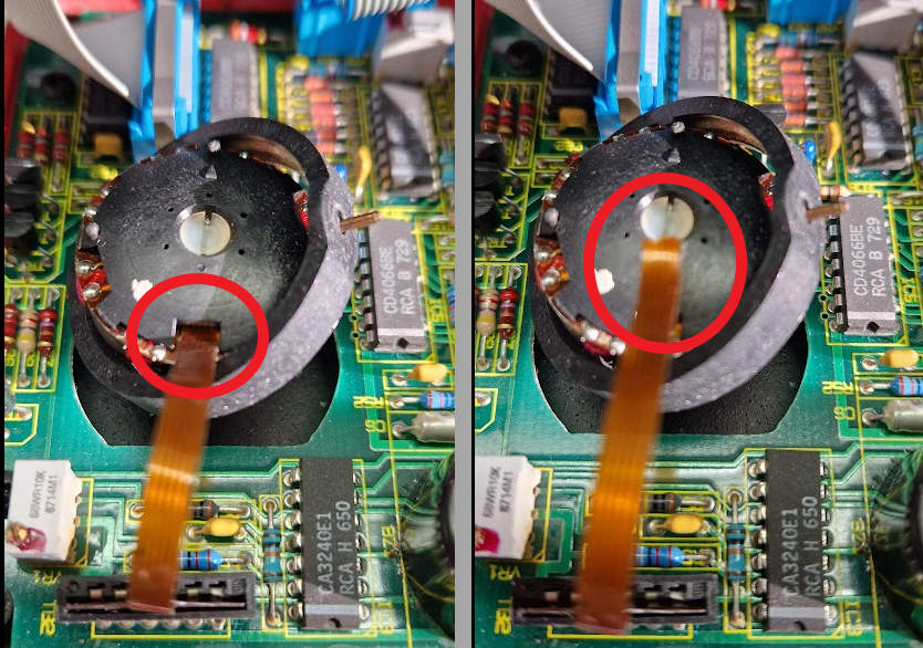

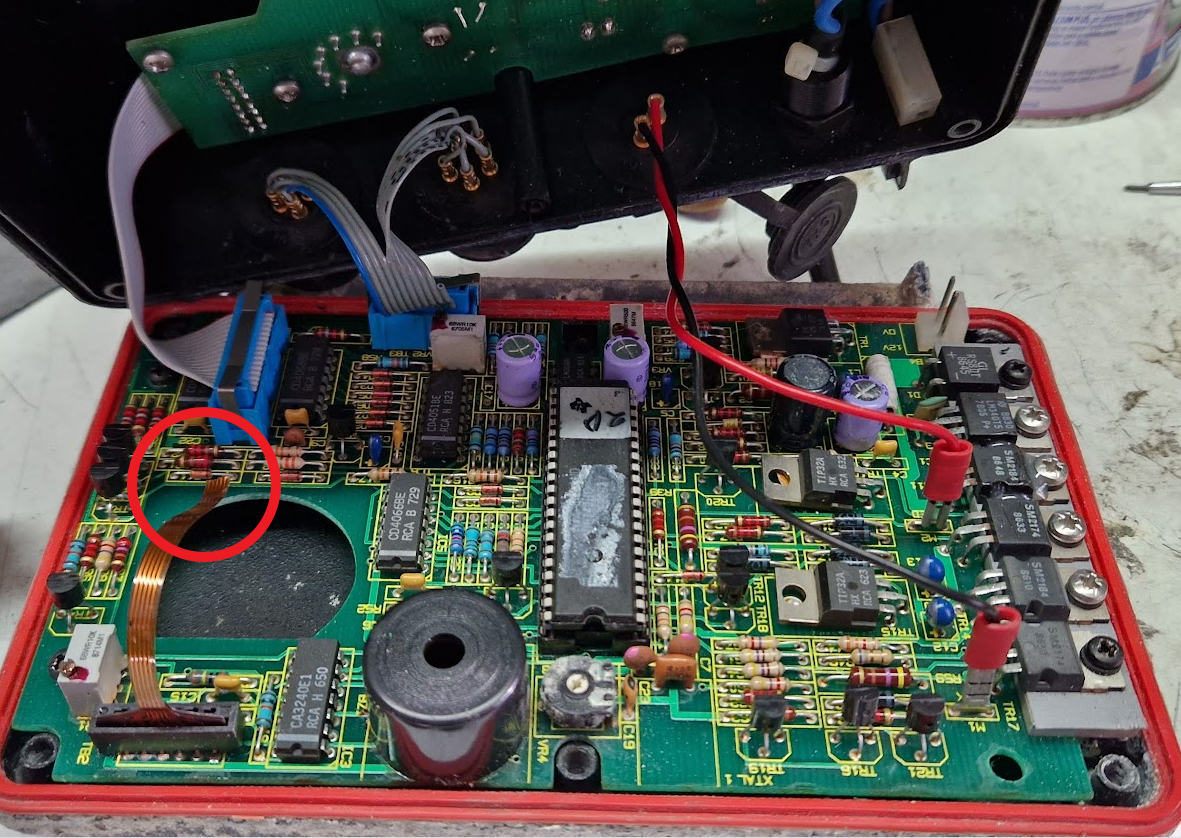

    I am trying to repair this broken ribbon cable that was directly soldered to a gyroscope pcb. Any hints what can I do please? I was tempted to rewire with thin winding wire but am afraid that the added weight would affect the freely rotating gyro. FYI, this is a marine Auto Pilot unit.

    If you have an unused spare or defected laptop cdrom , you can find inside plenty of those ribbon cables . Make a similar cut joint and solder it .

      Yes I have from scrapped DVDs. Good idea. Tks

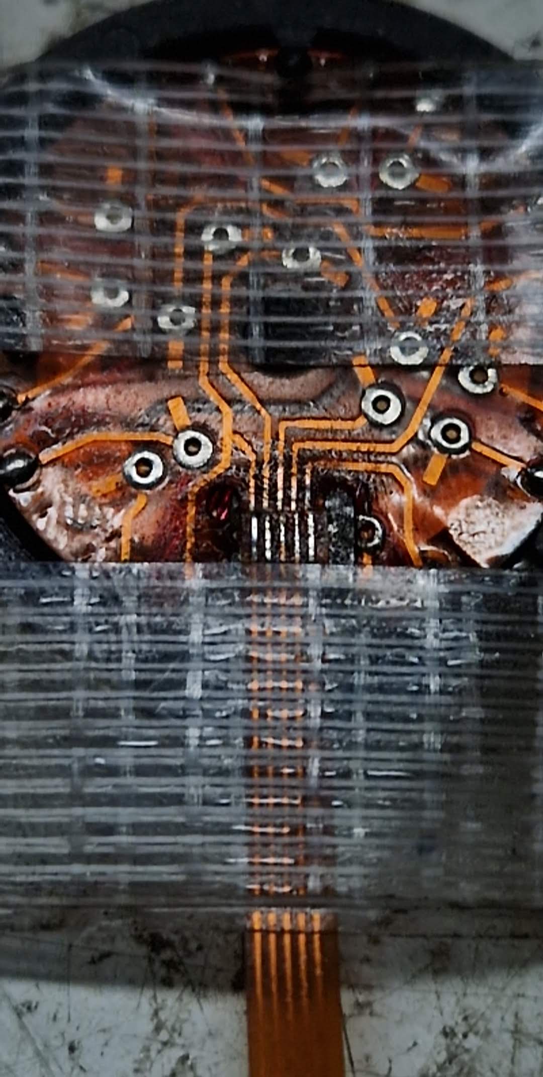

        Managed to solder some single strands and jobs seems fine. Have applied a thin film of super glue on top to secure better the strands.
