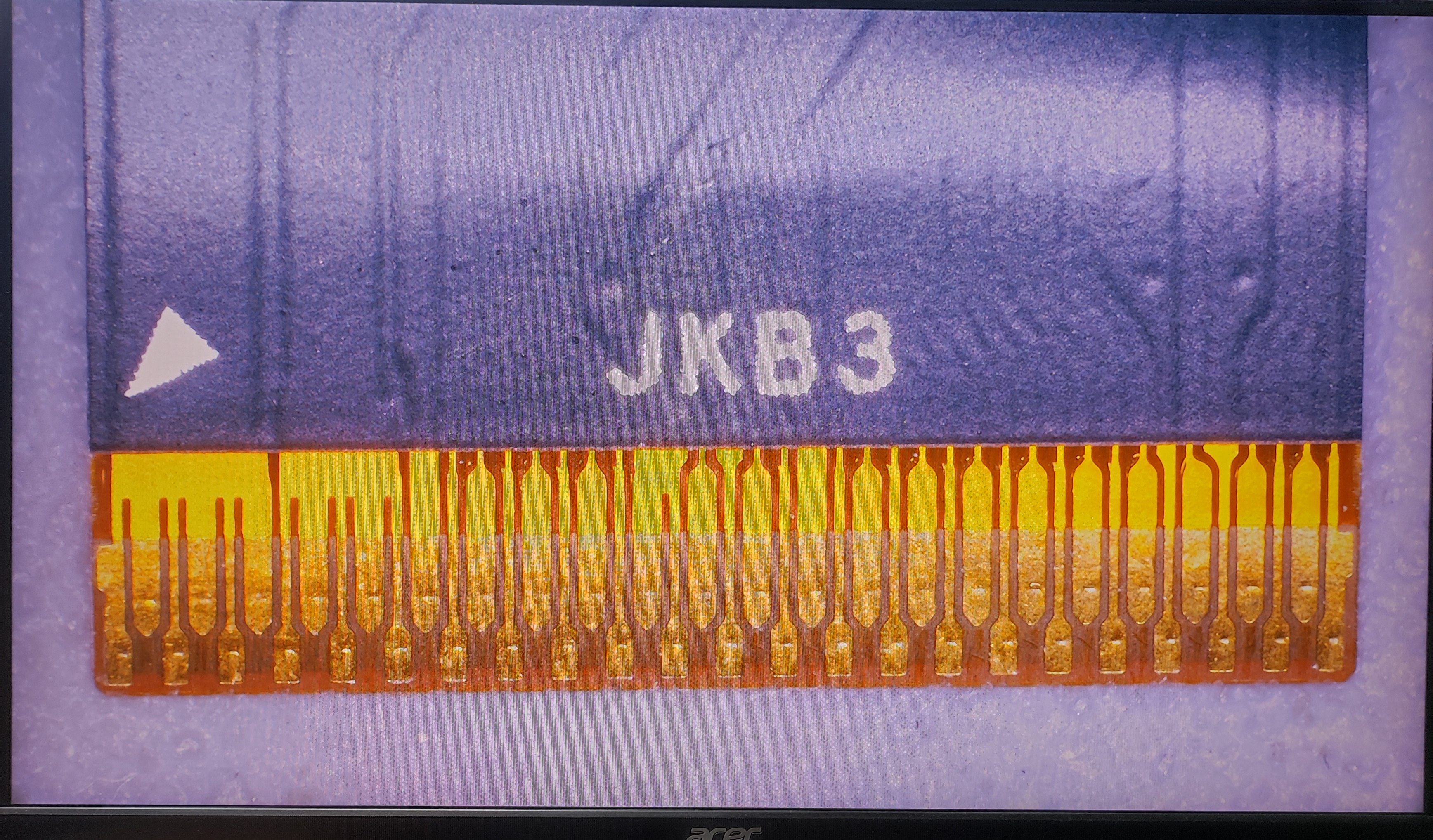

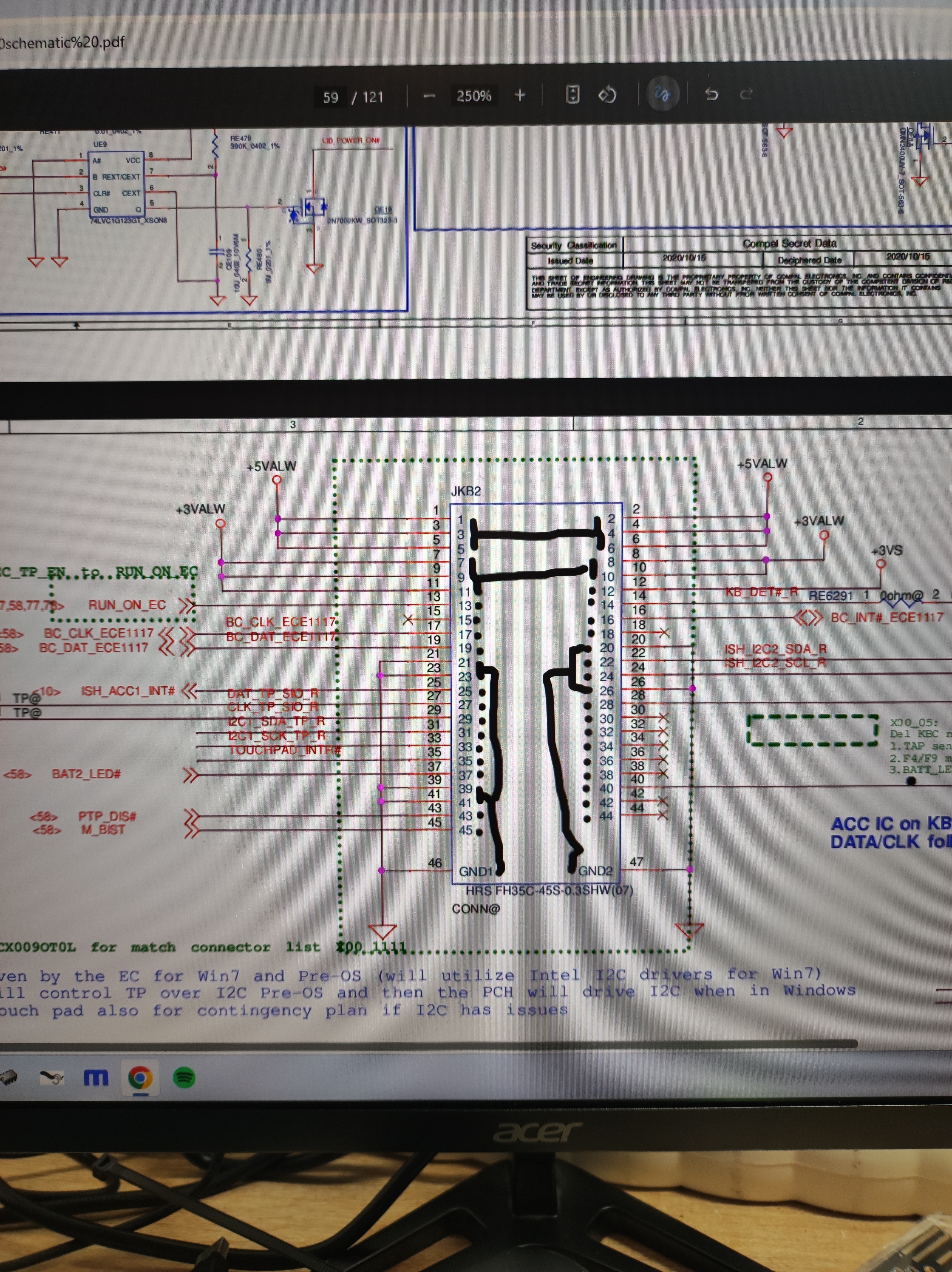

    I have a XPS 9520 with broken daughter board and missing ribbon cable. I can fix the board by replacing the connector, but I can't find the correct ribbon.
    There is 2 models, idk which one is needed on my laptop.
    0xkvng
    00vpr2
    Daughter board is LS H822P. When I check for a palmrest, the board attached to have a 0xkvng ribbon. But when I check for LS h822p, it's 00vpr2 ribbon...
    Someone can help me with that please ? Idk the difference between these 2 ribbon but they definitely doesn't look the same..
    thanks 🙏

    Can you just count the pins and measure the pin pitch and buy a generic replacement? Or is it a very custom cable?

      I have this one, 00vpr2. I check the pin layout and the schematic, look like good
