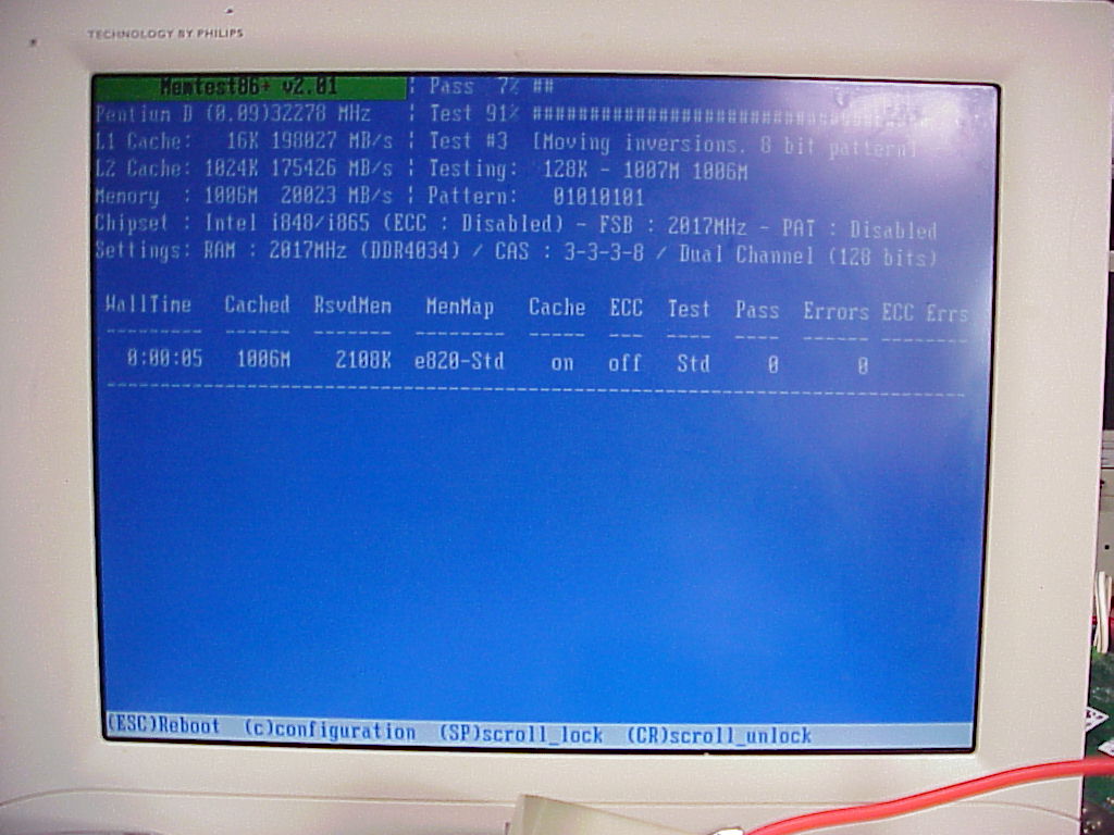

    those polys i put on this d865gsa really woke it up!

    32Ghz with a 2Ghz fsb.

      bad disk or bad board

        If it was a "bad disk" (I'm assuming you mean the CD with memtest86 on it), memtest86 wouldn't have started at all.
        Bad board? If it runs fine otherwise, no.
        This is just a funny glitch, that's all.

          the only thing wrong with the board is that pentium d 3.2 is a mini furnace.
          100% stable now though.
          intel used ost on that board.all of them had hatched.
          the capxon's in the antec basiq 500 were ready to die too.1.2v of trash on +12 and 800mv on +5.

            You can get funny numbers if they didn't add 100% support for your particular chipset. Have seen it before, nothing to worry about as long as the test runs through without problems.

              you would think 2.01 would have i965 support.

                That is a bit weird.. i965's a bit old nowadays, so i would expect memtest86 to pick it up correctly.. Then again i remember trying to run an old version of memtest86 on an Athlon 64.. Talk about crashy... .

                  True, very odd for such a common chipset. Who knows, might be BIOS related or something. Anyhow quite funny

                    The i965 team is right down the aisle from me at this writing...
                    I haven't looked into the 2.01 source code, but I also would be surprised to see no support for this chipset.
                    The bug that always annoys hell out of me is the chronic failure of all diagnostics when testing the AMD-761 chipset. Every 761 board I have, all fail. No version of diags will pass them, yet these boards have been running for almost 10 years.
