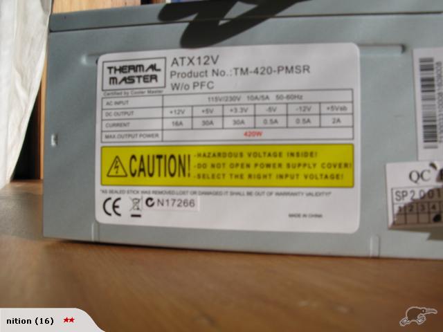

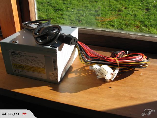

      next time check with us FIRST.
      if this is it
      http://cgi.ebay.com/NEW-OEM-THERMAL-...07161510r19507
      i would remove it and put fortron.
      thermal master seems to be one of those chinese comapnies that don't exist.

        Yes, that is it. It looks exactly the same as that. I managed to find some pictures of an identical unit that was 420W on a NZ trading website (pictures below).
        The unit my client has a power output of 350W and I can't get to it because the PC isn't here. At the moment I can't even imagine what i'll have to say to get that PC back here.

              Ok, I finally got the info about the PSU from another Australian forum on computers. These are the rating on the side of the Thermal Master PSU and they seem to match the ones that I've commited to memory when I was building the PC.
              +12V, 10A
              +5V, 14A
              +3.3V, 14A
              -5V, 0.5A
              -12V, 0.5A
              +5Vsb, 2A
              Apparently when all the rails are added up, output is only 250W and not 350W.

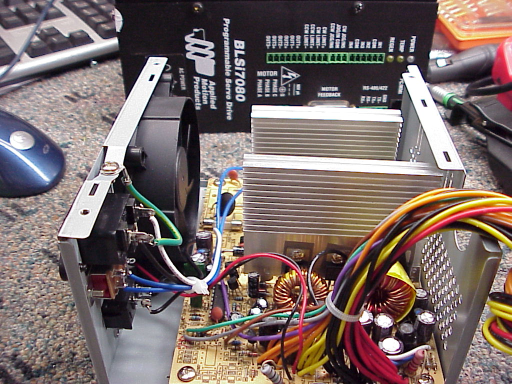

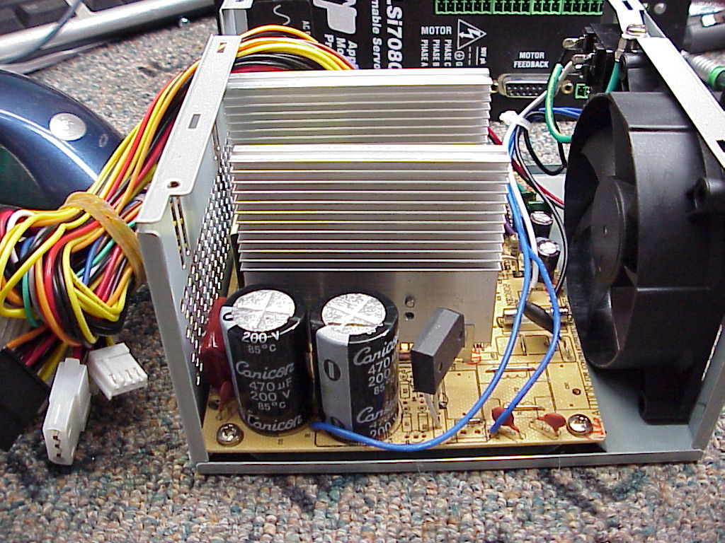

                                yeah make sure it doesnt look like this P.O.S!
                                  Re: Thermal master PSUs....
                                  What the ...
                                  I saw AT psus with more caps and coils inside.
                                  Zandrax
                                  Have an happy life.
                                    That PSU wouldn't be so bad for a basic computer after a complete recap and a new fan, it would be okay for a basic Intel Celeron Dual-Core E1200 computer with integrated graphics.
