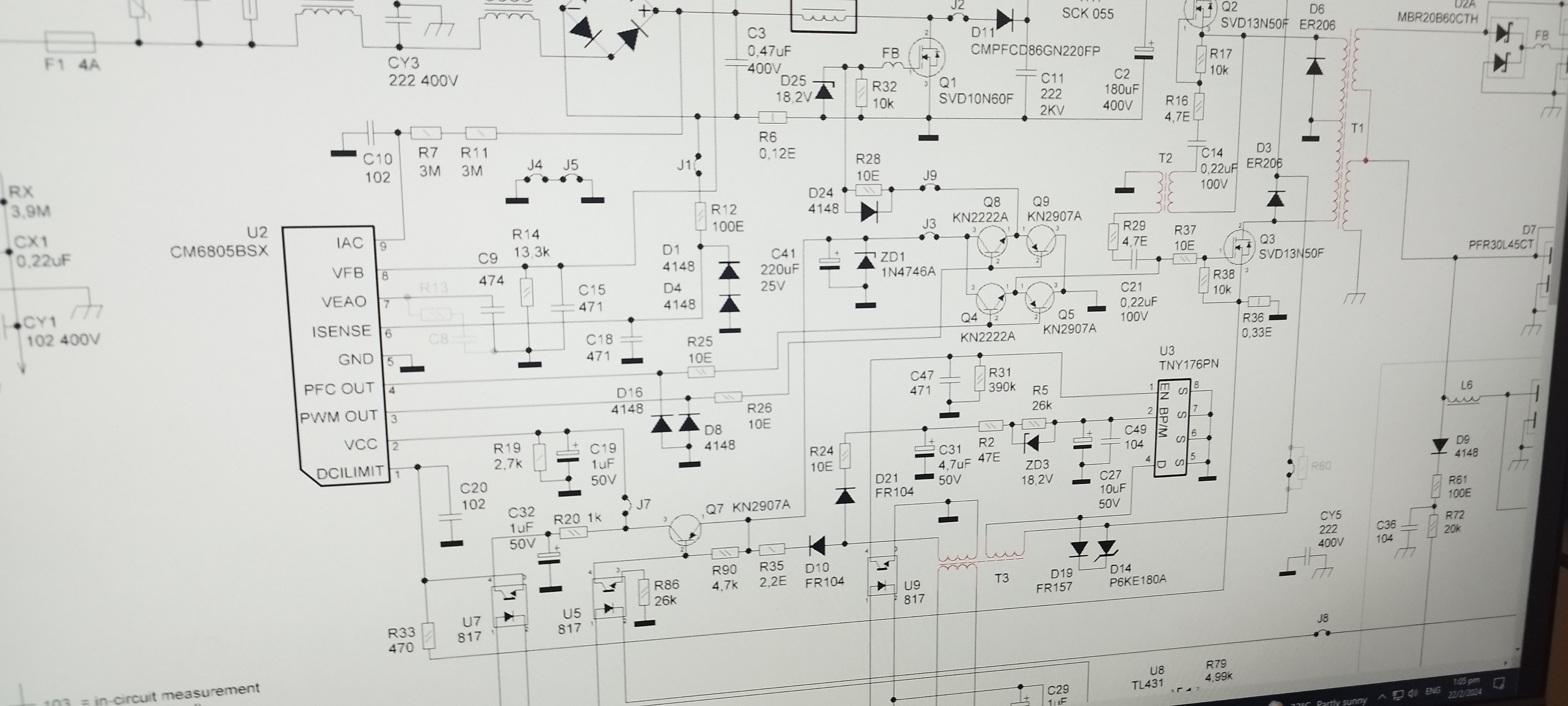

    I am attempting to repair this. Circuit is quite simple, but i a quite stuck at it for a long time. so today i try to ask for new ideas. my challenge is to under stand what mistake i made. I had repaired not lesson than 50 pcs of various brands ATX psu . main pwm chip is Cm 6805 Sip 9 .
    5VSB is fine. When I short Pson, totally nothing happen. I check , the Cm 6805 VCC pin2 did have 16v, But totally nothing happen. I changed to a good chip from another good PSU. Same thing.
    What other pin should I check such that it will result in no start up at all ?

    To add, the pwm to the mosfet has 2 transistors Kn 222A and Kn 2907 A . I had checked and all normal.
    Pin 9 IAC i had check and add addtional resistors but still no start at all. Click image for larger version

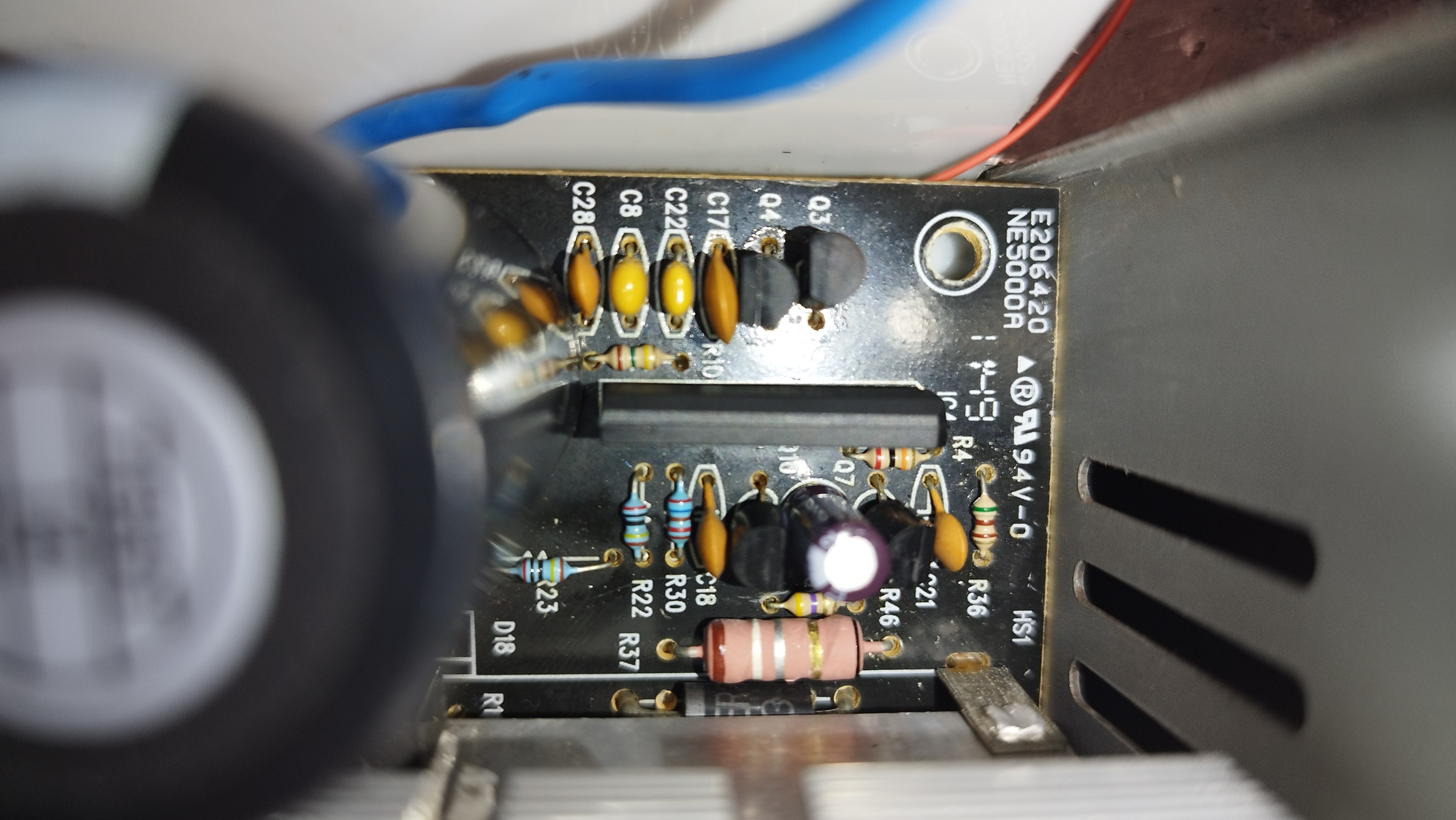

      the actual picture of the components as follow. This PSU seems so new that i suspect easy job but .......

              Short green line and the opto couple will cause vcc to have 16v. This part is normal. No square wave from chip as I measure .

                  The schematics is not the actual one. But from another psu. So may not directly apply. But very similar.
                  VCC have 16 v. But not Pwm to the main mosfet. The mosfet seems ok . The chip is the 9 pin type.

                                    Thanks for all your input, at last I decided to change item by item. When I changed the 2 npn transistor, the psu works. I measured both in diode mode, they are normal..
                                    so anyone can tell what is a better method to test npn transistor or to buy a tester ?
                                    as mention from start I am more keen to explore what I do not know. Whether this pc got repaired make no difference to me.
