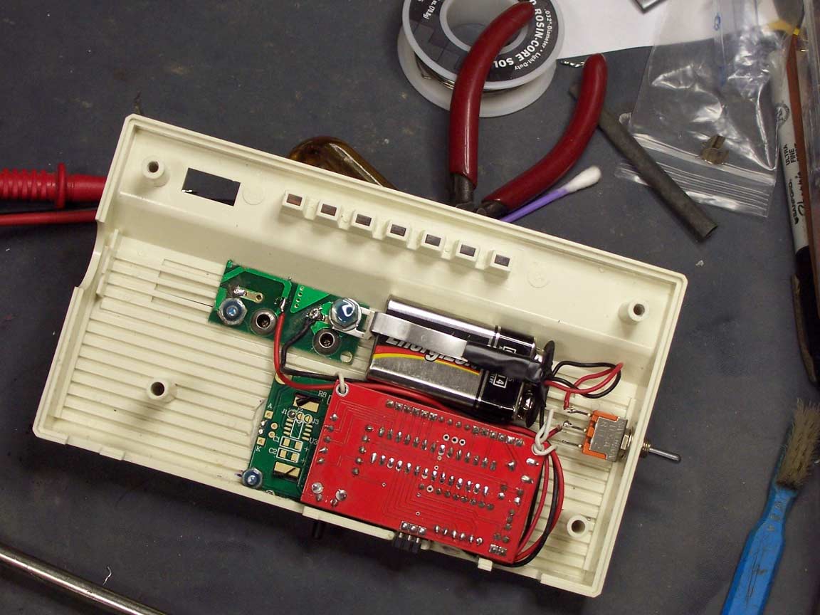

                    Re: ESR meter kit - not working
                    All right, the esr meter lives, I had to go out and get a 100 nf cap for calibration purposes - hope + or (-) 10% tolerance is close enough.
                    I think I'm gonna mount it in an defunct modem enclosure, and I was thinking of putting three binding posts on the box as a place to attach some meter leads, unless I can get away with just 2 binding posts.
                    Why does it have 3 inputs, anyway, can anyone tell from the schematic I uploaded what is the purpose of having 3? In the limited lierature for it (there's 2 whole pages) there's no mention of that.

                      #30
                      This meter may also be able too test transistors etc hence the the test holes.
                        • 31304
                        #31
                        for testing transistors and double-diodes etc.
                        go read that pdf i posted.

                            #33
                            You're right, it's a transistor tester too, I'll have to mount it so the little 3 pin header just sticks out of the box. So, maybe 2 binding posts will be enough...

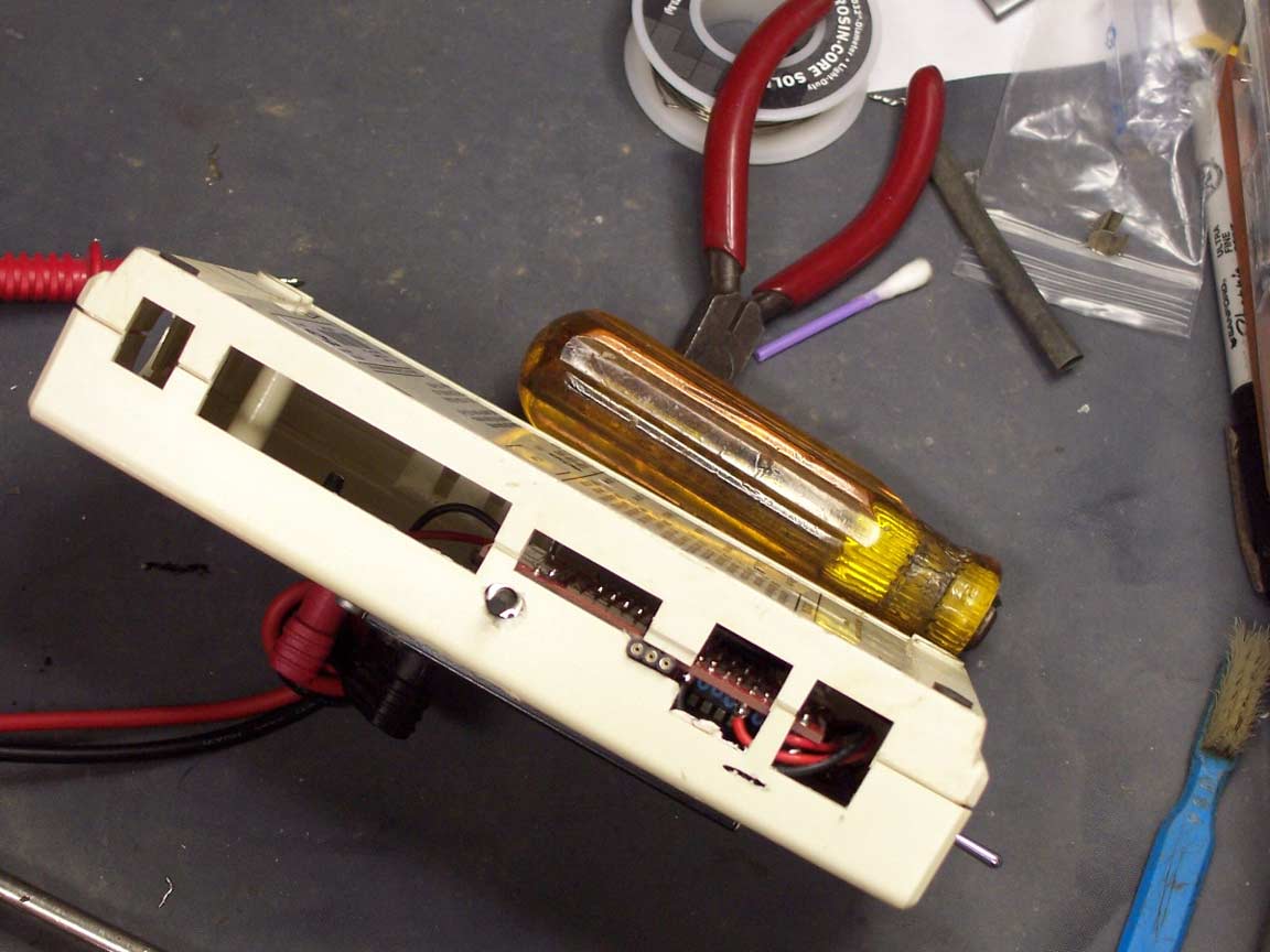

                                #35
                                Thread title would now read 'ESR meter kit - now working' if it morphed with the progress of the thread.
                                It turned out ok, but I had a couple slips with the dremel, was thinking of putting the pics in the ghetto-mod collection, but then decided not to. So for those with any interest here's some pics:

                                  #36
                                  That looks good enuf to me.
