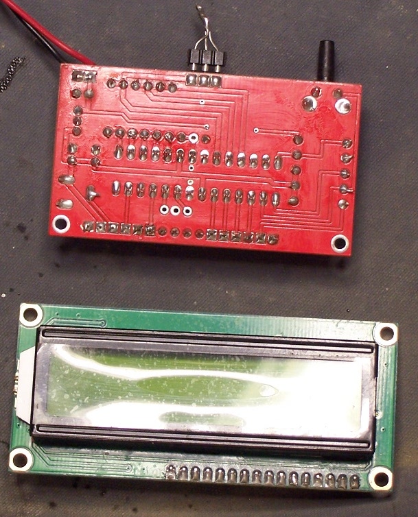

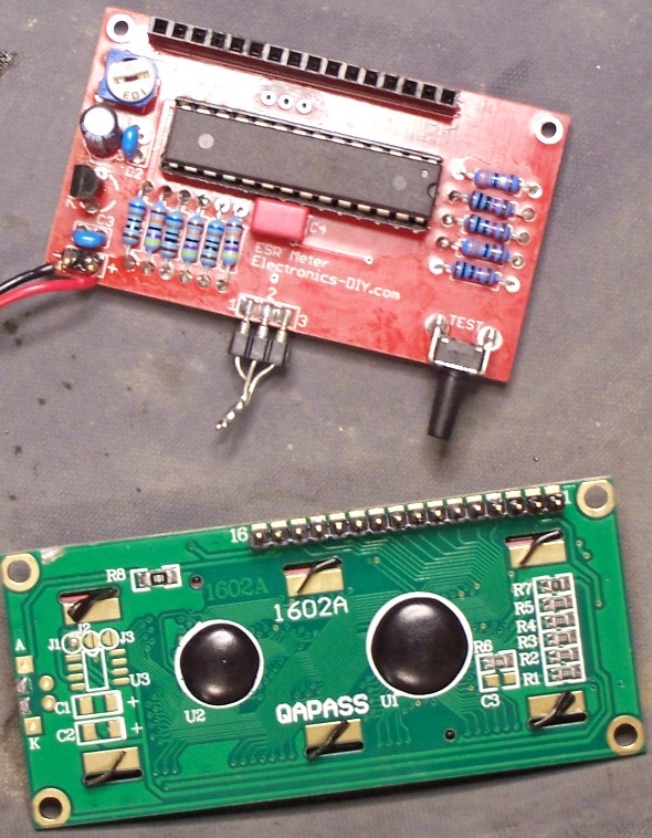

    Ok, I got the kit from a diy-type website supposedly based in New York and assembled it, pretty straight forward; except, it doesn't do anything other than light the back light on the display. I suspect that it's the Atmega 168, which is supposedly pre-programmed, but I have no idea how this thing is supposed to work, nor how to check it, hope somebody here might be able to help me out.
    It has a 78L05 which is putting out 4.97vdc, and everything is wired according to the schematic - I'm feeding it 9vdc, it's drawing 25mA. I've got emails into them (since first thing yesterday morning), not heard from them yet. I've got a Cen-Tech Dvmm, no logic probe or scope.
    Please see attachments: (can't seem to attach the schematic, guess I'll do another post)

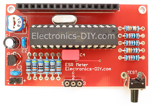

                        • R_J
                          • Jun 2012
                          • 9552
                          Re: ESR meter kit - not working
                          Why does this picture from electronics-diy and the sheet you posted in #2 show a crystal?
                          After checking I guess the Atmega328p can be used without a crystal.
                            • 31070
                            both can be used with or without a crystal.
                            BUT you need to configure that with your programmer!
                            • R_J
                              • Jun 2012
                              • 9552
                              Well I guess the one in their picture was programmed to use a crystal.
