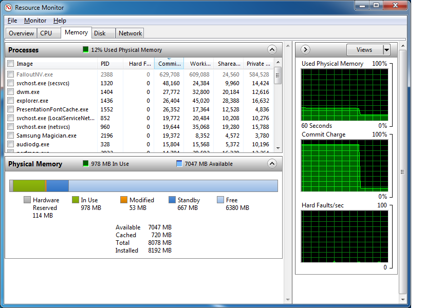

    ok, so i built this for a customer, i3-6100, MSI B150 PC mate, 8GB DDR4, 512GB Samsung 850 Pro. When I first did the major cadre of updates (post Sp1) it gave me a low memory notice. Indeed it was getting up there. Samsung Magician changed the page file paremeters since I set it to high reliability. I did then change the page file to 'system managed'
    out of sheer curiosity, the fact the intel HD 530 gave me a 6.9 gaming score, I decided to install fallout new vegas to test it. With medium settings it actually ran rather well. I was monitoring the memory and it never went above 2GB, what I didn't notice was the commit was going up further and further, until it gave me the warning, the commit was 16gb/16gb and the physical was at 2GB. Mind you at the time, I had the video memory share set to 1gb but still that leaves 7 free. New vegas does not take up that much memory. I am confused as i've never had this issue with any 2nd/3rd/4th generation core platform before (skylake is 6th gen), some only using 4gb
    anyone have any ideas?

    this is insane. It shows nv using ~500-600M, yet commit charge skyrocketing to 18GB! (you can't see that, it shows 18/18 on task manager)

        is the ssd the only drive on the system? all i can think of is to NOT set the pagefile to an ssd. it doesnt like it with all that writes. use mechanical hdd for putting the pagefile or just disable the pagefile altogether.

          I'd guess it's something to do with the page file settings maybe.
          Have a look here http://brandonlive.com/2010/02/21/me...-in-windows-7/
          Samsung might know how to make hardware but any time i've encountered their software it's been shite.

            It's the only drive. Samsung magician tries to set the pagefile pretty low when set to reliability. with new vegas it maxes out and system memory stays at about 2.x gb. Playing on my laptop it behaves fine

                            hm, the 'free' memory after a while goes down to 0, I bring firefox up and it starts increasing slowly going up to ~120M, commit stays about 1-2GB. Right now on my laptop with FF open it's 680M

                                windows 7 has one built in called the resource monitor, even shows disk i/o for each process. I still can't figure out why fallout NV took up ~600M and the swap was 18GB in size, It never showed any process using up more than that at the time. Things seem to be behaving better but i'm still not sure what the future will bring. Skyrim acted fine. Maybe it's a huge memory leak in the graphics drivers with fallout NV (FO3 crashed on load/new game)

                                        With the error in the original post, I think the devil may be in the details. Can you reproduce the error and post a screenshot?
                                        RAMMap from Sysinternals (now part of Microsoft) is a great free tool to see what's going on with the memory. There was an informative video somewhere out there, with someone demonstrating the basics of how to use the program... specifically, he mentioned that it was one of the few real ways to know if you need more RAM. Use the system for a while (I don't think RAMMap has to be active while doing this, but I could be wrong on that), stress it however you wish, then go to RAMMap and select the Priority Summary tab and select refresh from the menu (or hit F5). It will show 8 priority levels, from 0 to 7, with 7 being the most important stuff you'd never want to swap out to the page file if it can be avoided.
                                        For each priority level, it has two figures... standby and repurposed. Standby at the lowest priority levels is when a task is no longer active, but Windows keeps the data in memory if possible in case it is needed again. It's cached, in other words. Windows will attempt to fill up almost all of your memory this way-- but that's not bad. Free memory is of no benefit; why not use it for caching stuff until its needed?
                                        As soon as a task calls for more memory, Windows will purge the lowest-priority data from memory and reassign that memory to the task that called for it. If that's not enough, it will purge the second-lowest priority data from memory, etc., continuing until it has the free memory the system wishes to assign.
                                        That's what the "repurposed" category represents-- the running total of how much memory each priority level has been dumped to make room for other stuff. Priority levels 0-3 are of low importance, and if they have been repurposed a lot, that's fine... but above that starts to raise the possibility that you could use more RAM. In that case, you're not just dumping cached data (which is low priority); you're swapping out stuff the system is still using to make room for whatever program you're running.
                                        If you're hitting the top few priority levels (as I often do) with large amounts of "repurposed," that's a sure sign you need more RAM... the system is losing performance by having to swap out high priority data to make room for whatever is hogging your memory, but then it has to swap that back in to do whatever it is that high priority task is doing. If the amount of RAM is in tune with your needs, you should rarely or never swap out priority levels 5+, as I understand.
