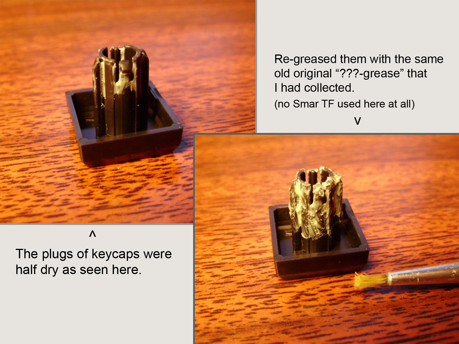

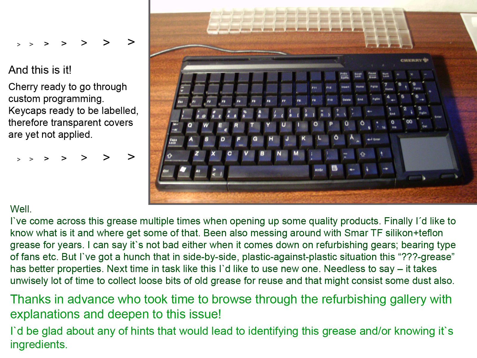

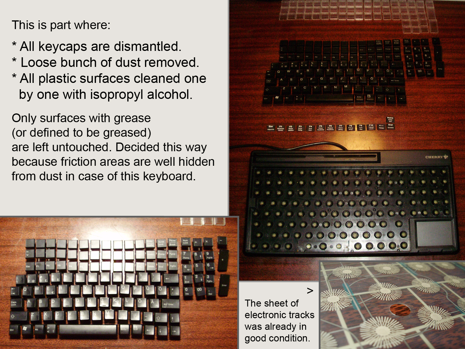

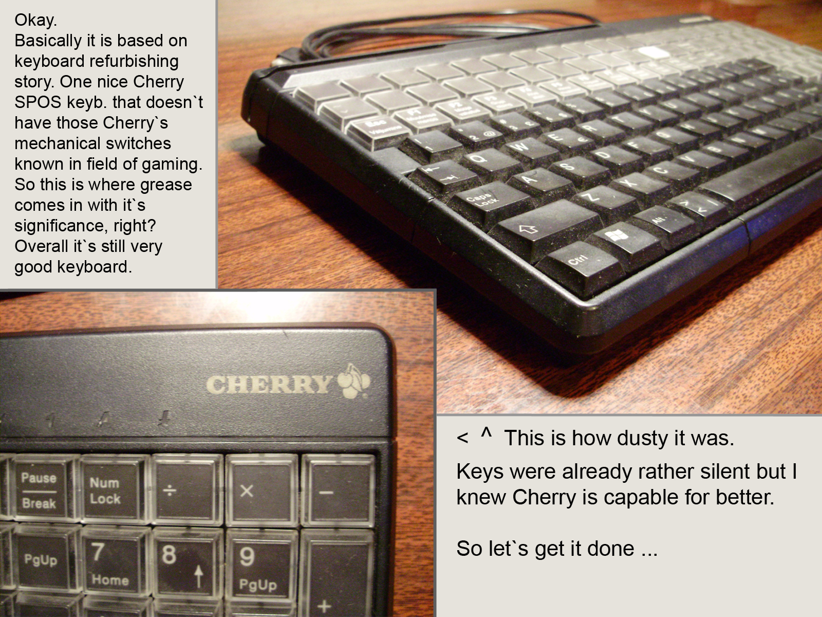

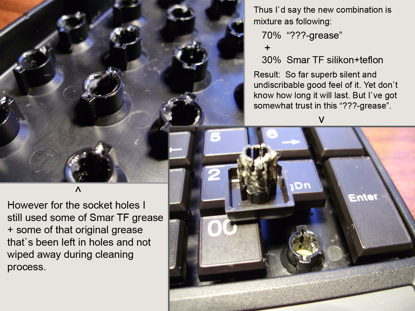

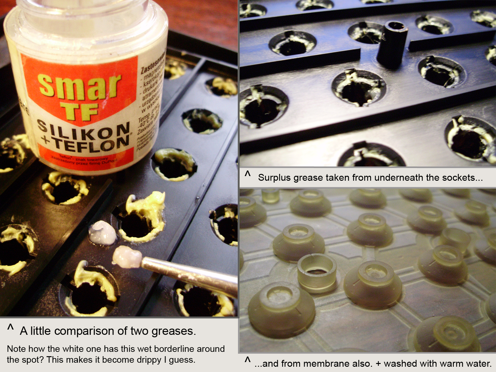

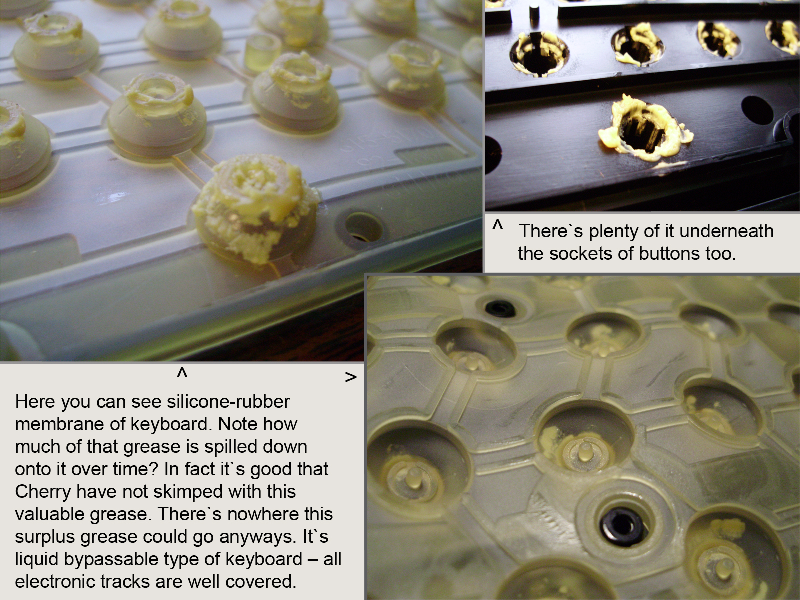

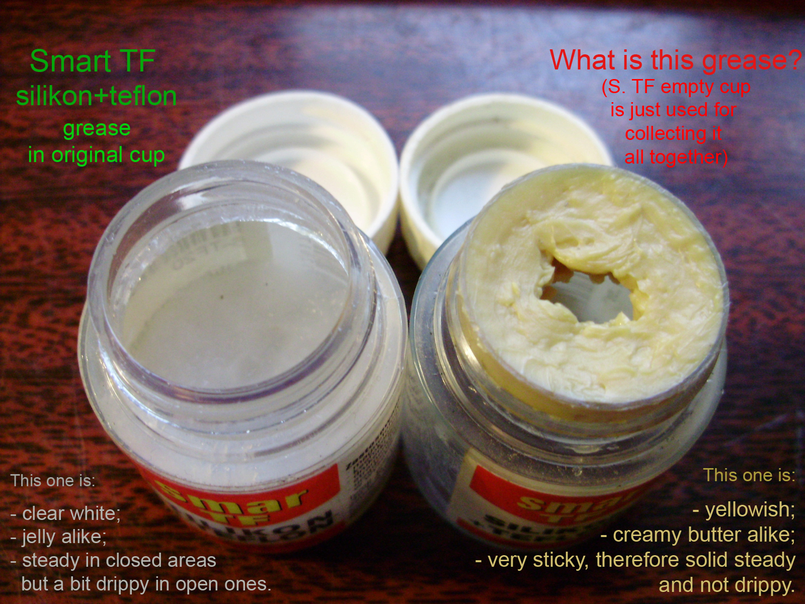

    Please help identify this grease.
    Hey.
    I hope this community has some people experienced on lubricants and greases of electronics industry.
    -Check this picture and tell if you can determine this yellowish grease in right side.
    It is widely used by quality brands in their products, where you meet plastic-against-plastic friction and/or bunch of plastic ratchets etc.

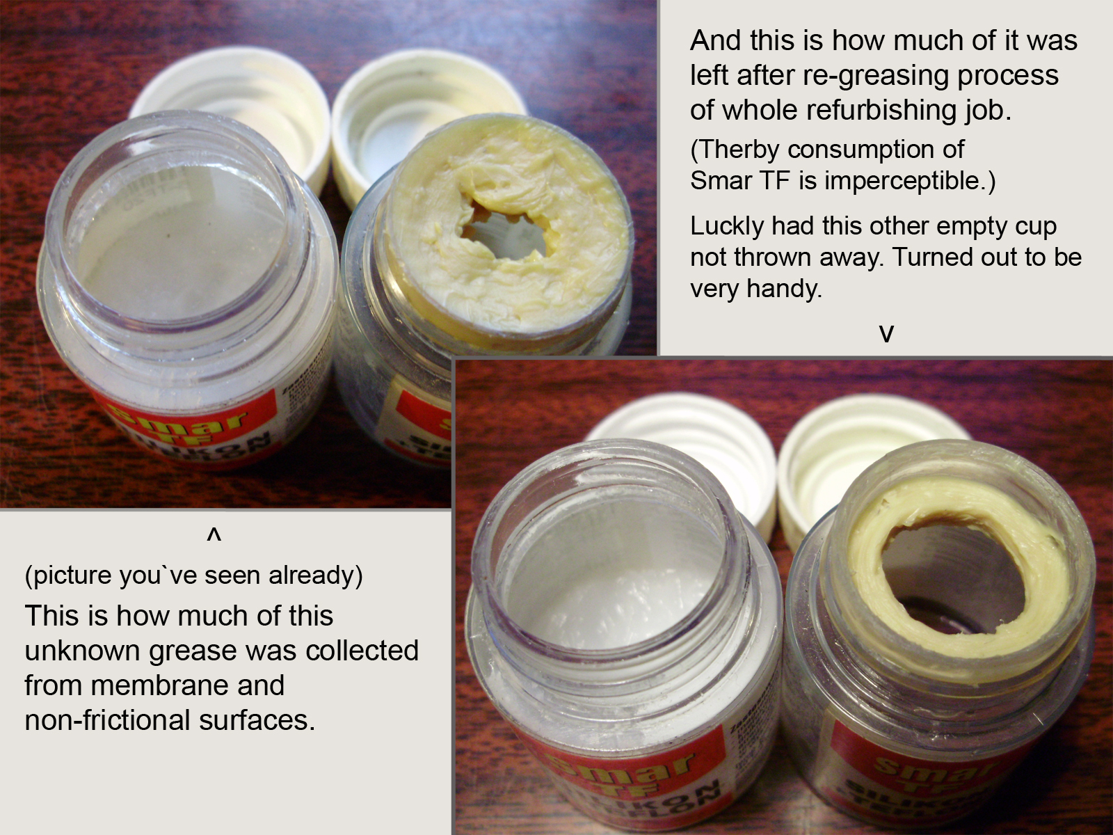

    If anyone got interested there`s a gallery below with further explanations. Overall it might help leading to solution if someone has a hunch.
    Thanks!

          Re: Please help identify this grease.
          EDIT:
          Misspelled name of white grease on main picture. Yea, it's Smar TF as repeatedly written in later context.
          Thanks for very useful link!
          Looks like I am about to start further searches towards Electrolube SPG (the one you linked) and Electrolube CG60 (even more similar) as these seem to match the most.

                              Maybe it is similar stuff, but it has been exposed to the air longer, and so it has gelled up a little, and changed color.

                                no, the light green colour was a way to identify if the right grease had been used.
                                i really wish i could remember what make it was - then i could just download a service manual to id the grease.
                                maybe it was aiwa or panasonic - i saw a lot of those.
                                it's the same stuff you often see on cd/dvd players lubing the rails for the laser assembly.
