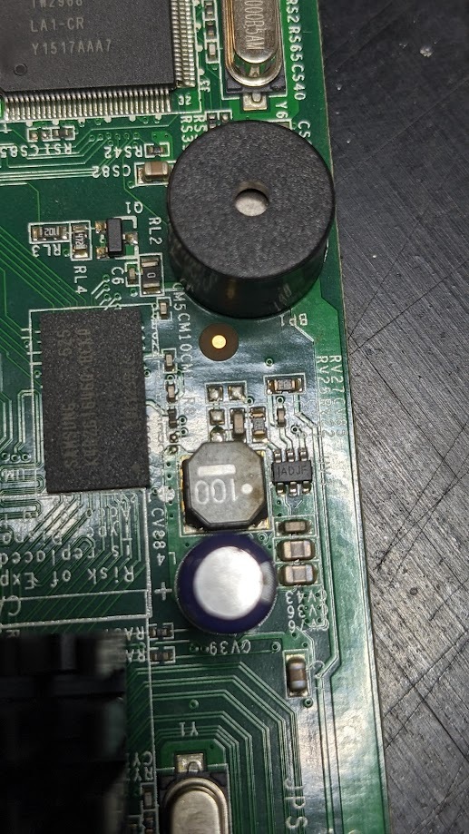

    Hy guys , i have a DVR board DS-80104 REV 2.2 that was powered wrong, i have some smds on the board that are blown and i can't identify them , maybe if someone has this board somehow and we can identify the smds', i have searched online and i can't find a schematic.

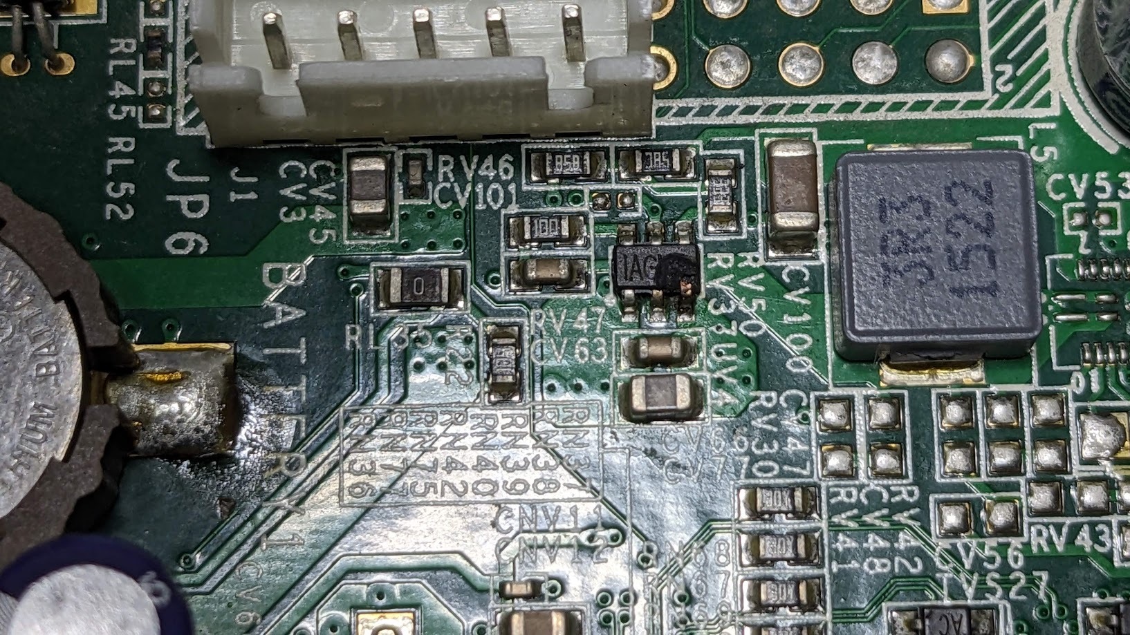

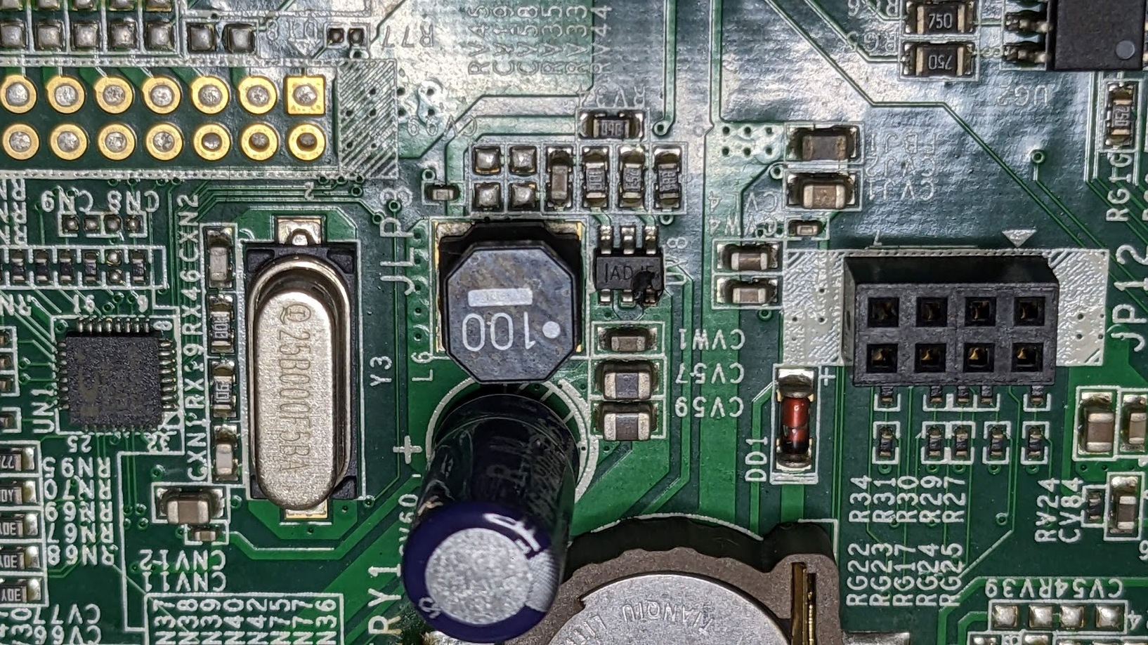

    The smds are SOT-23-6 , one of them i think it has the marking ADJF since i found another one on the board with this marking , but the other one it seems that it starts with AG or it looks like. I would really apreciate if someone could help me identify those IC's .

    ADJx - MP1470GJ
    • lotas
      • Jan 2016
      • 4708
      • Russia
      AGMx - MP1471AGJ
