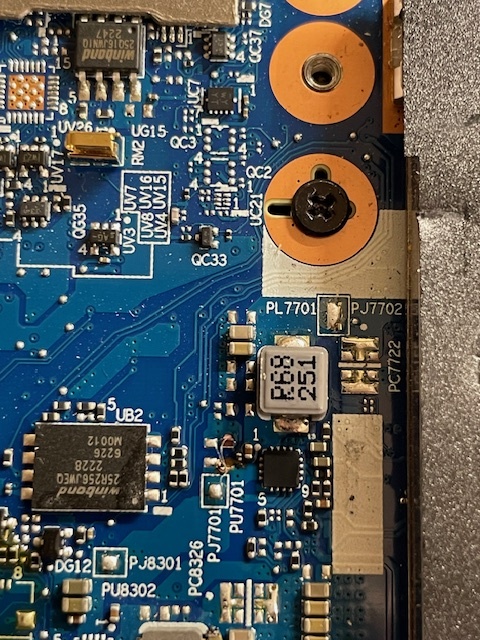

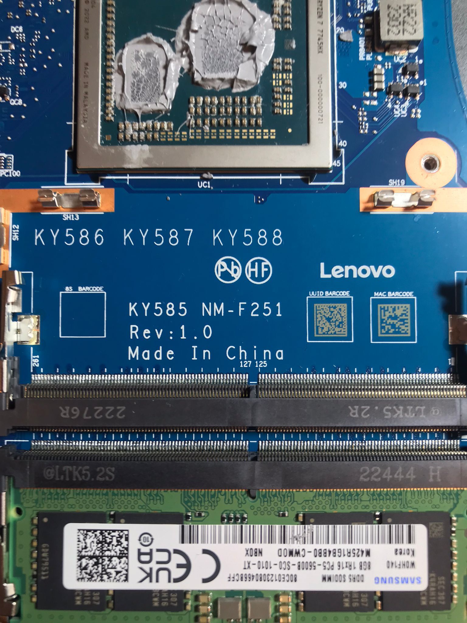

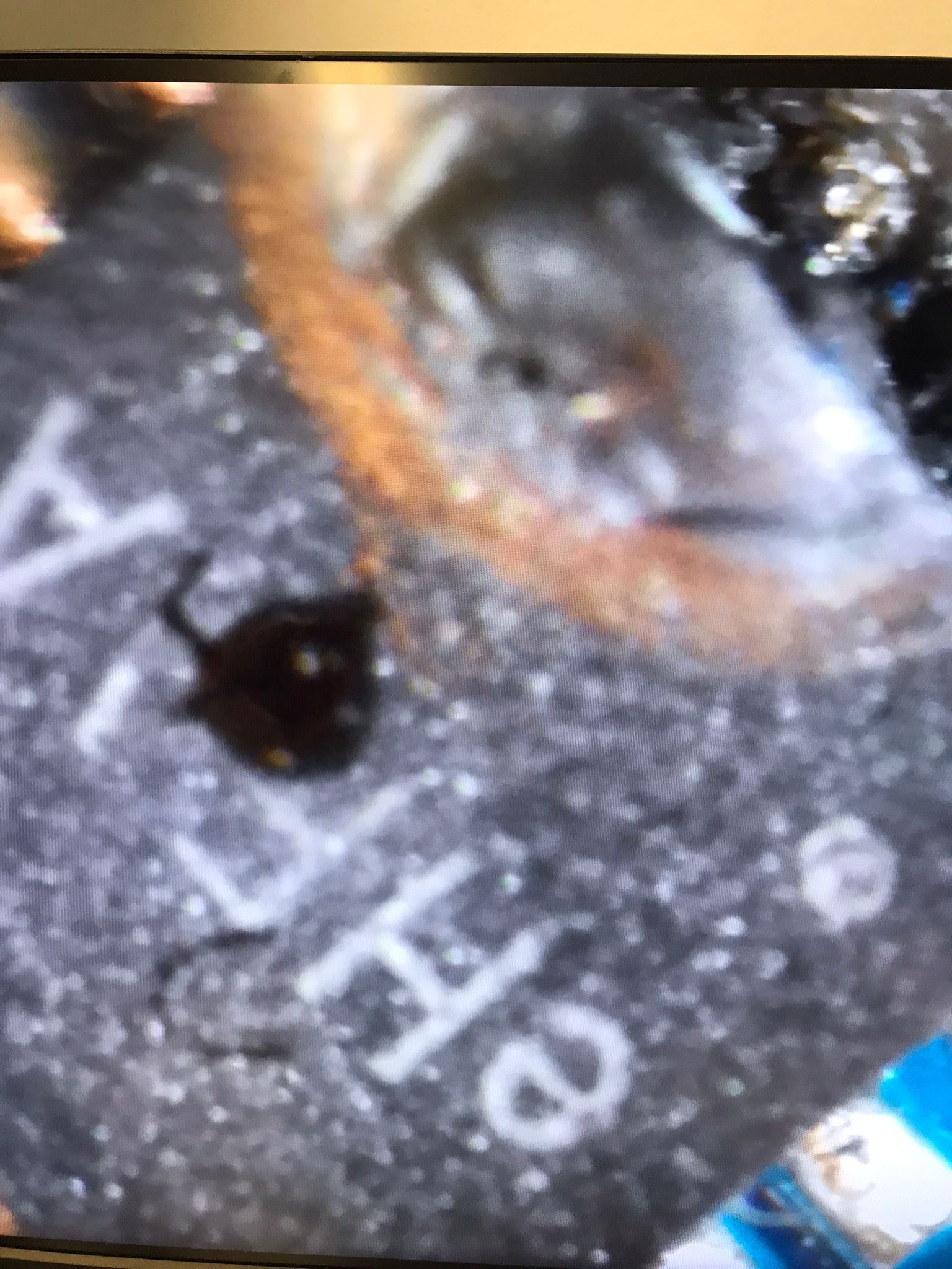

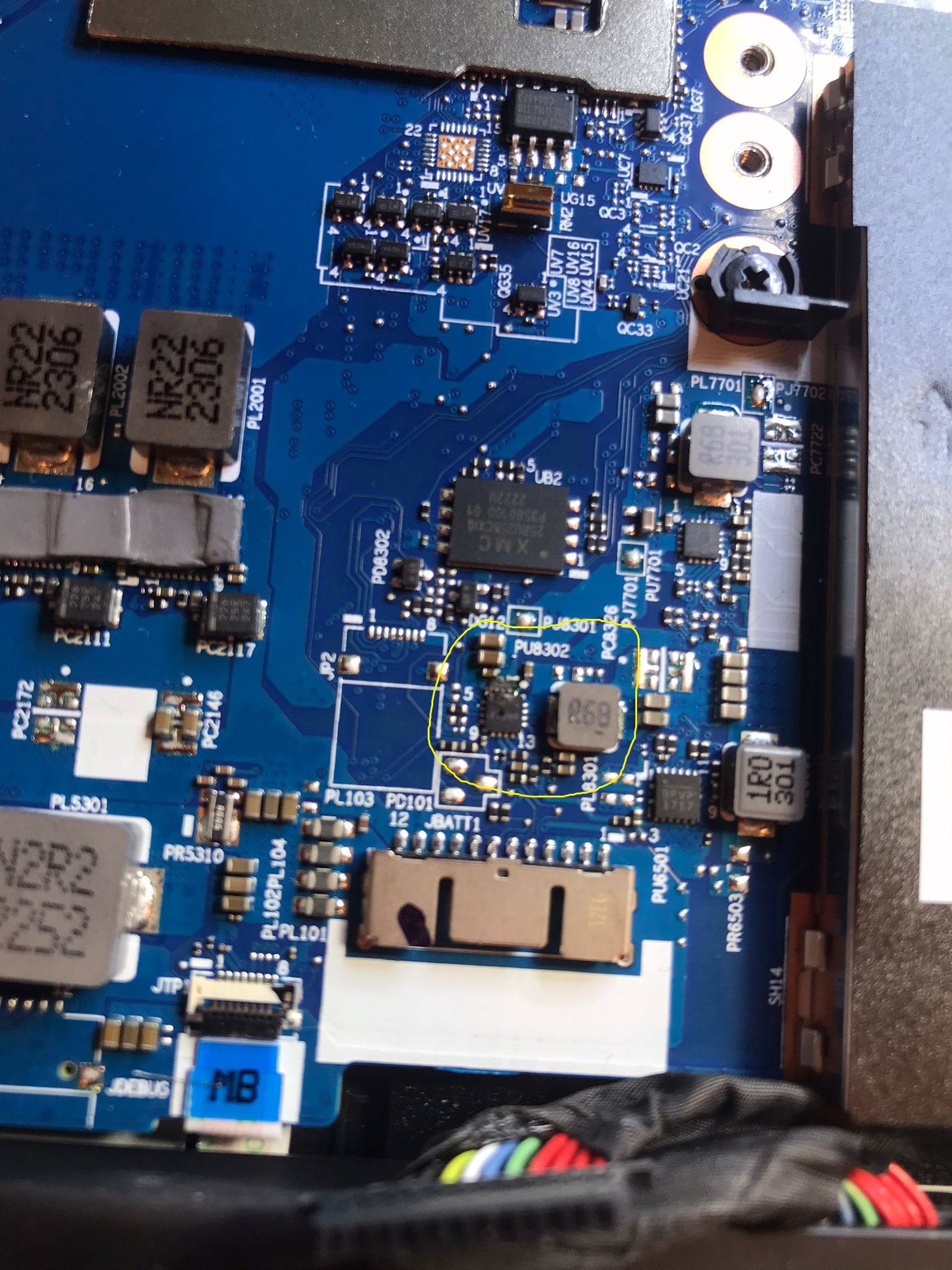

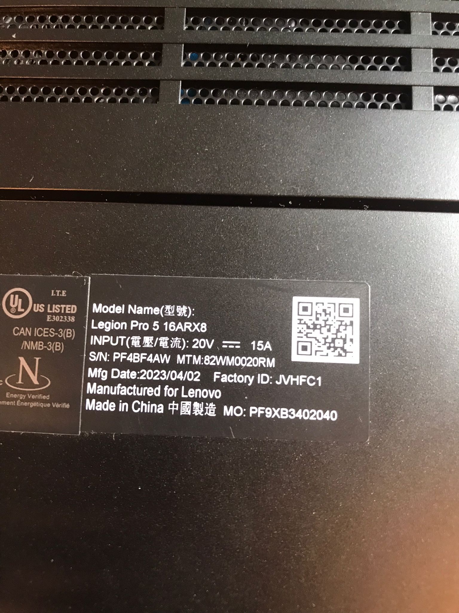

    Hello, I have a legion pro 5 16arx8 serial number pf4bf4aw mb code nm-f251 rev1.0 which was dissasembled by the client for cleaning. Now it does start but for 20 secs after that fans run at maximum and then shut down. Found PU8302 burned but cannot identify it the part. It is written eHFAA on it but didn't found any info, no boardview, nothing. Can anyone help identify the part so I can order it from somwhere? Ataching some pictures of the motherboard, serial number and part. Than\k you

    Silergy SY8386RHC - https://www.badcaps.net/forum/troubl...cs#post1793491
    https://www.badcaps.net/forum/troubl...02#post1538202

      Thank you so much. Missed that.

        Related to this board, does anyone have a part number for PU7701?

          Looking to identify PU7701 on the mainboard for a Lenovo Legion 5 pro 16ARX8. If anyone has a schematic or knows what the part value is, it would be greatly appreciated.

          • 21417
          Post a picture of it so we can see the marking code
          • gumdingo

            Here is a shot of the board. Hopefully this helps.

              • 21417
              Nope, can`t see a thing marked on top of it, you must have eagle eyes if you can see it.
              • gumdingo
                • Mar 2025
                • 5
                Yea. It popped. I was able to clean it up but there was nothing recognizable to get a part number from unfortunately.

                  PU7701 eHF
                    • 21417
                    Originally posted by Rezistor
                    PU7701 eHF
                    eH*** SY8386RHC

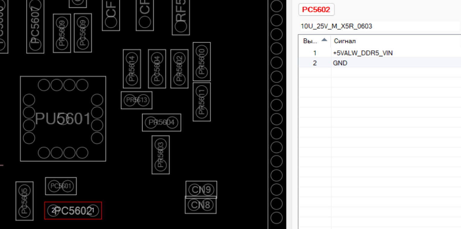

                      Hello.
                      Boardview recently appeared on some paid sites
                      Unfortunately, I don't have enough points to download and share.
                      I would appreciate if someone shared it.

                        Lenovo Legion Pro 5 16ARX8_LCFC_KY585_KY586_KY587_KY588_NM_F251
                        Drag and drope in BoardViewer 2.1.0.8
