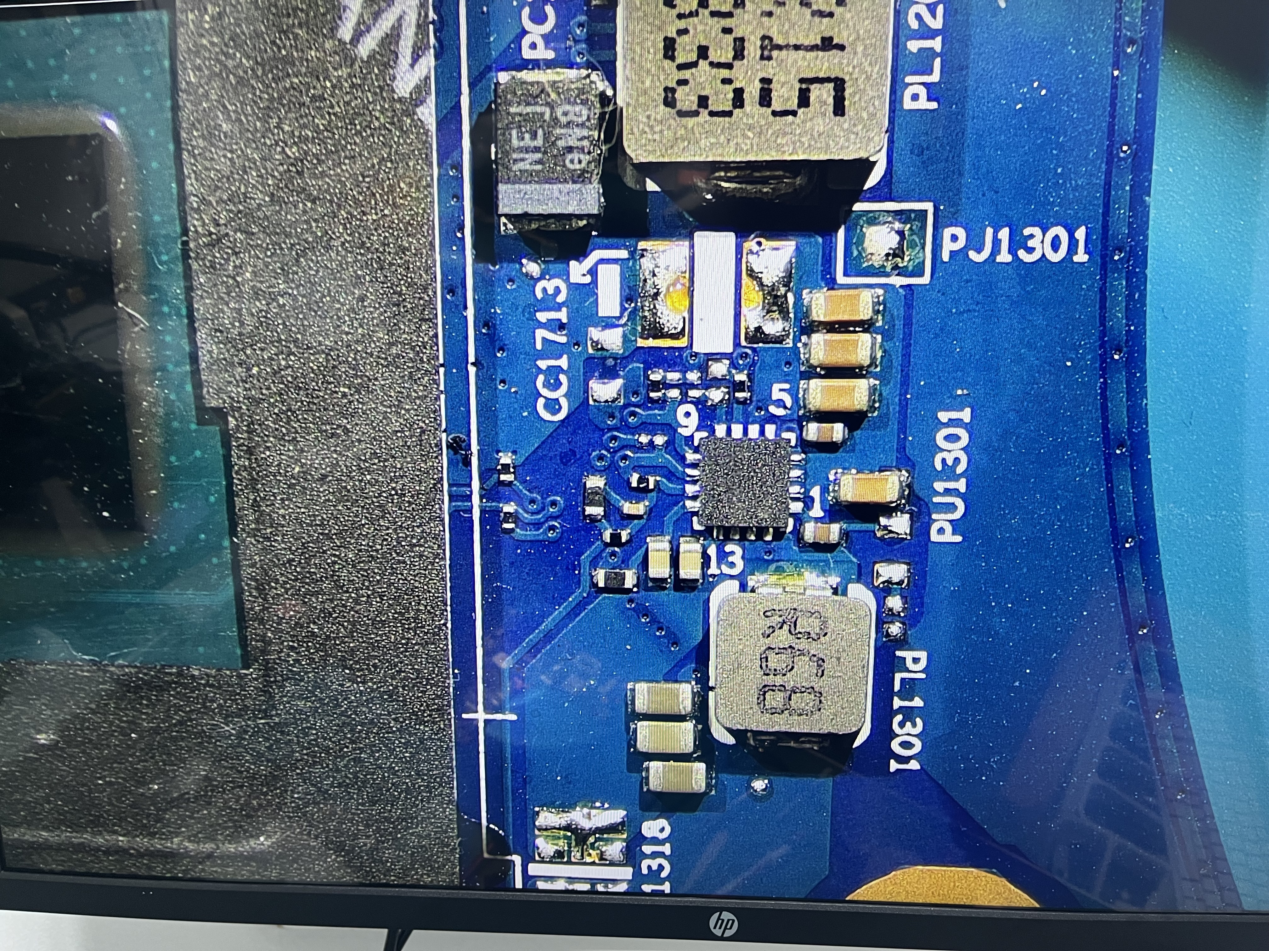

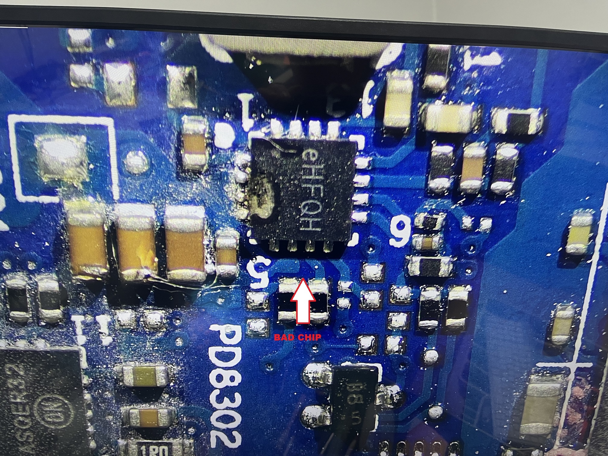

    Hi gang, its a long shot, but working on Lenovo Legion Pro 7 motherboard NM-F091, and trying to identify this component near GPU with marking "eHFQH" that is burned and shorting the board. Looks like power management IC
    I couldnt find any schematic or boardview. The CPU side also has same chip. Any way to identify this chip? or take measurements from the good chip to determine what it is?
    Any help would be appreciated

    https://www.badcaps.net/forum/troubl...12#post1538202
    Silergy
    eH*** SY8386RHC
    Datasheet attached

      Thank you!! ChatGPT pointed to the same IC..now to find this part in the US!
