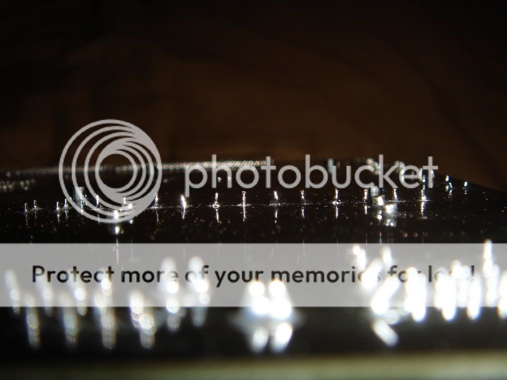

    Hello Everyone,
    I have a Gigabyte GA-8IG1000-G Motherboard that came out of RMA not that long ago. Before I installed it back into my PC, I could see something that looked quite bad.
    There are a bunch of traces that lead to the CPU that have some damage to them??
    The traces were originally a blue colour because my PCB is blue. Now the traces that have been scratched across have turned a whitish colour. I'm just wondering if thats the top layer of PCB colouring gone or have the traces been permanently damaged??
    The board still works well with no stability issues. In fact i'm posting on that PC now.
    I took some photos, but the flash is preventing the traces from being seen.... I don't know any way to get around this. Putting the flash off on the digital camera will cause the image to blur. I have no idea of getting around this.
    Thanks.

    maybe it's just glue?

      I'm thinking it may be merely a scratched clear coating which is placed over PCB's to protect them from corrosion, that would give an opaque appearance
      BTW doesn't your digital camer have a macro setting? I use this plus the zoom feature combined with natural light for all my shots (still perfecting my technique)

        I checked again, it definitely isnt a clear coating, it's a deep graze type of thing. I can feel it as my fingers go across it. It isn't very deep, but it's there.
        I use a Sony DSC-T5 digital camera.... those very small flat looking ones. I have macro on, but without flash, the whole thing blurs out.
        I don't think there is any way I can adjust this camera in any other way since it is an automatic.
