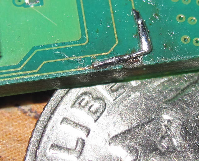

    Well I need to repair a trace... ... on a DIMM.
    These tracks are tiny! What, hair line traces?
    Fortunately the track is fairly long, maybe 1cm, and fortunately 1mm away from the next trace. Now I need to remove the soldermask. However this trace must be thin from top to substrate as well, how could I guarantee mechanical scraping wont abrade the track? What would one use to scrape off the soldermask for these hairline traces?
    I guess the next thing after removing the solder mask is that the track needs to be jumpered. 30AWG Kynar wire is huge compared to this track...

    I use a scalpel blade, 0.1mm jumper wire and a stereo microscope.

      Re: repairing traces...on a fine pitch board?
      Scalpel blade... no check
      $1 CCC Xacto knife... check
      0.1mm jumper wire... no check
      30 AWG wire... check
      Stereo microscope... no check
      1.4x magnifier light... check
      All ready to fail! *sigh*
        Consider another approach:
        don´t fix the trace... just wire end to end.
          Unfortunately the ends are pads under BGA components...
            rossman has fixed that a few times on video - he uses very fine wire and puts a loop on the end to hold the bga ball
              You may find some thin wire to use in some like phone earpiece, vibramotor.
              As for visual,you may try some camera on phone or tablets with some attached lens.Need to experiment a little.
                Well, I guess the BGA doesn't matter, the break is nowhere near the BGA...
                Need to think of a better source of wire that's not coated with varnish...or oxidation for that matter.
                  i just strip some stranded copper wire for such work
                  usually from an old pc psu!
                      Triumphant(for now!) Used 30AWG wire and cheap crap orange flux that I had lying around...
                      DDR2-5333 DIMM module seems to work once more at least at DDR2-3200 speeds...
                        It sticks!
                        That's a 30AWG underneath that blob, and a 10¢ piece under the board.
                        Fortunately the tracks were relatively far apart, and only one track.
                          Now whether or not I dab some CA or epoxy over it to protect it...
                          It sticks!
                          Great
                          (although i would have gone with a thinner wire)
