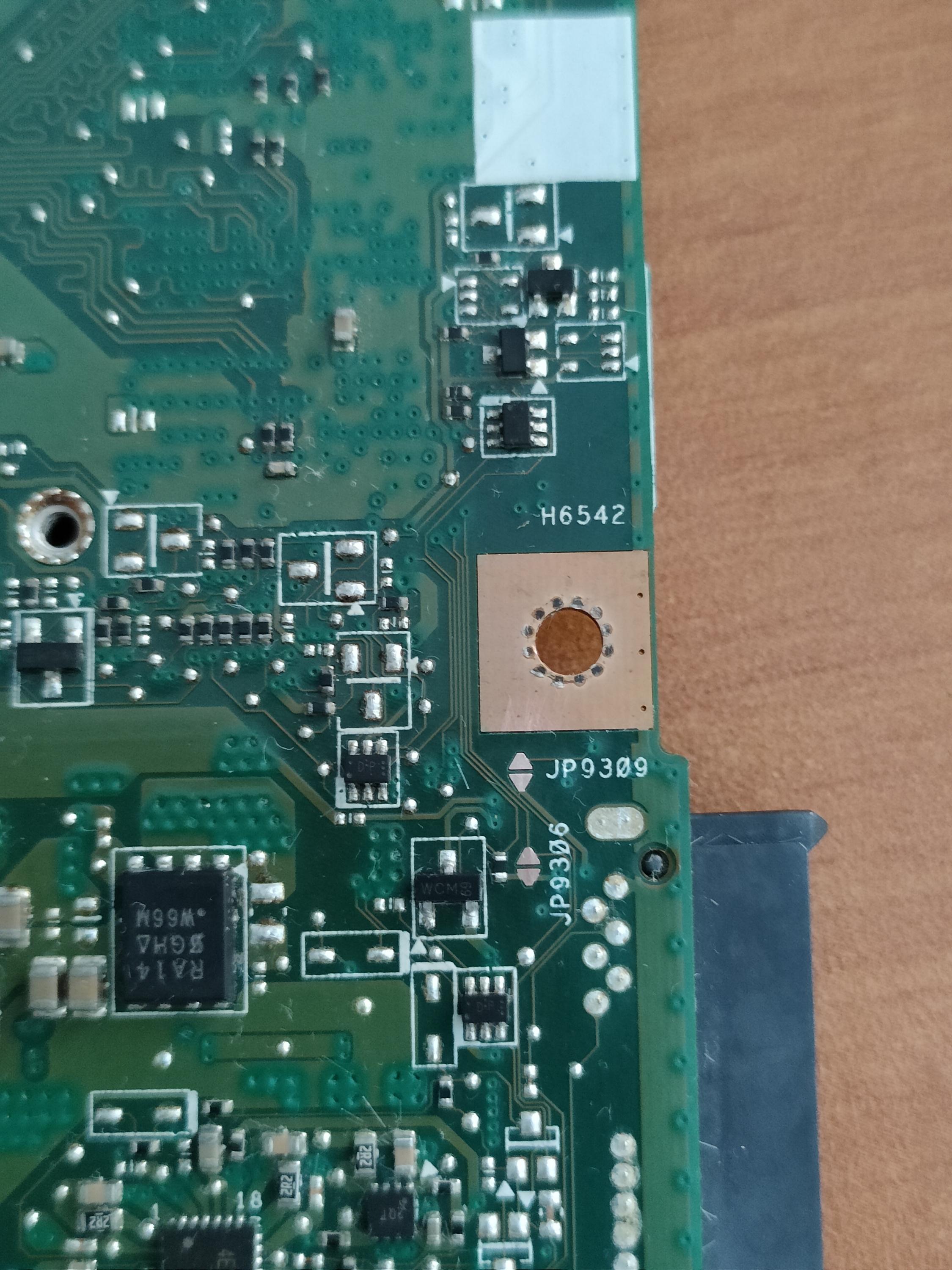

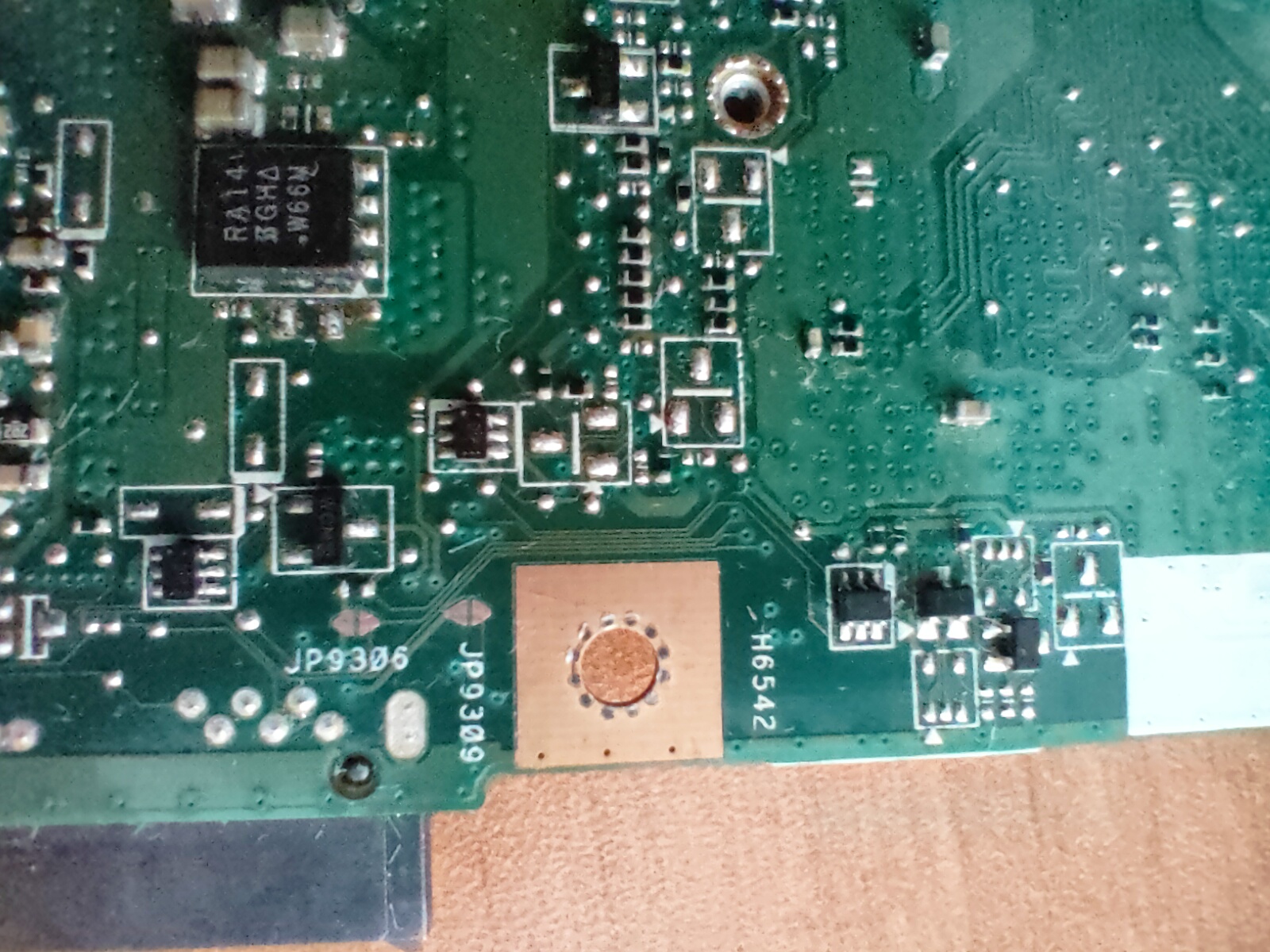

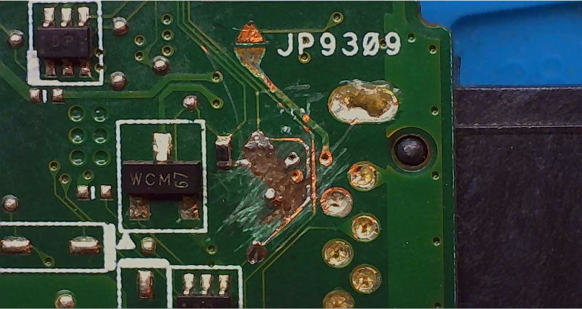

    Dear All.
    My GL553VW motherboard shuts down durring windows boot.
    I have narrowed it down to an area where NDVVS_PWROK signal traces are handled barbaric way before.
    To restore the original pathes I need a good picture of the area to figure out where Point 3 and Point 4 are going and are they connected?
    Problematic area is around JP9306
    Made a picture where I have the problem. (sorry about the bad image quality)
  • Sephir0th
    • Oct 2020
    • 1282
    Re: GL553VW pictures need to restore traces
    Just a shot into the blue but you could try to use GL553VD boardview. The boards should be very similar iirc. Try and report pls.
      Boardview does not shows these 2 point thats why i ask.

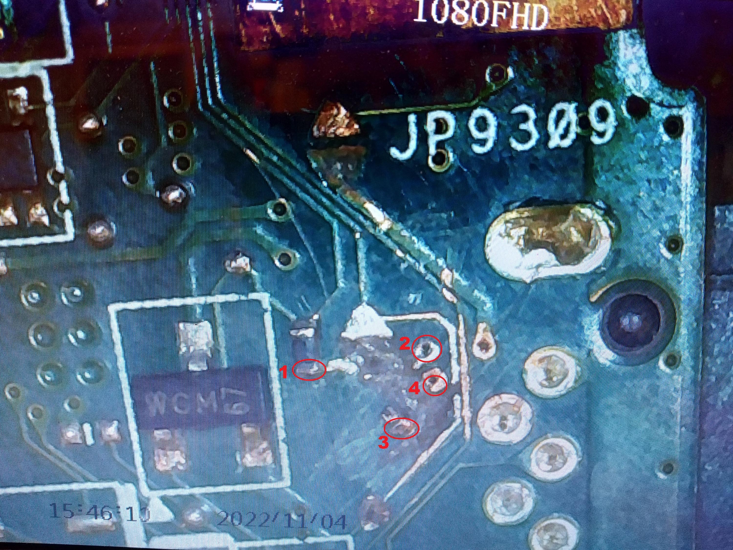

        Here is a better quality picture
        Point #4 is ground.
          Turned out that Point #3 is "+3VS VGA"
          It should connect to the other side of board to T9125,
          and also to "R7485 pin #2" where it does NOT.
          So I'm guessing that someone cut that layer line while messing around.
          I think my best solution is that I make a jump wire from T9125 to "R7485 pin #2"
          Anyone has different idea?
            Restored all the pathes.
            Notebook turns on and can go to BIOS.
                          I have two boards of these.
                          picture attached.
                          Regarding the CPU power lanes, there might be a defective mosfet. Measure resistance/diode reading across all the pins (G,D,S) and compare to the next one. Maybe it helps to remove them from the board.
                          If you have a thermal camera, sometimes it's also useful to spot some component hotter than it should be.
                          BTW, these mosfets tend to kill CPUs. The two boards I have, have a dead CPU, killed by a shorted mosfet that injected 19V directly to the CPU
