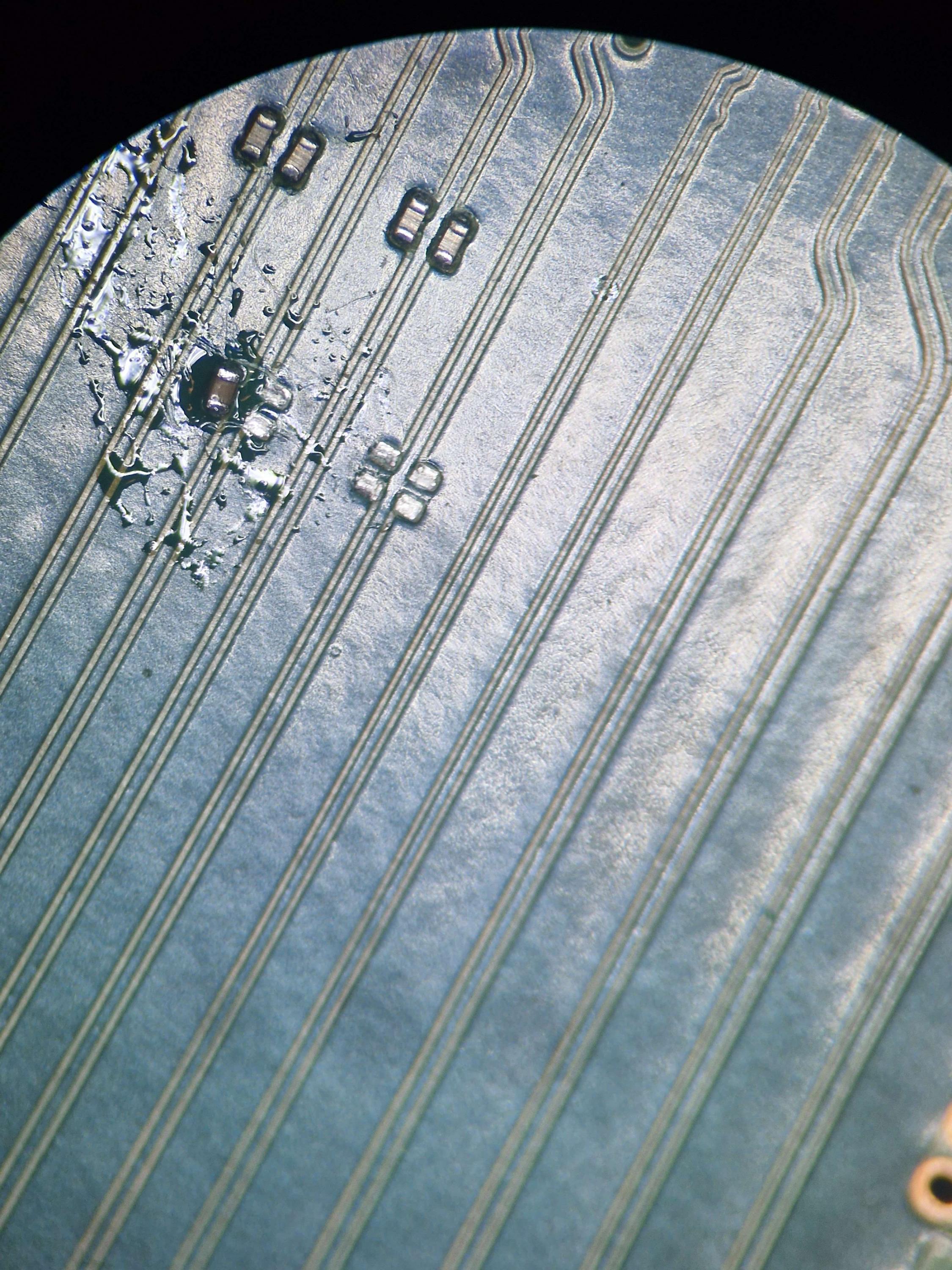

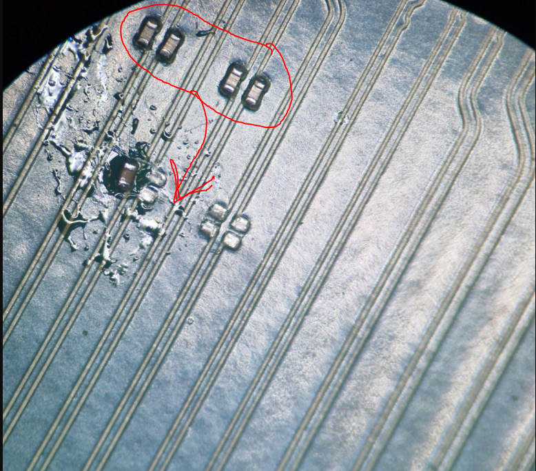

    Hey,
    Got a ps5 here no display, either white light or plusing blue. no display in safemode.
    but there are missing caps after the encoder on the traces to the apu
    there was one i was able to find half attatched and got it back on,
    what would i replace these with?
    is there any compatible ones i could nab off a ps4?

    There are not ordinary blocking capacitors here, but low-capacity signal ones, which measure their capacitance above and the same should be put on the missing ones.
