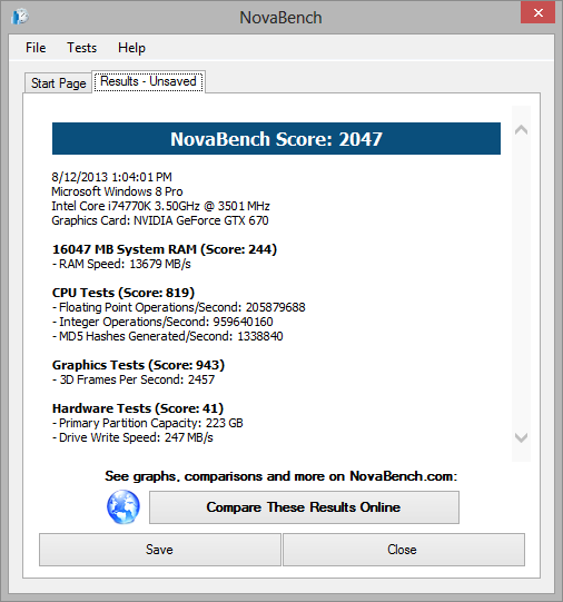

    Originally posted by Topcat
    Those novabench results were not on the opteron system, they are the results of my current office machine, which is a dual quadcore xeon. I never did novabench the opti box before I dismantled it....I guess I should have.
    Umm...
    Topcat did a Novabench run on his current setup awhile back:
    Too bad it wasn't the previous system, as it used the same board and all.
    I know dude, I know.
