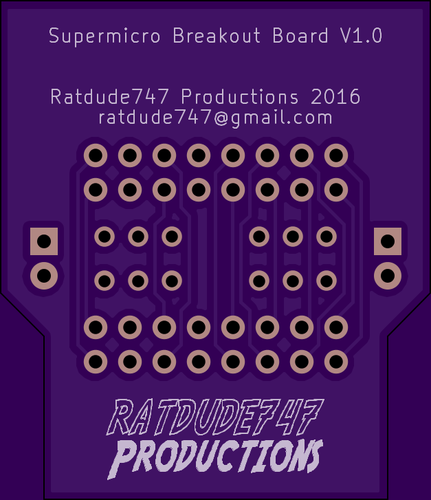

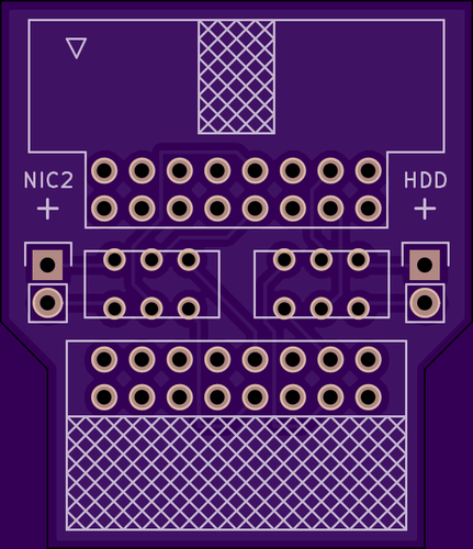

                                  2. For another build I designed a breakout PCB to allow the use of Supermicro LED/switch ribbon cables with RAID cards. While the two I have are fine and dandy (of which I owe Topcat one), I'm redesigning it for this potential V5 build which I suspect would involve a SM board (as I don't like using thier breakout cables when the ribbon matches the board otherwise).
                                  Mainly it will use two DPDT slide switches instead of four jumpers and will be sent to OSH park as a dual-sided PCB with silkscreens instead of a single sided milled PCB. Topcat, I will make you a new one and you'll get that instead (OSH park boards are made in sets of 3, so I'll be making three total).

                                    #217
                                    Re: Ratdude's Main rig V3.5
                                    New board design complete.
                                    https://oshpark.com/shared_projects/zszsAHZa
                                    The boards are on order...
                                    I made everything but the 2 pin headers from scratch... as the existing footprints in the latest Kicad don;t work for this. Besides, doing this ensures that the parts will fit correctly.
                                    Look nice?
