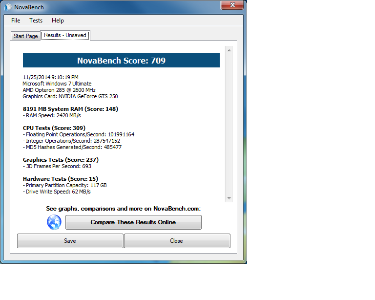

        Updates:
        -The bios WAS indeed being gay... as I did NOT have the latest BIOS... in fact, the latest one addressed an issue with code 12's and the 8800... which the 250 GTS is essentially the same thing (OC'd and die shrunk a few times, same G92 core). I was able to SLIC it successfully too... and the GPUs work. Yay!
        -Recap was successful...
        -One of the HDD's decided to be a prick and bomb a SATA connector (same one as before... I was able to kludge it into working again but pending what that pin actually does, I may be looking for either another WD 740 or a set of 4 newer drives (I have a SATA II capable card now )
        here's a benchmark with the new GPU's (SLI enabled) and new RAID card:
        compared to the previous:

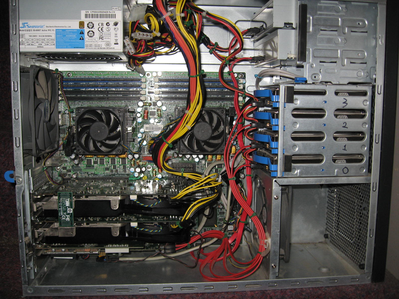

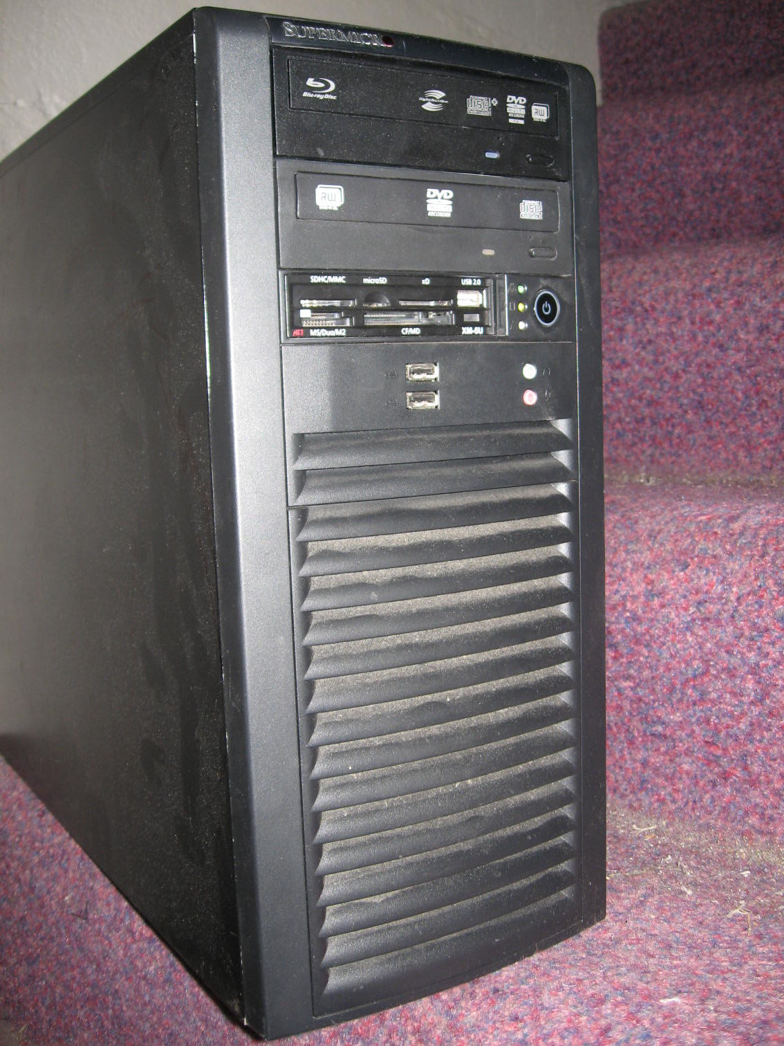

                  The "upgraded" SLI bridge came in... so I did some cable management and decided to take a fresh batch of pics:
                  Yes, I'm using my basement stairs as a showroom... and yes the intake is dusty; it doesn't stay clean for long, I got rid of the worst of the bunnies awhile back.
                  The current set of Removable drives:
                  Complete with a BD-ROM that's been crossflashed (it had some BS HP firmware, it's actually an LG with a less-blingy bezel). See previous posts for why I had to flash it; in short it wasn't agreeing with the nforce SATA controller but the LG firmware does.
                  The back of the unit:
                  ...as no photo shoot is complete without a butt shot!

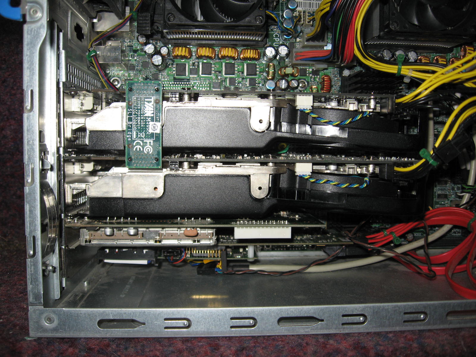

                  Actually, one can see that all but one of the slots is occupied. That one isn't used by my mobo and a lot of SM cases don't even have it as a fillable position since most server/workstation boards have so much onboard fun crammed in that there simply isn't board/trace routing space for the uppermost slot to even exist. Mine had a spot for a slot but it wasn't populated (some oddball slot, not PCI,PCI-X, or PCIe).
                  Some guts:
                  As before, red sata cables everywhere, 6 in total. The main change from last time is the cards:
                  Which includes two beefier GPUs (more in a sec), the ATSC/QAM card from last time, and an upgraded AMCC (Aka LSI aka 3ware) 9550SX-4LP. Unlike the previous 9500s, which ran at 66MHz, this bad boy runs the full 133MHz, hence the moved slot positions. In addition to presumably more Cache and SMART support, I also get a 10-12MB/s data rate increase. Puts my 9500s to shame.

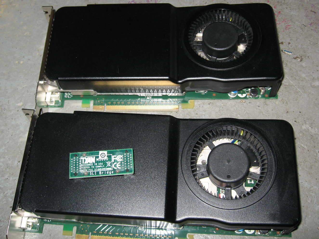

                  The upgraded GPUs:
                  These are a pair of Geforce 250 GTS's that were sold to me as 9800 GT's... IIRC it was like $23 a pop, these being NOS. Normally I wouldn't have done such beefy 2-slot cards; these were designed to be run that close (as they can be triple SLI'd) which is evident by the angled fans and the notch in the plastic housing (breathing space). Not too noisy either (hard to say if they or the CPU coolers are louder at idle, even under load they don't ramp up much).
                  What's cool (and fortunate) is that the 250 is a rebadged 9800 GTS+ which in turn is a die shrunk and slightly overclocked 8800GTS... Sounds lame... but considering that the final BIOS update addressed an issue with 8800's Code 12ing (sound familiar?), this more or less makes this the most recent card to be known to work on the platform... although I could see even newer cards perhaps working. I do know that it runs well...
                  After determining that I did not in fact have FB DIMMs but just plain unbuffered ECC ones, my PSU is just barely enough to power everything (the suggested was 608W, I have a 600W, with 550W calculated being used).
                  Also, having the right SLI bridge is nice... I didn't like having a folded up flexible bridge; this one fits perfectly.
                  Nice Build?

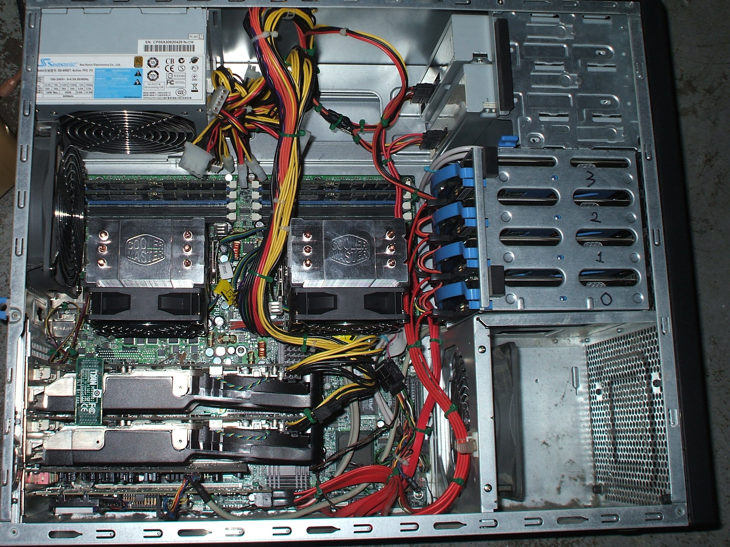

                                I swapped the coolers awhile back, and finalized the setup last night:
                                Those are Cooler Master TX3's with added fan grilles.
                                Before I was running them turned 90 degrees with the front cooler's fan moved to the back and flipped as I didn't have enough HDD clearance with the fan in the front. While it did cool OK, it looked funny and I wasn't happy with the result. This I think works well as the fans are still blowing in the correct direction. They only run at 1600RPM and are very quiet (the only fan at all audible is from the GPUs).
                                sigpic
