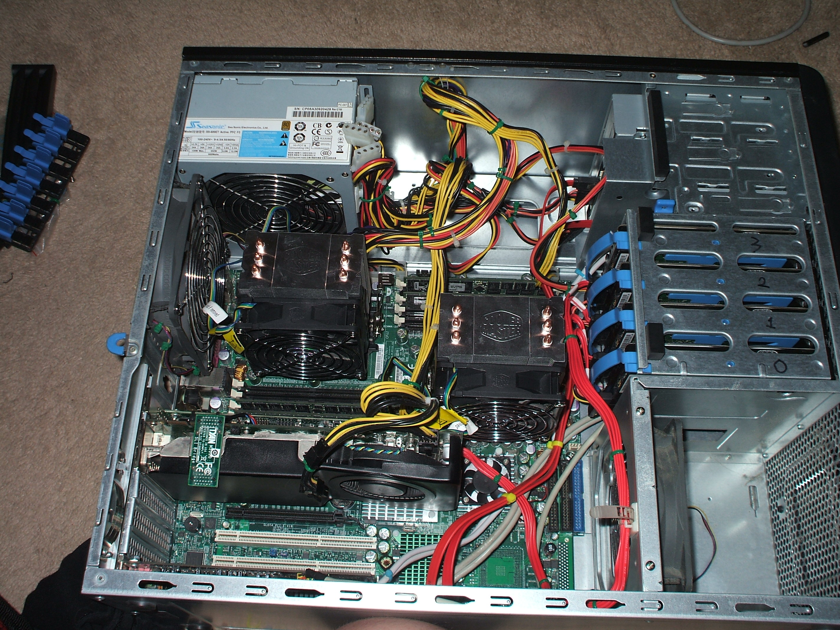

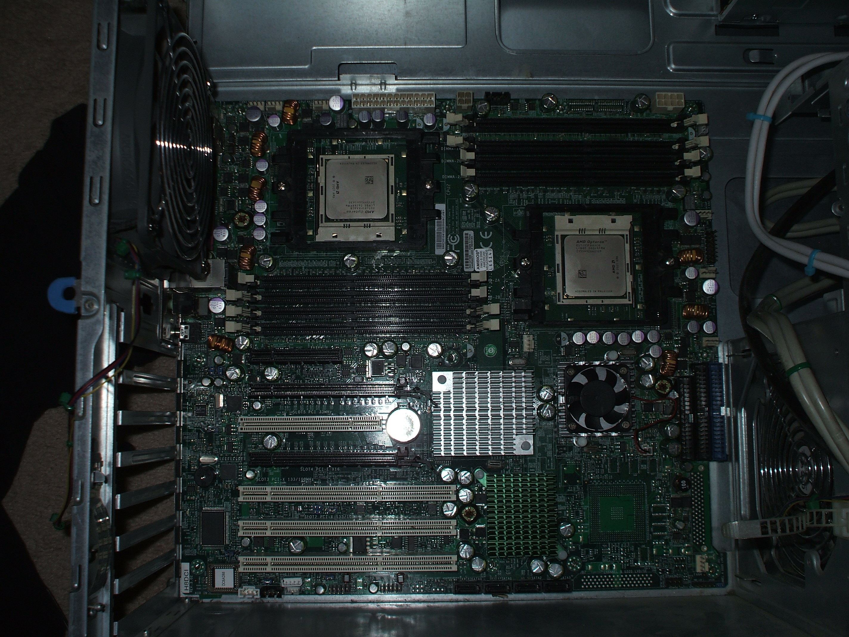

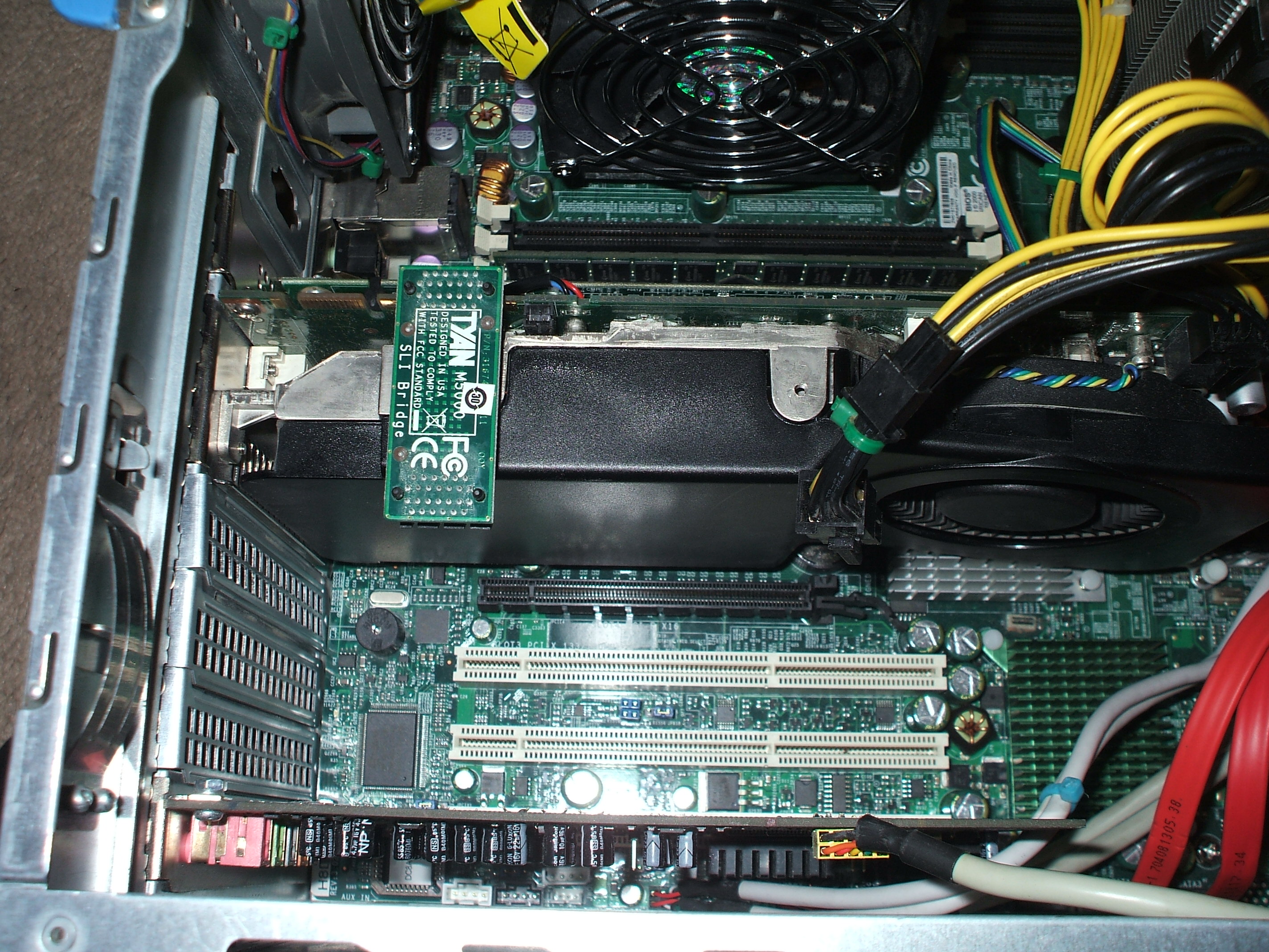

      Mobo came in. Picture time!

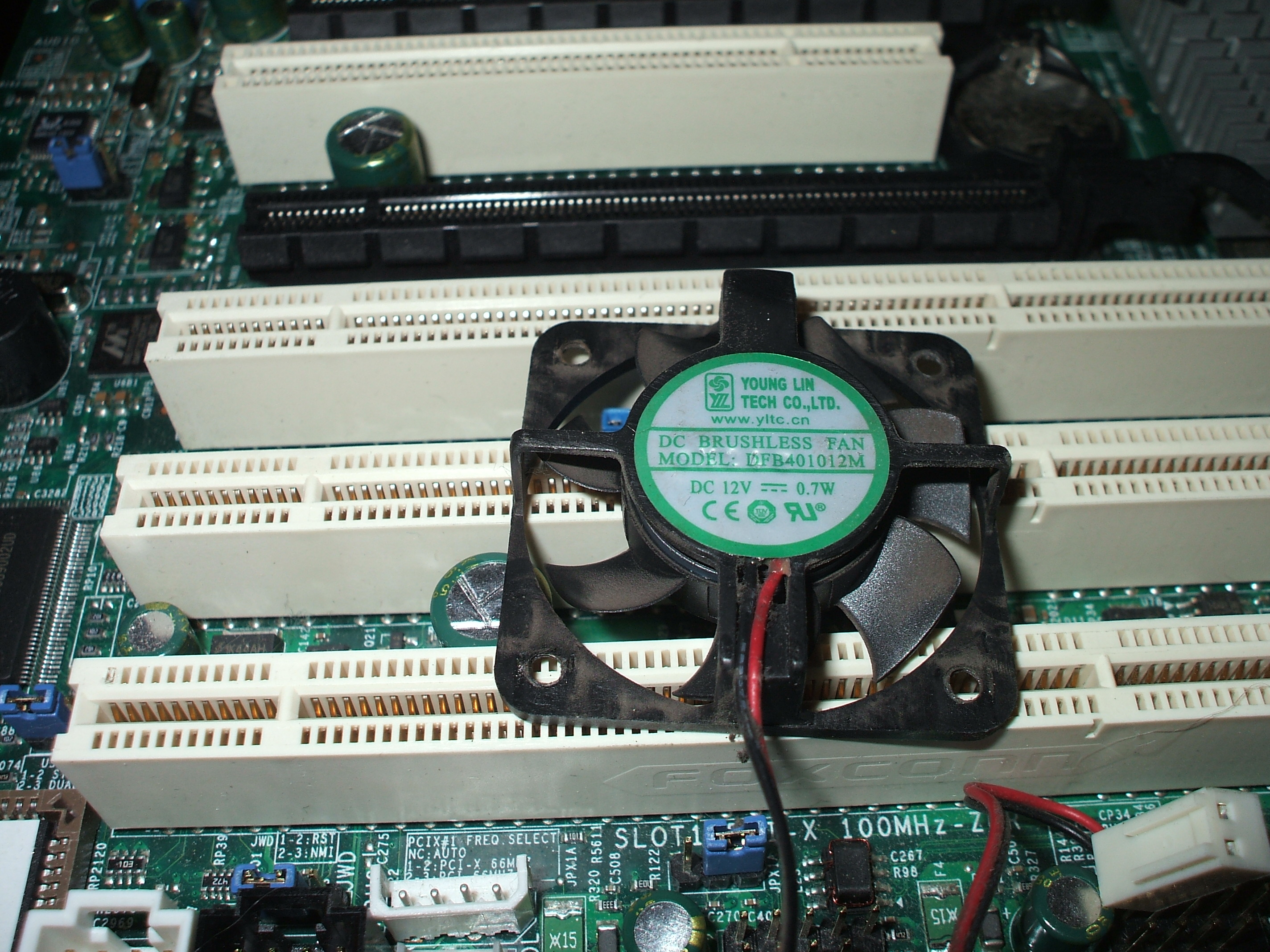

      First, one thing I DON'T like about this board is the fan cooled northbridge. That fan was a bit noisy. Luckily, a drop of ATF (Type F, I use it in 3 speed bike hubs and for bike chains too) squelched the rattle (it's a dual ball bearing fan). Here's the model number for future reference (if I need to replace it):

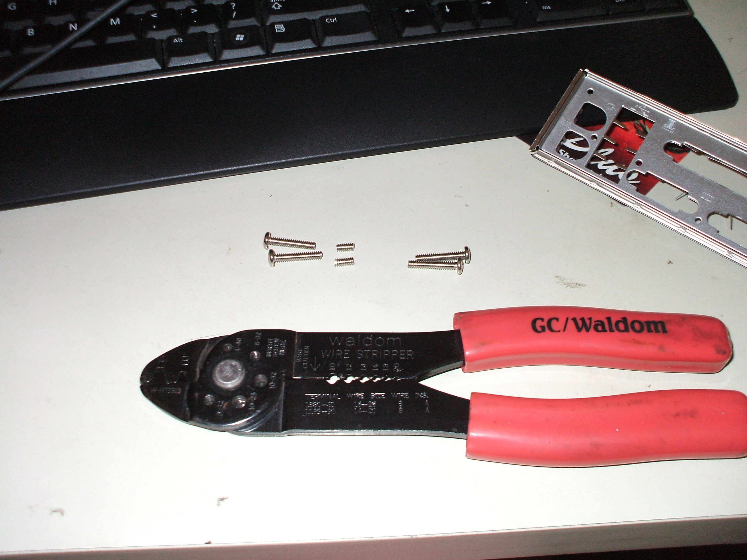

      Another pain in the ass was the retainer screws for the fan brackets. The original dynatrons screwed to the backplates directly. They're also non-PWM jet turbines (this board seems to have been a former server board... ), so they aren't getting reused. The issue is that 2 of the 4 screws (939/940 use 2 per socket) are too long and while the old backplates on the K8WE would allow for that, the new ones don't (and the backplates are well adhered... they ain't coming off safely). Nothing that a screw cutter won't fix though:
      With those issues fixed, I was able to drop in the board (along with some 85W 2.6GHz Opteron X2 285's):
      Everything I have installed:
      Memento from the old board:
      (as I doubt I could get a SM one if I wanted to... it's a farking SLI bridge, so what?)
      I haven't thrown in one of my breakout boards yet, as my two not in use are currently at work as desk decorations. I need to remember to bring them home and toss one in.
      The good news: after a CMOS clearing (password locked into server fan mode) and a BIOS update she runs great. Very quiet and cool running. Also decently snappy.
      The bad news: SLIC isn't possible. Or rather, I can't get a modded BIOS to work. Before some of you start cheering (and bashing), no, I didn't brick it. Instead, I tried SSV, SSV2, and SSV3 AMI slic methods and all three for some reason blocked my RAID card from being recognized by the 3ware driver (no shit ). Dynamic was of no use as obviously SM didn't have any SLIC in it from the factory.
      I tried DAZ loader but after checking decline to 5 bits of shitware and seeing all sorts of shitware fire up during the install, I abandoned ship. My new plan will be to fetch the 7 pro key off my dead latitude E5530, as I don't want to linux-only this one (various reasons, based off personal experience). I'm also out of my 4 windows 7 Ultimate Upgrade keys; 2 are on X5DAL rigs, one is on my parent's rig, the last was given to my father inlaw ages ago for a project (no idea if he's still using it, that may be an option if it's not in use).
      At least it returned to normal after flashing the stock BIOS...

        #223
        Re: Ratdude's Main rig V3.5
        Well that should not happen, but beware that a Google search for DAZ loader will have viruses in like the first 10 links lol.
        The only safe place for DAZ loader is from the author on MDL.

            nice board with equally nice caps there! its a boardful of sanyo poly and electrolytic caps!
              That be supermicro. Always well built like that.
              After 5 tons of virus cleaning and the like (malwarebytes, adwcleaner, etc.), I nabbed a torrent of the real DAZ from MDL. Works great... that said I still prefer SLIC mods as I've always favored hardware/firmware mods over software mods when given the choice.

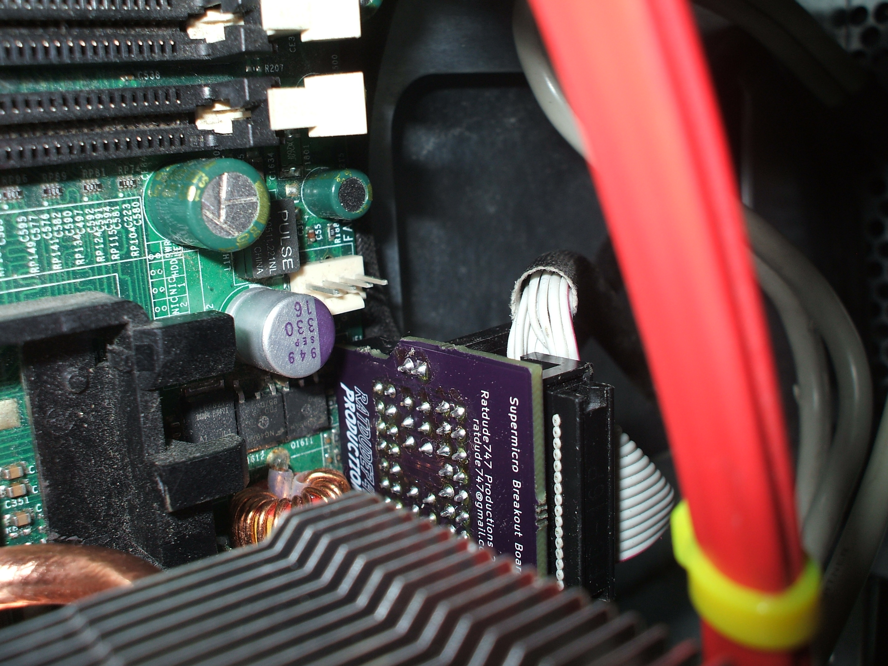

              I also installed one of my supermicro breakout boards:
              Works great... although that was my last "nice" one as OSH Park boards are done in sets of three and I have two in use (the third was gifted to topcat). I may do a reorder from digkey and OSH park for spares? IDK, they're pretty cheap but I don't need another (even if I did I have one of the old milled jumpered boards left).
              All that's left is finding a decent 2nd SATA optical drive (DVD Burner, Blu-ray is still ridiculously pricey if you get a new one with software) and a better GPU for V5.2 (unless I chose to buy a 3rd GTS 250... IIRC I got them for like $20 a pop NOS last time?). Suggestions (on what to buy/what you have that you want to sell only) are welcome here...

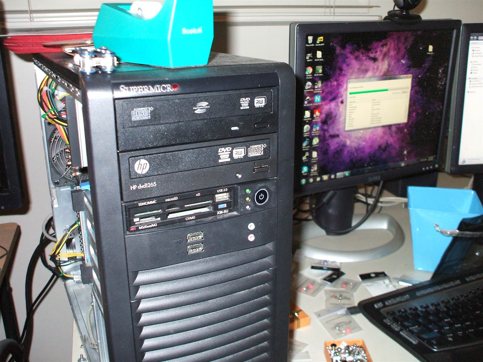

                  Update time!
                  This has become my wife's workstation; while she uses her laptop a lot, this gets some usage too.
                  Scored a second DVD drive for it. $5, brand new in (open) box HP dvd1265:
                  Ugly but functional. $5, I'm not complaining.
