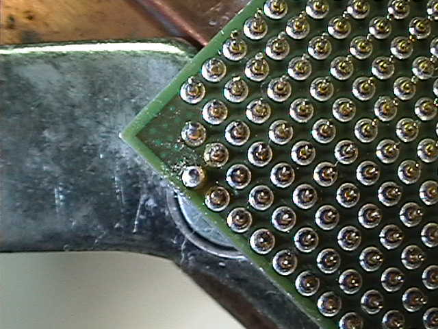

                              On the line of fine repairs, here's an S939 AMD Athlon 64 FX-57 CPU I fixed:
                              https://www.badcaps.net/forum/attach...1&d=1357267053
                              This CPU was left by some customer in my friends repair shop and sat on my friend's desk for over a year (if not 2). During that time, the CPU has had various stuff sitting on it. It even took a drop to the floor a few times. As a result, almost all of its pins were severely bent. 2 of them were actually broke when I found it, but as the pictures show, I was able to solder a thin piece of wire from some through-hole 1/4 W resistors. I expected fireworks when I plugged it in my mobo, but it actually worked fine. Unfortunately, my only working S939 motherboard - an AsRock 939Dual-SataII - is a finicky piece of turd that crashes very often even with my Athlon 64 3200+. Installing the FX-57 just made the board crash even more often (in games, that is).
                              By the way, sorry for the crappy pictures. My camera cannot take such close up shots so I had to use an old camcoder that can only take snapshots in 640x480 res.

                                Is it worth the time to fix that cpu? I have no idea about 939 cpus?

                                        Originally posted by momaka
                                        ... almost all of its pins were severely bent. 2 of them were actually broke when I found it, but as the pictures show, I was able to solder a thin piece of wire from some through-hole 1/4 W resistors. I expected fireworks when I plugged it in my mobo, but it actually worked fine ...
                                        That's superb craftmanship . Processor pin fiddling is a difficult art that can easily drive you insane . My Tualatin 1400-S is still trembling from the incredibly harsh language it required to run OK in the i440BX mobo .
