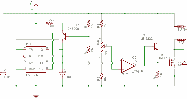

                The fan controller in my computer uses a TC648B IC driving an IRF510 MOSFET. The fan speed changes automatically as the temperature changes. All you would have to do is build the application circuit in the TC64x datasheet (the TC64xB datasheet does not contain any application information). The resistors in the voltage divider on the IC's input need to be calculated based on the resistance of the thermistor being used at both the minimum and maximum desired temperatures.
                A 555 timer can be used as well if the temperature warning in the TC648 is not needed or if you want manual control of the fan. All of the parts needed to build a fan controller using a 555 timer can be purchased at Radio Shack.

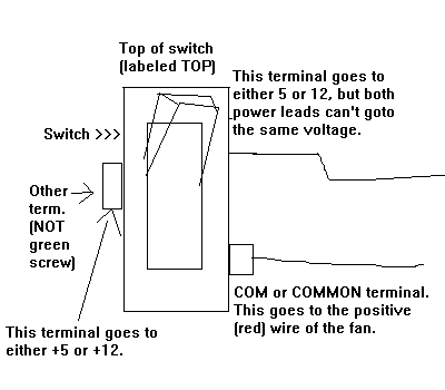

                        I have a cheap and dirty way to do it:
                        Materials:
                        )Fan
                        )3 way standard household light switch
                        )Time
                        )My diagram
                        )Power supply
                        )Electric wire (I use 22AWG)
                        Step 1:
                        Cut 2 pieces of wire and strip both ends. Attach the wires like shown in Pic #1.
                        NOTE: Don't use the green screw, otherwise it won't work!
                        Step 2:
                        Attach the negative (black) wire from the fan into a ground connection on the power supply.
                        Step 3:
                        Connect the other two disconnected wires in to the psu, one to +5V (red) and one to +12V (yellow). NOTE: It doesn't matter which one you connect; the only difference is that the way you flip it to get different speeds.
                        Step 4:
                        Mount the fan and switch where you want them to be.
                        Step 5:
                        Plug in and turn on your PC. The fan should start spinning. Flip the switch. If it spins either slower or faster, then success! If your PC will not turn on (no power), double check your wiring and go for it again.
                        Step 6:
                        You can get creative with this, example: finding a unique way to mount the switch. I, personally, would hot glue it to one of the open expansion brackets and cover up the holes with electric tape.
                        All the above made purely by me!

                          Circuits for a microcontroller based fan controller is very simple (even more simple than the analog circuits you linked). So they would not take much time at all to build.
                          Originally posted by Mad_Professor
                          Could I have several lower amp transistors to power four 3 pin connections and one molex to reduce heat emmision?
                          Yes you can easily achieve this using a microcontroller based circuit.
                          What I would do is connect each fan to a separate PWM channel on the microcontroller. Therefore in theory each fan could be controlled independently and uses lower power transistors. When you write your program, one would write something like; 'When the value of the potentiometer changes, change the PWM duty cycle for PWM channel 1 to 4'. This is just an example, however it is practical and easy to achieve. I believe it is also the most flexible. In the future one could easily change the setup if desired. For example if in the future you wanted to control each fan independently using separate potentiometers. It would be possible to achieve by just adding a few potentiometers, connect them to the microcontroller and change the program slightly so that each PWM channel is controlled by a separate potentiometer.
                          I don't have PWM fans.
                          How big of a heatsink and on what?
                          You can send a PWM signal to a non PWM fan. From memory I have heard that some fan's may not like certain duty cycles so they groan a bit. However increasing or decreasing the speed a bit should fix that. I believe nearly all commercial fan controllers make use of PWM to control the speed of the fans.
                          Just to clarify what a PWM signal is. PWM is the process of rapidly switching the power to a device on and off very rapidly. On a 12V fan, this means switching between 12V and 0V very rapidly. The ratio between the time that the fan is turned on to the time that the fan is turned off is the duty cycle. For example, a 50% duty cycle implies that in one PWM period, the fan is turned on half the time and turned off half the time. The average power delivered to the fan is 50% (or 6V). The fan will run as if it were run at 6V, however this is achieved by rapidly switching between full power and no power.
                          The linear circuit which you have linked works differently. I can not go into the full electronics scheme of things without analysing the circuit again. However the idea is that when the potentiometer is set at 50%, the actual output voltage will be 6V and the 'excess' 6V worth of power is dissipated as heat (most likely through the transistors). It does not switch between full power and no power to achieve an average voltage or an average power output.
                          On a PWM circuit, it is unlikely you will need heatsinks at all. However on a linear circuit, you will require a heatsink on the main transistor in the circuit. It will heat up to 'absorb' the wasted power.

                                • Agent24
                                  I see dead caps
                                  • Oct 2007
                                  • 5096
                                  • New Zealand
                                  Re: I need to make a fan controller.
                                  Here's my favourite: http://web.archive.org/web/200705182.../circuit3.html
                                  Originally posted by mariushm
                                  The 3 pin headers tell you the fans change their speed by altering the voltage ... you have 2 wires for power and one to tell the computer the speed.
                                  So you can't use the PWM design with such fans.
                                  Yes you can. Full 0-100% PWM, real simple, works with any standard fan. Manual speed control and can handle big loads with a big MOSFET.
                                  Value of RF is explained on the website.
                                  -David VanHorn
