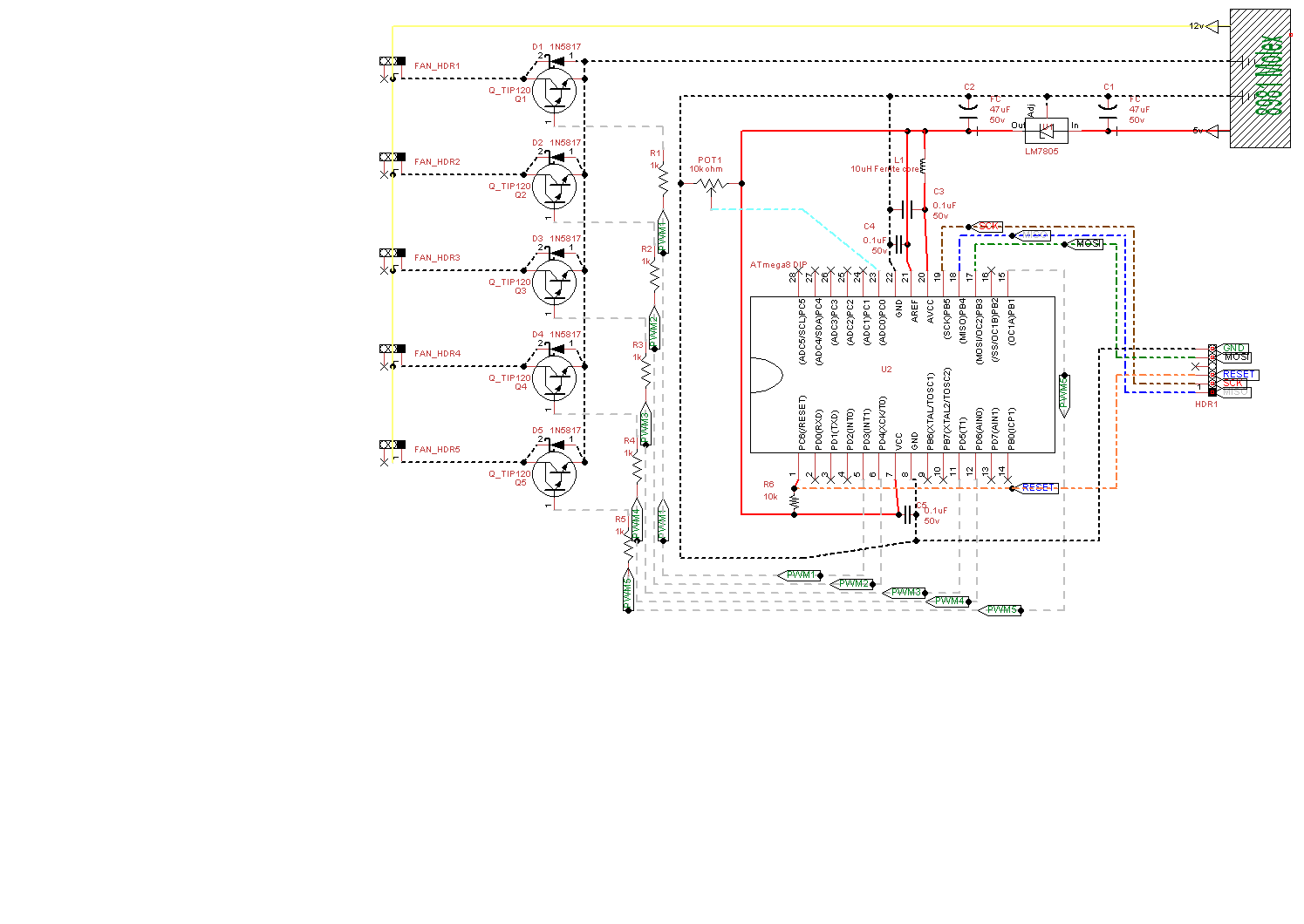

    Ok so I'm working in tinycad since veecad needs a netlist to place components.
    Anyways I just realized something, do I need to have digital outputs for each set *1k>tip120>fan* that say PWM on the arduino pin out or can I use one PWM output to control the 5 transistors?
    If I can't then can I use any pin that says digital I/O?
    http://arduino.cc/it/Hacking/PinMapping168
    This left side of the chip and place the chip to the right on the board.
    I was going to use,
    digital I/O PWM pin 3/actual: pin 5 on chip
    digital I/O PWM pin 4/actual: pin 6 on chip
    digital I/O PWM pin 5/actual: pin 11 on chip
    digital I/O PWM pin 6/actual: pin 12 on chip
    I want to use
    Digital I/O pin 7/actual: pin 13 on chip
    But it doesn't say PWM. I don't know if I can use it as PWM connection.
    I was going to put the pot on the right side of the board too and connect it to where it says analog PC0.
    Then below the chip put my DAPA header and run the lines to the right side of the chip.
    Then the left side can be used for tip120, diodes and resistors and headers.
    It has been a while since I checked out this thread. I say the easiest and most flexible way of achieving what you want is to connect each transistor to a PWM output. In theory, one could power all five transistors from one PWM output. However I doubt that the current output from the microcontroller will be able to power five transistors. Therefore you will probably need another transistor to provide the extra power required to energise all five transistors at once from a single microcontroller output.
    I would suggest to use the same PWM outputs as the Arduino. That way it is much easier to program using 'their' language. Not all Digital I/O pins can be configured for PWM use. Only one or two ports on the microcontroller will support PWM output. From memory, there are more PWM pins than what the Arduino's provide on their boards (this would have to be confirmed by checking the datasheet for the ATMega168), however if you use these pins, it will be difficult to make use of the Arduino C like language and their hardware libraries. On top of that, perhaps those extra PWM outputs are required for other purposes such as ICSP programming.
    For the software side of things, I tried a fair few free products and found them all to be quite difficult to use (to design stripboard layouts). I found Lochmaster very good and intuitive for stripboard design. Unfortunately you can not design a schematic in it. Therefore you have to verify your layout against your schematic manually. For your circuit, it should be pretty simple. However it would be a problem for complex circuits, however stripboard is not that effective for complex circuits so it's unlikely to be used for such complex designs.

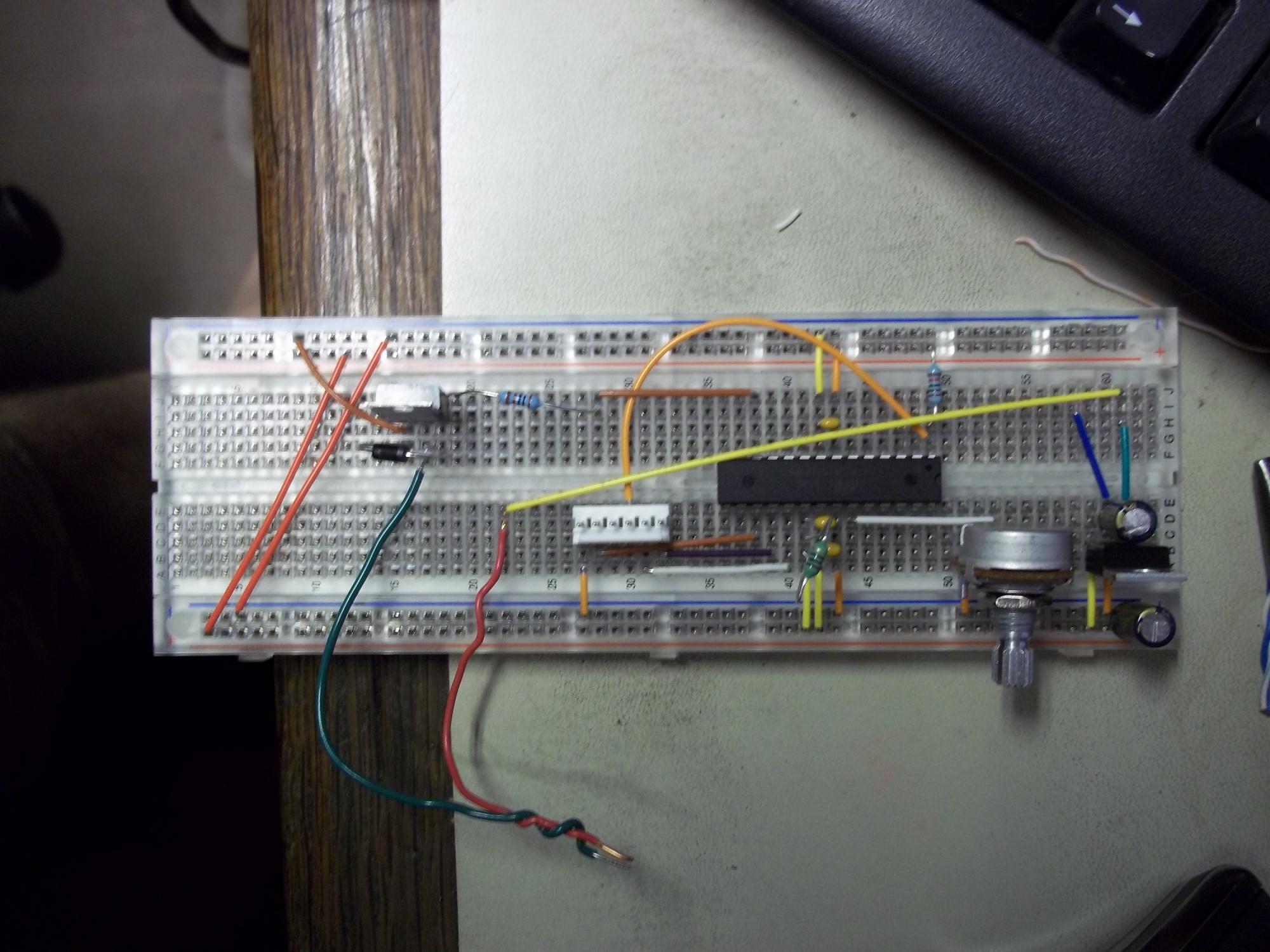

      Got the parts today. Its on a breadboard. When I was putting it together I realized I made some errors in my schematics.
      My inductor was on the wrong pin, needed to be on AVCC. My 10k resistor for reset was connected to ground.
      Wrote some code but I don't know what board to compile for.
      Not to be vague but under tools > boards > ??
      Code:
      int fan1= 5;
      int fan1val = 0;
      int pot1 = 0;
      void setup() {}
      void loop() {
      fan1val = analogRead(pot1);
      fan1val = fan1val / 4;
      analogWrite(fan1, fan1val);
      Tomorrow I'm going to get my old p3b-f board and load XP or linux, whatever I feel like using and hack up a parallel cable and make an attempt to load this sketch on to the chip.
      Also can someone double check and verify my breadboard setup, I don't want to fry something but I think it's correct.

                    IT WORKS!
                    I'm still having problems with the arduino software but the controller works as planned. Also I just realized I got the wrong voltage regulator, I got one with input 7v-35 instead of 0-35v Oh well I'll just stick it on the 12v anyway.
                    The problem I'm having with arduino software is when I made a board in boards.txt and tried to use the upload button but it spits out an error stating that it could not open port com 1 because com 1 is not a valid port for dapa it needs to be lpt1,2, or 3. But I can't find the setting to specify it.
                    I work around it using the upload via programmer option in the file menu.

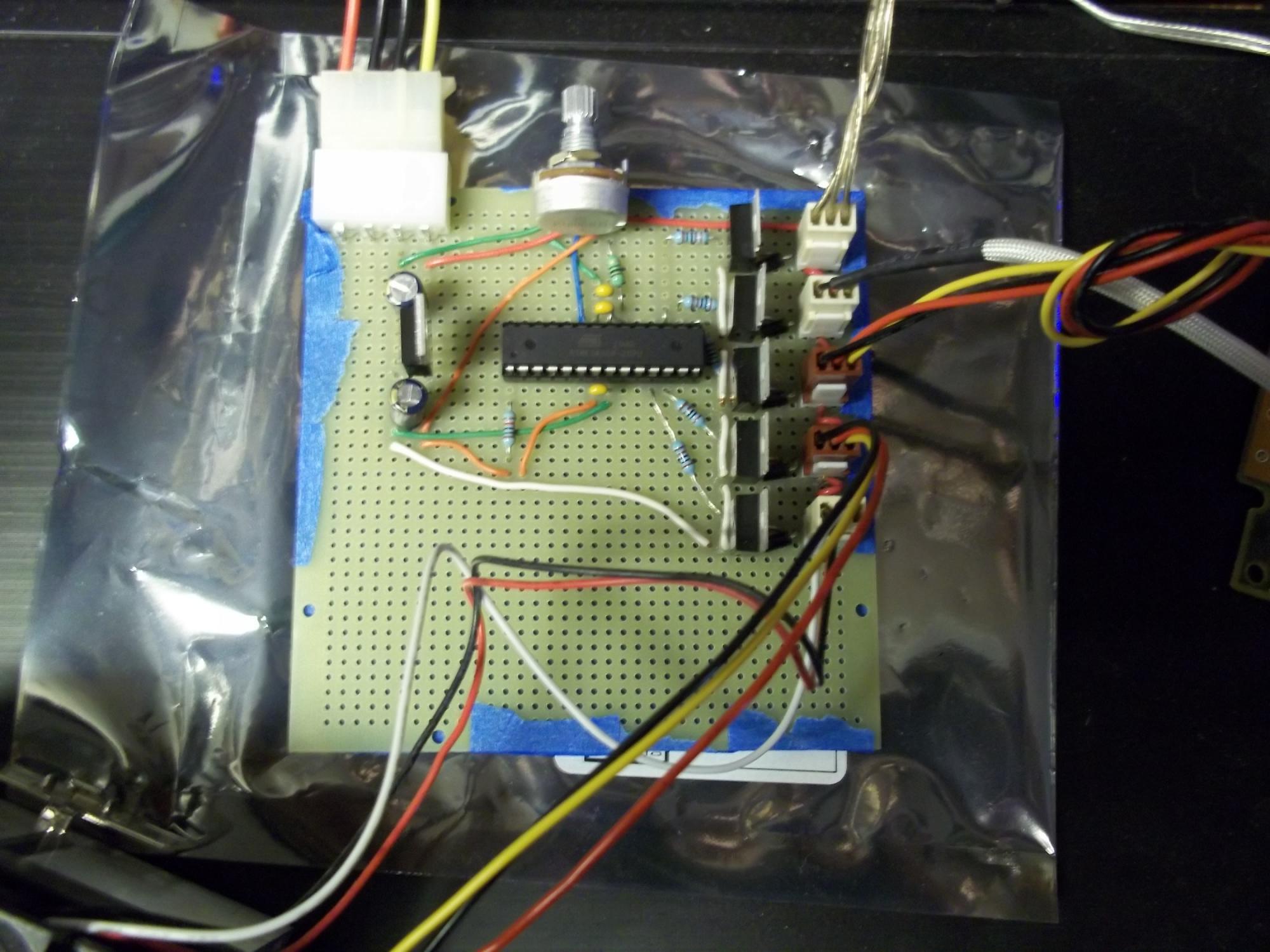

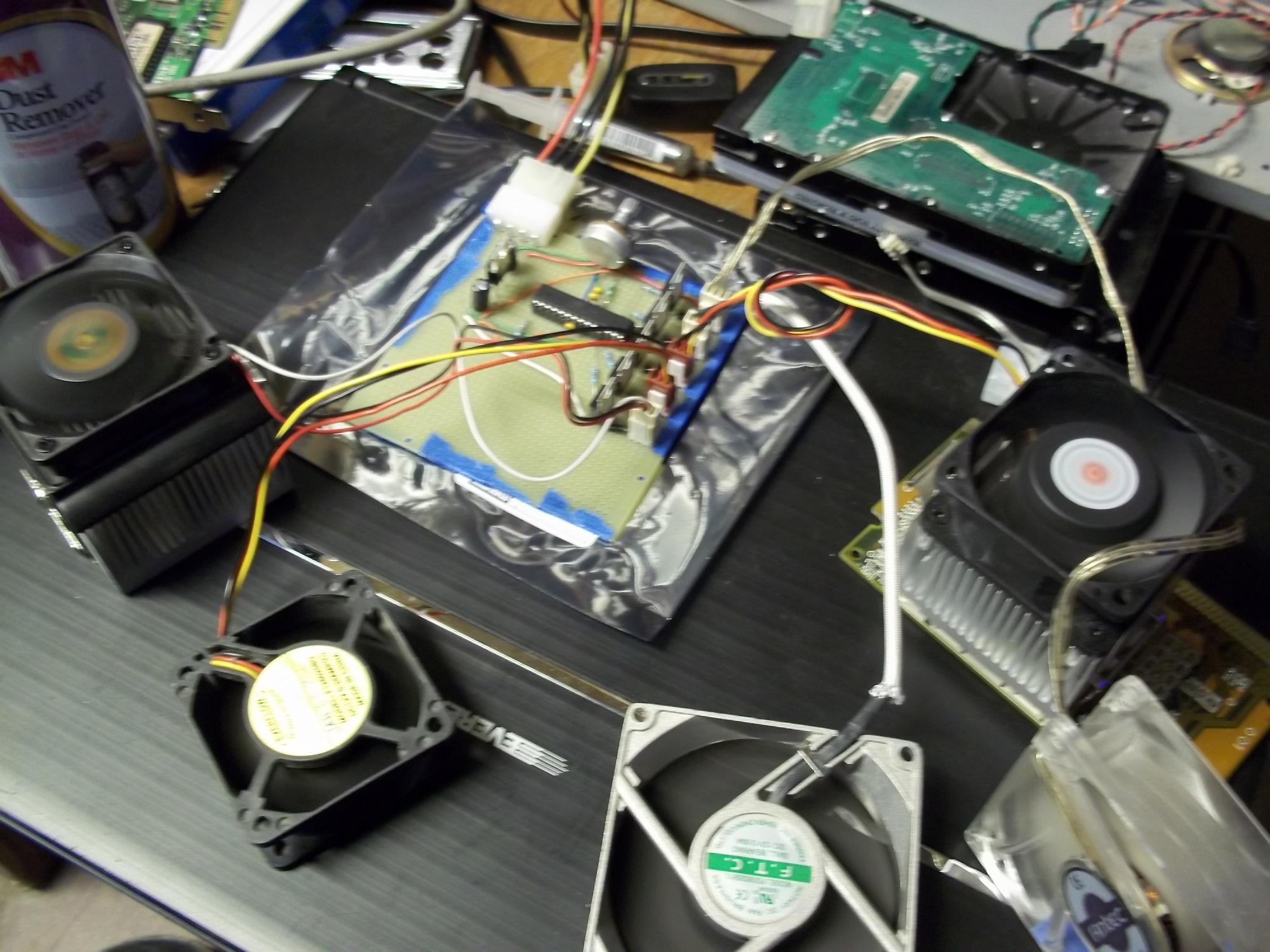

                                    It is done! Fresh out of the oven!
                                    I shall call you FRANKENSTEIN!!!

                                      Re: I need to make a fan controller.
                                      Good work. Looks nice.

                                        Powering up your circuit on a conductive anti-static bag probably isn't the best idea.
                                        -David VanHorn
                                        • Mad_Professor
                                          A Mech Warrior
                                          • Feb 2011
                                          • 1587
                                          #80
                                          scotch taped the bottom. But that's funny, I've put motherboards and other stuff on anti-static bags, never had a problem.
                                          Didn't know those were conductive.
