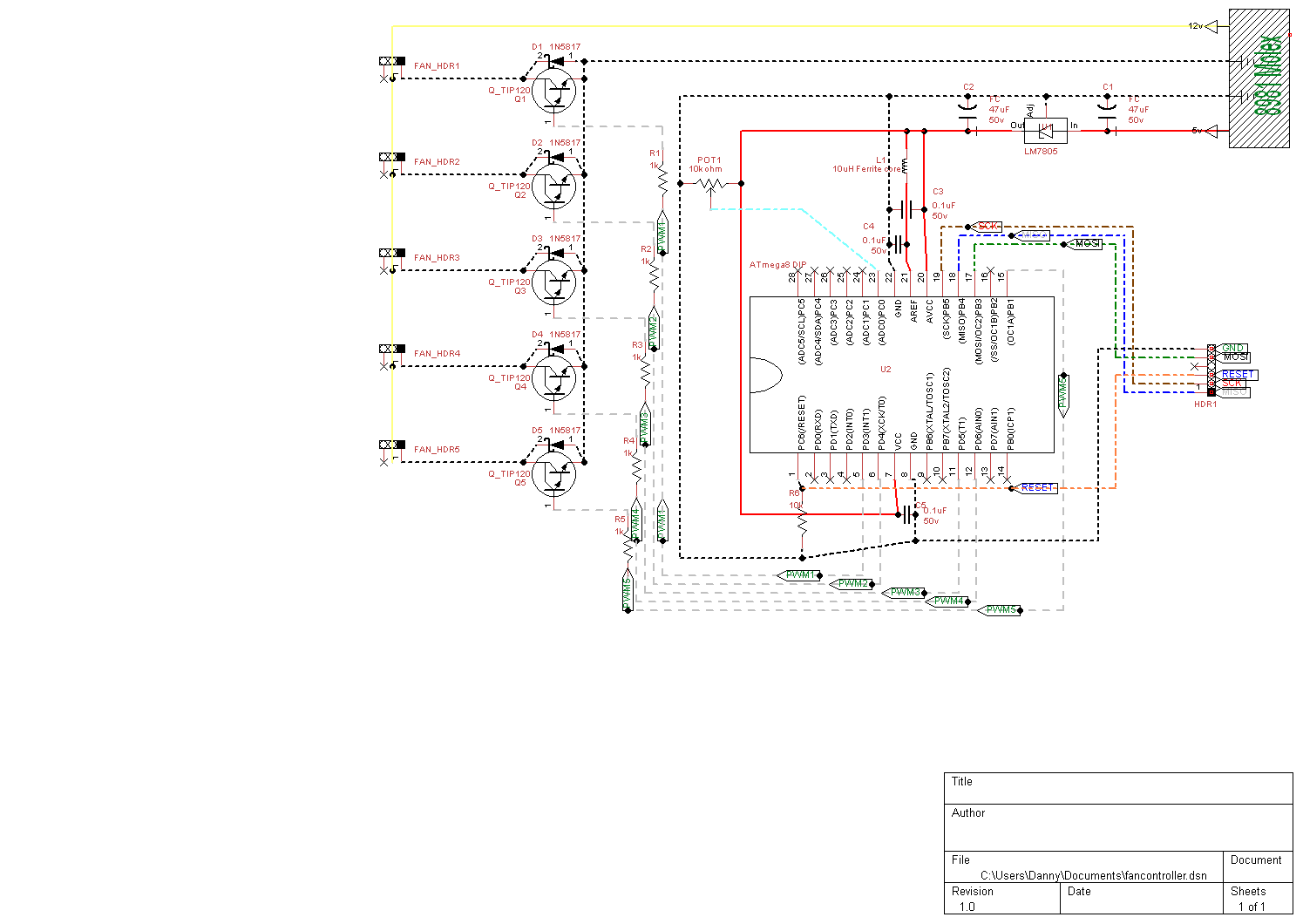

    But I don't know what kind of inductor I want?
    I'm guessing the one I want is going to be "FIXED" but there are so many variables and types, Half the stuff in the columns doesn't make any sense to me.
    Also does AREF need a ceramic cap?
    I just checked the datasheet for the ATMega168 microcontroller. It is a bit confusing, however it says that analog reference voltage can be set to either AVCC, 1.1V or an external voltage connected to the AREF pin. For your case, I would suggest that AVCC is the most appropriate setting (and probably the default configuration). The datasheet does also say that you can connect AREF to ground using a small capacitor (the ceramic capacitor you are talking about) for greater noise immunity.
    Therefore I would say it is up to you whether you place a capacitor there or not. I do not think it will greatly affect the operation of the circuit for your purposes.

      Just get a low-current axial inductor\choke. They look like a 1/2 watt resistor but a little larger. Yes it will be fixed value.
      If you can specifiy on the website you want an axial one, and then input the value (100uH I think it was?) and then sort by price, you should find the cheapest one will probably be suitable.
      (Like this: http://jaycar.co.nz/productView.asp?...H&form=KEYWORD)
      I don't really know the function of AREF. I don't think it needs a capacitor, but I am not sure. The Arduino I built did not have one on it.
      -David VanHorn

            SO I put together a part's list, I just want someone or everyone to double check and correct me on any items.
            I plan on building two of these, one for the application and one for fun. You know to mess around with. It could be used for a backup should I screw up..

              Re: I need to make a fan controller.
              The links aren't working...
              These seem to be the ones you're looking for:
              http://search.digikey.com/us/en/prod...-PU-ND/2271215
              http://search.digikey.com/us/en/prod...10PU-ND/735447
              http://search.digikey.com/us/en/prod...20PU-ND/735446
              There may be slightly cheaper ones running at 10Mhz or lower, but I don't really think it's worth the trouble... these run at 20 Mhz and they should be perfect for your needs.
              Other than the last being more power sensitive (2.7v-5.5v vs 1.8v-5.5v for the first two) I don't see any differences. They all go in 28-DIP (0.300", 7.62mm) so you need to get a 28-DIP with 0.300" spacing:
              So I guess these should work:
              http://search.digikey.com/us/en/prod...0210-ND/990628
              http://search.digikey.com/us/en/prod...480-ND/1133633
              Basically search for "DIP socket", then filter by one category at a time, 0.300" 7.62mm , then through hole/wire wrap , and so on...
              Make sure your computer actually has a parallel port, some USB to parallel adapters don't work for flashing these devices.
              ps. Since you're gonna power this from 5v most likely, you may have spikes of power on 5v that are over 5.5v comin from the power supply... most power supplies also do by default about 5.1-5.3v ... the chips will probably resist some spikes of power but it wouldn't hurt getting something like this:
              http://search.digikey.com/us/en/prod...CTFS-ND/458700
              This takes 7-35v and delivers 5v @ 500mA (minimum), which should be enough to drive the controller.

                Thanks for telling me the links were dead.
                I have the last avr you listed in my basket already. do you think I should go to the one of the others?
                Also my desktop computer does not have a parallel port but I do have some old computers and old main boards I can easily load up with XP or Linux.
                As for the voltage regulator..
                I have a corsair TX 750 PSU in the server, do you really think it might spike?
                You know what, I don't want to play with fire so I'll add them in with two panny 47uF 50v FC caps.

                  Not sure about those inductors, Agent or someone more knowledgeable should give you feedback on that.
                  For the resistors, it depends on what you're going to use them for... for some uses the 5% tolerance may be too much ... that makes the 10k resistor anything between 9500 and 10500 ohm.. 1% resistors shouldn't be that hard to find and they're not that more expensive.
                  If it's just to light a led, 5% resistors will be fine, but if you want to use them for PWM or determine a ratio using the potentiometer and a resistor, I would probably go for 1% tolerance.
                  I don't know if 10k for potentiometer is enough, not sure how you're using it. If it's gonna be for the controller to detect a voltage between 0 and 5v on a pin and convert that to digital with the ADC, maybe a larger resistance value would give you a wider variation...
                  2x 6pin header *making a inline ICSP interface for my DAPA cable.* ...check the pitch and make sure it will match with your existing connector.... this one you selected has pitch 0.156" (3.96mm)
                  If you plan to make the cable from scratch just go at the bottom of the page for that one and select from "mating products" a "mother" connector (the connector you plug those pins into), for example one of these (digikey is a pain, lists 500 mating items, most are non stock or minimum 2000 to order):
                  http://search.digikey.com/us/en/prod...1647-ND/769791
                  http://search.digikey.com/us/en/prod...1244-ND/696766
                  You just pull out the metal connectors inside with the help of a needle and then press the wire and plug back the connector in the plastic case.
                  As for the power supply... it's a good one, but won't provide you with 5v sharp, it will most likely give you a bit more than that on the cables, 5.3 or something like that.. the atmega will probably tolerate more than the max of 5.5v but why risk it when the prevention is less than a dollar?

                    The inductor looks fine to me.
                    Well, the 555-based fan controller that I posted earlier uses a 10k pot and it works great, so I guess it would be OK here too. Then again, it goes between 12v with a 9k resistor on each side, so, yeah.....
                    With the 0.1uF Capacitors and the 10K Resistors, you might as well buy several more. I usually purchase about 30+ of each when I order something like this, so I have more for next time I want to do something.
                    Those values especially are very commonly used too, so it makes sense to have a few spare, and they are cheap.
                    Not sure why you're using a 78M05. It can only supply 500mA while a normal 7805 can supply 1 Amp. Though for this usage I doubt it will make any difference though. Again, you might want to buy several for future use, in which case, the higher current ones might be better.
                    Everything else looks fine, but I don't see a crystal, if you are using one.
                    Speaking of crystals, a good thing to note is the dielectric type of the ceramic capacitors, which affects stability due to temperature variations etc.
                    There are several different types. The ones you picked are X7R which are good for non-critical purposes but for crystal loading capacitors and other things where you want better stability it's better to use C0G/NP0 types.

                                  #56
                                  Ok so I'm working in tinycad since veecad needs a netlist to place components.
                                  Anyways I just realized something, do I need to have digital outputs for each set *1k>tip120>fan* that say PWM on the arduino pin out or can I use one PWM output to control the 5 transistors?
                                  If I can't then can I use any pin that says digital I/O?
                                  http://arduino.cc/it/Hacking/PinMapping168
                                  This left side of the chip and place the chip to the right on the board.
                                  I was going to use,
                                  digital I/O PWM pin 3/actual: pin 5 on chip
                                  digital I/O PWM pin 4/actual: pin 6 on chip
                                  digital I/O PWM pin 5/actual: pin 11 on chip
                                  digital I/O PWM pin 6/actual: pin 12 on chip
                                  I want to use
                                  Digital I/O pin 7/actual: pin 13 on chip
                                  But it doesn't say PWM. I don't know if I can use it as PWM connection.
                                  I was going to put the pot on the right side of the board too and connect it to where it says analog PC0.
                                  Then below the chip put my DAPA header and run the lines to the right side of the chip.
                                  Then the left side can be used for tip120, diodes and resistors and headers.

                                    #57
                                    I would advise getting into the habit of drawing up a schematic and getting a netlist, it might take extra time but it's worth it, because then you can't make mistakes on your board layout.
                                    The software will only let you connect in the board layout what is already connected in the schematic and netlist.
                                    (Of course, this works the other way too, if you make a mistake in your schematic, that flows through into the netlist and board layout)
                                    I'll let someone else answer your other question about the PWM pins, I'd probably get it wrong!

                                      #58
                                      Veecad is just fucking useless. I made my schematic. I export it using protel format and when I import it into Veecad it comes out as U shape components. Then when I try to add TinyCad libraries to Veecad and try to import again, it says ERROR: File version information not found. If I remove all the tinycad Libraries from veecad then it works but all U shape components are back.
                                      I'm too tired and I can't get Veecad to work, so fuck it.
                                      I went ahead and change my resistors from 5% to 1%.
                                      What changed:
                                      78M05 replaced with this
                                      MC7805CT-BPMS-ND
                                      Replaced 220 ohm resistor with this
                                      PPC220YCT-ND
                                      Replaced 470 ohm resistor with this
                                      RNF14FTD470RCT-ND
                                      Replaced 1k ohm resistor with this
                                      RNF14FTD1K00CT-ND
                                      Replaced 10k ohm resistor with this
                                      RNF14FTD10K0CT-ND
                                      ADDED
                                      A31647-ND *Locking Ramp MTA-156 connector*
                                      This is what my layout looks like in tinycad. Now I got to figure out what size stripboard, actually I might buy it locally.

                                        #59
                                        This might be a stupid question, but why are you exporting to Protel format?
                                        -David VanHorn
                                        • Mad_Professor
                                          A Mech Warrior
                                          • Feb 2011
                                          • 1587
                                          #60
                                          Because I don't see a veecad on export or a tinycad on import option.
