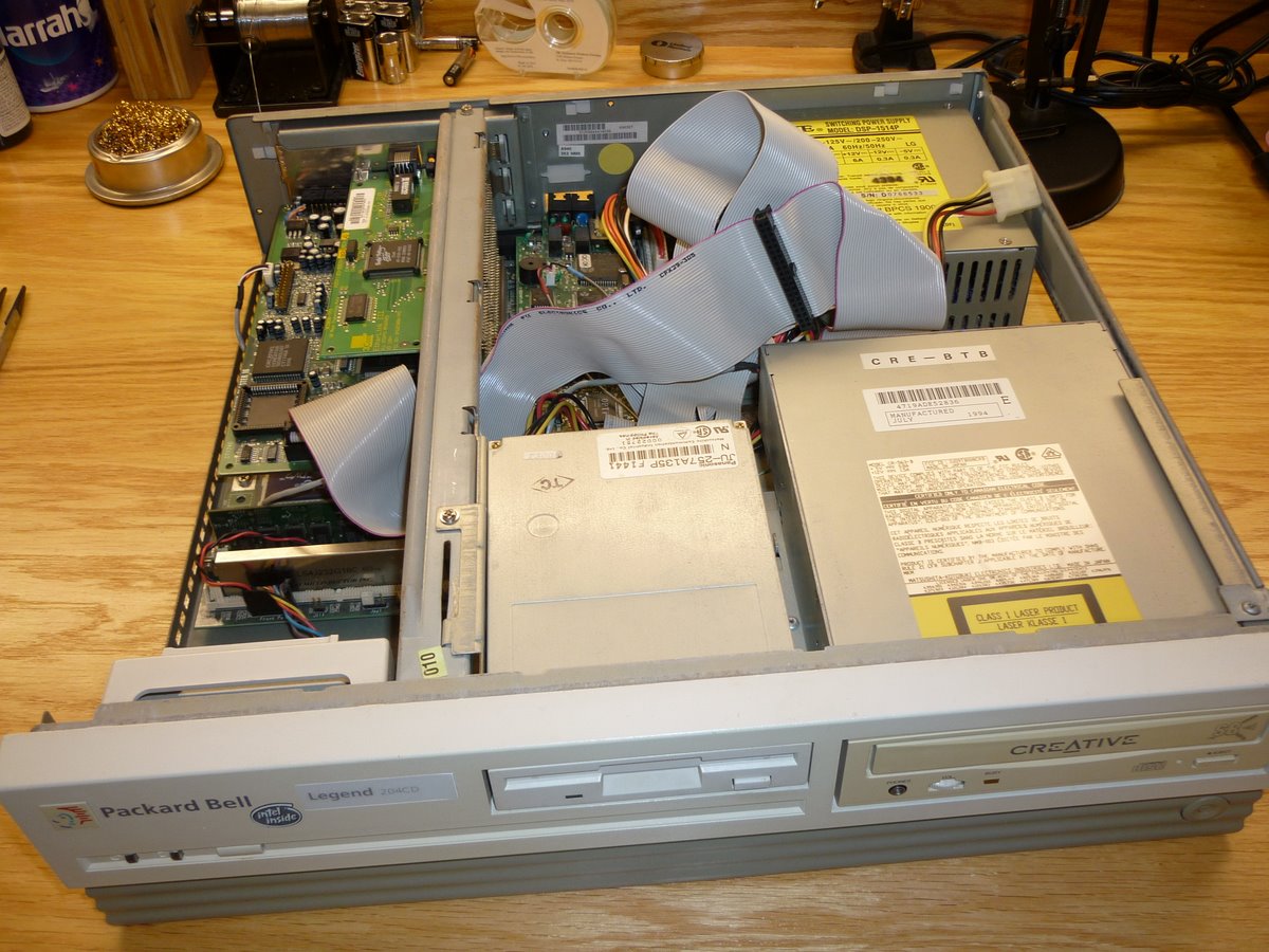

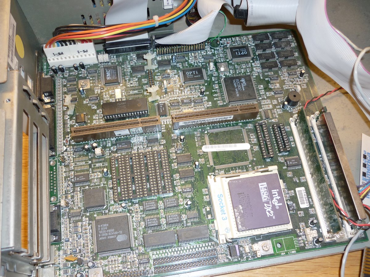

                        Your old PB still has a friend
                        Here is mine, which is much like yours. PB Legend 204CD according to the front. What number is on your front? The mobo looks the same but does not have the 'M' logo. I feel ripped off. The sound card, cd, hd, and nic are not the stock originals. I dealt with the dead battery by eliminating it and soldering onto the stubs. Couldn't have the old one leaking on the board anyway. And I have TEAPO caps on the riser card!! I don't have the suave original keyboard and mouse either. I think I gave those away at some point.
                        I have mine setup with a bunch of old games although I haven't turned it on in ages. I also used it in college to link with my TI-85. The homemade serial link cable did not work with faster computers for some reason. One detail that I remember about these was the gray trim pieces are removable and could be replaced with different colors (blue, neon green, pink, etc.). Although I doubt that many people forked over extra $ for that privilege.
                        Any idea if these support EDO ram? I think I have a pair of 16meg EDO SIMMS. Just no more FPM SIMMS.
                        Some more inline pics for the haters:

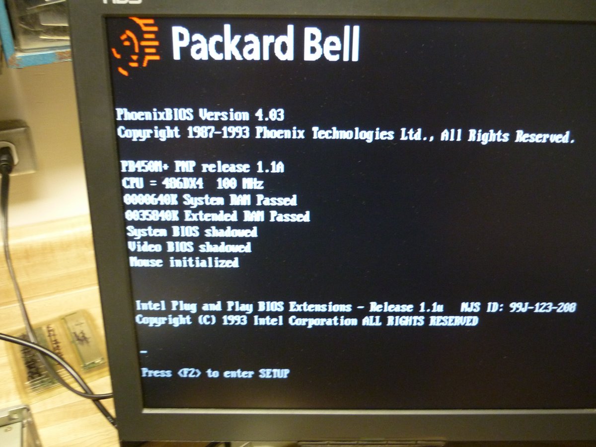

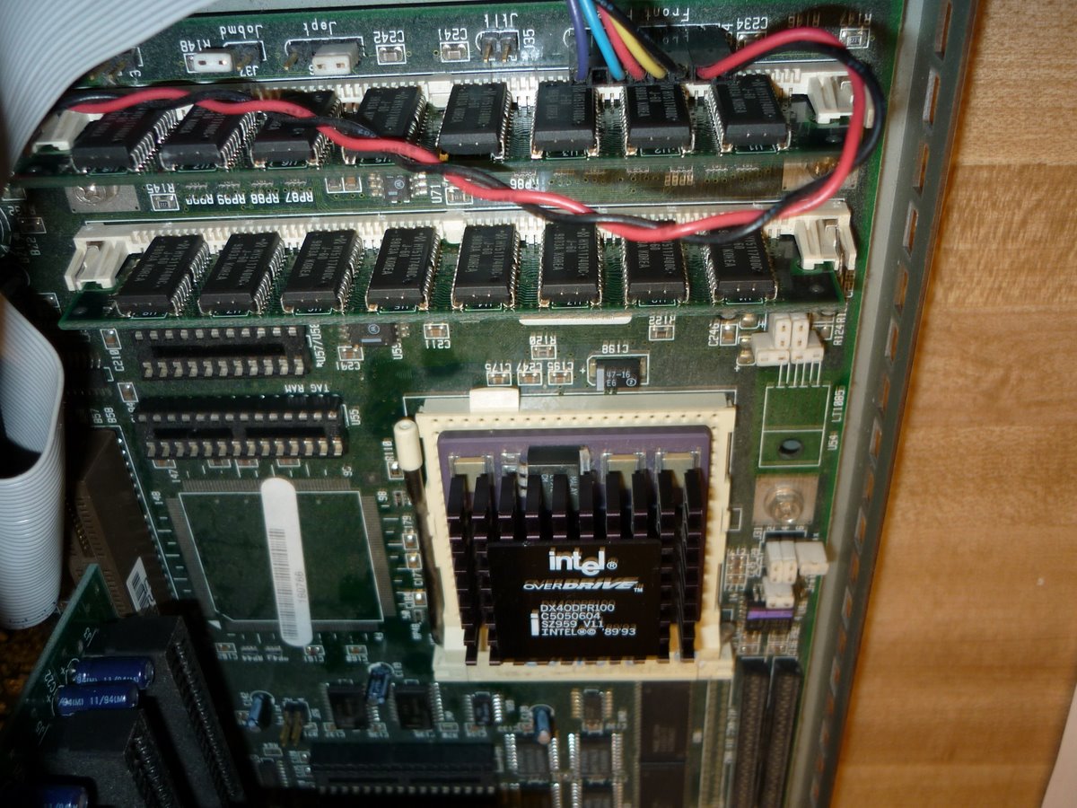

                          Re: 486DX2-66 worth keeping?
                          Hold the presses! A new development! Since I had this one open and a handy link to the jumper settings, I decided to experiment. I pulled out that creaky old DX2/66 and popped in a shockingly fast DX4/100 overdrive chip. And what do you know, it worked with out changing any jumpers! OVERDRIVEN!!
                          Now on to the RAM, I had thought all I had was some 16 meg EDO SIMMs. Turns out they were FPM! So no longer am I stuck with a 4meg + 8meg + 4 meg onboard (16meg total). I now have 16meg + 16meg + 4meg onboard for a whopping 36 MEGABYTES OF RAM. It fired right up with the new RAM without so much as a whimper. Unusual for Packard Bell.
                          TAKE THAT WEIRDLOOKINGGUY
                            I don't think they supported EDO, just FPM.
                            http://stason.org/TULARC/pc/motherbo...-CD-486SX.html
                            - Hard to say though.
                            They used a lot of different motherboards in the Legend series.
                            Their 'run' went at least from 386 to 586.
                            Even the PB450 I had came in two versions: PCI capable and 'not'.
                            Only the later ones had a Flashable PnP BIOS.
                            There were some early Pentium boards that fit the chassis BTW.
                            Unfortunately the model number is on the bottom side of the board.
                            - At least it was on mine.
                            Have to take them ~all~ the way out to see it...
                                  I can't seem to say away. I have a pair of DX4 chips sitting on my desk right now (see the gold scrap thread). I was thinking that wierdlookingguy could use one of them. But remember that the DX4 needs 3.3v. And that my overdrive DX4 provided a built in voltage regulator. So all is well there.
                                  But then in looking at the jumper settings, I see that this board has jumpers to select 5v or 3.3v. However upon closer inspection I see that both my board and WLG's are missing the voltage regulator and a couple SMD resistors near it and the CPU. So I am guessing that this board will not run a DX4 without either a voltage adapter socket, an overdrive DX4, or some major surgery.
