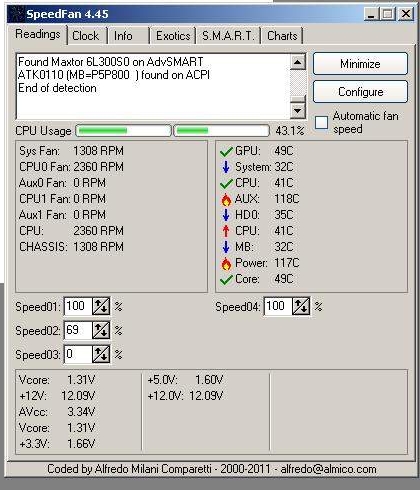

    This is the readings that show from it at the screen shot. The Cpu and Gpu look normal. But cmon 107 C for power and aux? It doesn't even say what power or what auxilliary.
    If it was that hot then i could fry eggs or it would of caught on fire ages ago.

    That's a bug in the motherboard's sensors, not speedfan. It's very common, particularly on older hardware. It's nothing to worry about. I remember having a Pentium 3 machine where the BIOS would always show >105*C as the CPU temp (despite the fact that the cooler was assembled and the machine was running just fine)
      Re: Speedfan must be buggy
      or the thermistors are not installed or maybe damaged?
      you can run into this with oem boards reflashed to get back overclocking contols,ect.

          I've recently installed SpeedFan and it's been a right bastard to set up correctly. Different sensors are often not picked up for various reasons, and not just on older machines. And some of my temps were in the minus hundreds! You also have to figure out what each value/parameter is correctly related to.
          But after a shed load of messing about I finally have it (and my fans) running just how I want/need.

            And AFAIK the onboard sensors are not accessible/replaceable, excepting maybe the case/ambient (that one is accessible on my rig)

                SpeedFan has been buggy for ages. There's CoreTemp for the CPU, GPU-Z for the graphics card, and for the motherboard you can just feel the chipset heatsink with your finger - most mobos don't have a chipset temp sensor anyway, and the "motherboard" temperature is reported as the case temp - and usually a lot lower than it really is.

                          My HP BIOS is very limited regarding user configuration - the only fan control is for setting idle speeds. When I replaced a single Xeon with two uprated Xeons both CPU fans ran continuously at full speed with no means to lower them. Enter SpeedFan. It's taken a lot of investigation and experimentation but I've now got all my fans running just how I want - and my case no longer sounds like a jet-engine test-bed. Bear in mind there are 7 fans plus graphics card that I need to control. One of the problems with setting up SpeedFan was sorting out what was controlled within each 'zone'.

                            I went over to Everest (now AIDA64). Can't control the fans from what I know, but the temperature readings are accurate on most boards (and it tends to filter out ridiculous values like the -255°C one board showed me in speedfan lol)

                              I reckon the reason a lot of people say its rubbish or doesn't work for them is because they can't get to grips with the different parameters/values/settings. SpeedFan needs a lot of figuring out initially but if someone can't be bothered persevering they just give up and say it's crap. I found it frustrating at first and nearly gave up but there isn't really anything else that can do the job so I decided to carry on. Now I have the fans/temps just as I want them, so it has definitely worked for me.
