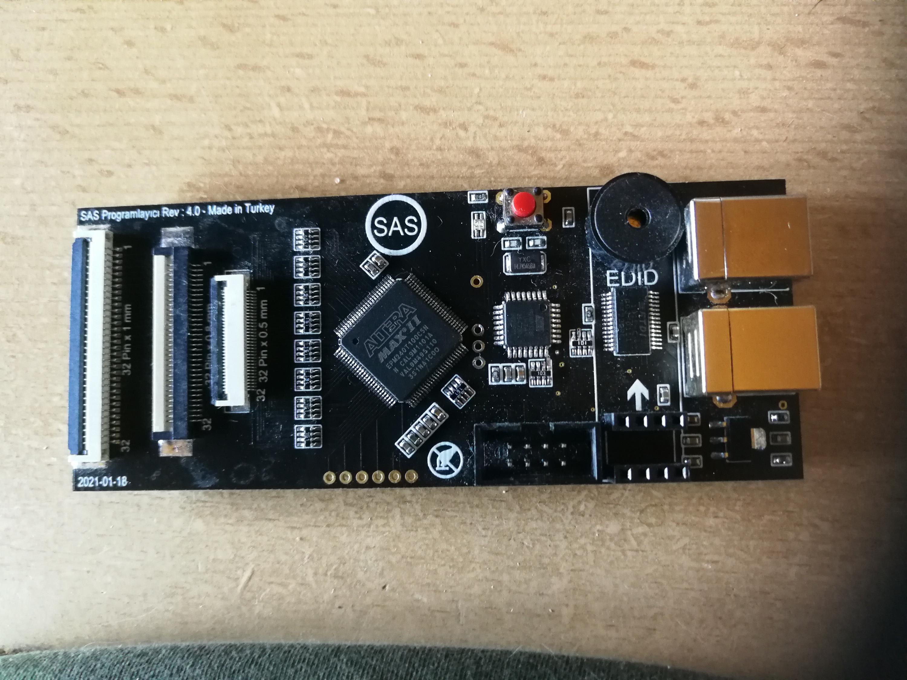

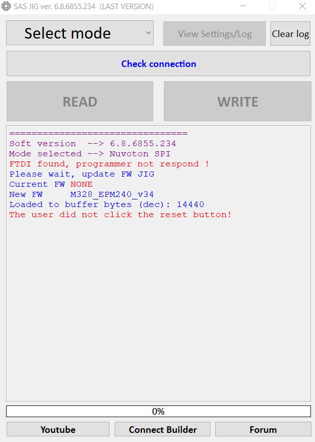

    HELLO
    I have a SAS IO programmer version 4.0 here, which recognizes the FTDI when plugged into the USB
    But it reports that the programmer is not found.
    I think the firmware on the Atmega 328p is buggy.
    Does anyone know where I can get the hex file from??

    Re: SAS IO Programmer v.4.0 defect
    This happens if the FTDI chip itself is not original (fake)! And because of this, the official drivers do not get up.
      https://www.badcaps.net/forum/showth...SAS+programmer ,post #13 might help, contact the cloners support.
        no good news for your @repdata... lotas was right warning you about clones (not only ftdi) in this case the whole board is a clone but using software of a russian programmer without permission... only reads 128KB even if the chip is 256KB.... throwing this one in the bin and buying an original would be the best solution for you...
