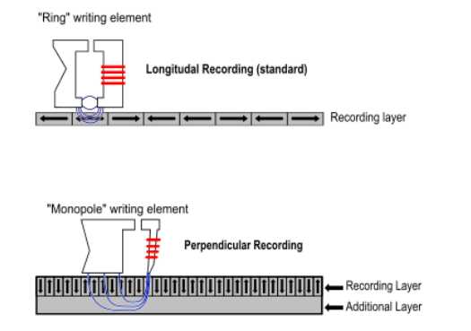

                                  A secondary thing for older and smaller drives it that they use[d] the Longitudinal Recording Method which is less prone to wear related failures than the newer PRM [Perpendicular Recording Method].
                                  - With Longitudinal Recording the 'spots' on the disc are -physically- larger.
                                  - With PRM the 'spots' are smaller -and- the 'free' space between the 'spots' is also smaller.
                                  With PRM the head placement has to be more accurate and that inherently means wear issues are more likely cause problems.
                                  With PRM the charge [on the spot] is also somewhat weaker due to less space to put the charge in -and- as they are also closer together -and- as there is more adjacent area spot-to-spot: they are more susceptible to corruption due to charges 'discharging' or 'neutralizing' each other through the free space.
                                  [This is basically the same magnetic media problem tape media is known for. The charges eventually dissipate with time.]
                                  Not a huge problem short term but if you are in the habit of using drives as deep storage back-up for files that don't get rewritten for ages [overwriting refreshes the charges] then a PRM drive isn't the best choice.
