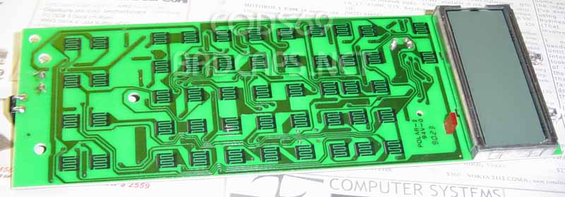

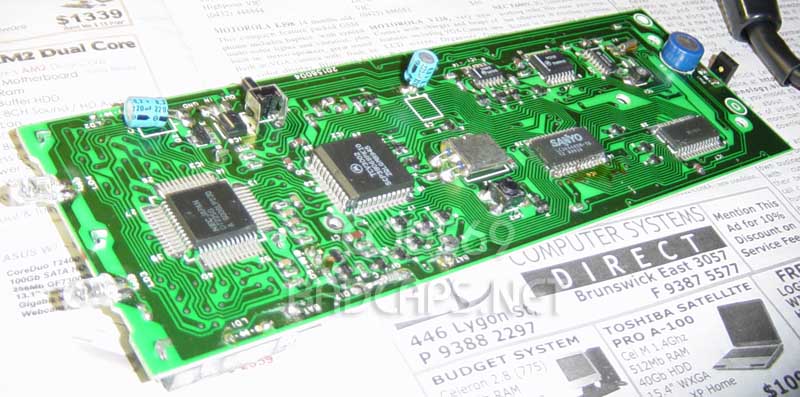

                                I had to post this. The Memorex remote I tested Simple Green on, is now working perfectly.
                                It's a clunky old CP8 Turbo manufactured May '90, but I love its scheduling features. Very handy and reliable for A/V automation.
                                It has not worked properly since about '92 when it had several instances of crap spilled over it. Ever since, it chewed batteries like nothing I've seen and operation was completely frustrating as it seemed like it hung often. The buttons never worked that well after the spills, either.
                                After a good twice over squirt with 1:1 mix Simple Green, sat it for about 5 minutes, then a good scrub with a toothbrush. Dried with compressed air, then air dried overnight.
                                It now works perfectly in every way. It has been operating flat out for a week without a hitch on the same batteries. Even all the buttons work fine now - there must have been a film of dried crap over the button tracks on the pcb.
                                A few pix of pre Simple Greening. Sorry, no post cleaning pictures.
                                BTW - yes, I removed that onboard battery before the job.
                                Note the very hard dried crud near the Sanyo chip. Not all was removed, but it appears it was enough to fix it.
                                IMHO, Simple Green is incredible stuff. Thanks Topcat.
