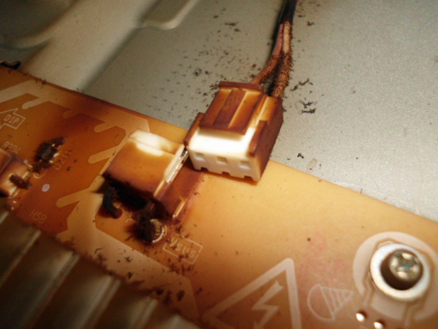

                          Hi Guys , I dont repair computers , I repair TV s , a 3 year old Panasonic 50 inch Plasma has just come in with a poor picture complaint , however there is not actually a problem with the set at all the cause is so much nicotine behind the safety screen you cant see the picture to well, the whole set had to be disassembled to remove the screen to clean behind it.
                          Take a look at the photos this gives a better idea of how bad it is, this is the power connector to the Y sustain board , it would have been white when it came out the factory, the other photo shows the plug disconnected.
                            Yuck, that looks like what my family's late-1990s IBM (Pentium 133) (Aptiva C32) looked like and I cleaned it... My father was a heavy smoker at the time.....
                            Both my father and mother were heavy smokers in the late-1990s and early-2000s.....
