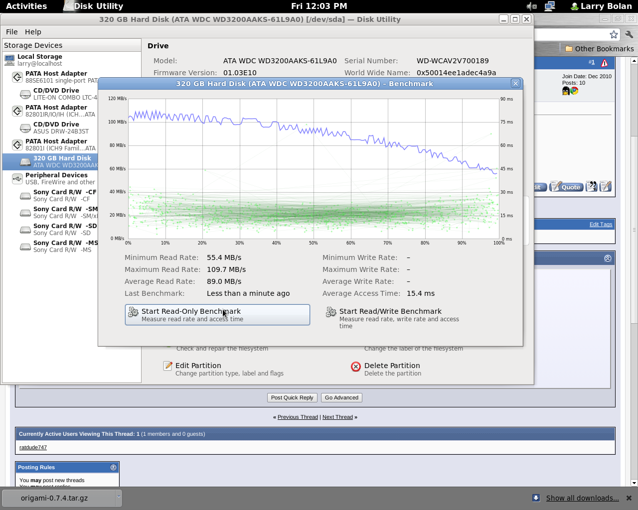

                      • ratdude747
                        Black Sheep
                        • Nov 2008
                        • 17136
                        #51
                        Re: ratdude's main rig mayhem
                        here is a readout of a read speed test on the drive:
                        sigpic
                        (Insert witty quote here)
                        • Scenic
                          o.O
                          • Sep 2007
                          • 2642
                          #52
                          lucky. it's one of the newer ones. single 334GB platter, 2 heads. should run cool and be pretty quick..
                          edit: and you still have warranty till feb 17th 2014
                          if you email WD a proof of purchase, the warranty can be updated.
                          (they calculate the warranty from the manufacturing date by default)

                                    depending on what's on the label after "WD3200AAKS-" you can sort of determine the platter/head configuration
                                    RAID0 with an old 2 platter and a new singleplatter.. hm.. the 2 platter would slow it down quite a bit. (if it is a 2 platter drive.. which i think it is judging by the age)
                                    http://www.hardware-wiki.org/wiki/We...tal_WD3200AAKS
