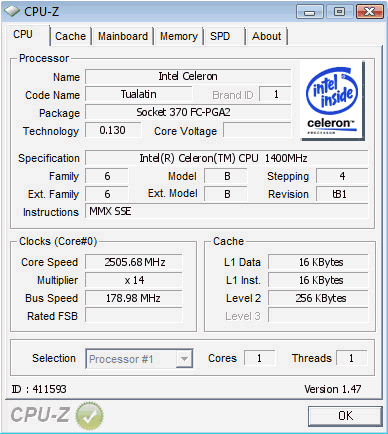

    Re: highest p3 clock speed?
    Originally posted by brethin
    Fastest P3 I know of.
    OK - we are all dying to know how that feat was achieved.
    I have a TUSL-C Asus board that allows me to select a CPU speed, but it overclocks the PCI bus and renders my SCSI cards inoperable.
    I guess if I go IDE I could crank up the speed.
      It looks fake to me, but there were PIII boards with DDR memory and PCI locks. Fastest my dual-PIII board does is 166FSB (1.74GHz) but it doesn't get any further than the BIOS with that.
      I've been long planning to patch a PCI lock into my board, guess we shall wait and see. I have a 3/4 divider so there will be no problem with the SDRAM at 166MHz. Come to think of it, i wonder whether it can do a different divider too, but i'm not sure if SDRAM can work truly asynchronous. I guess i'll bust out a board that i won't cry for if it breaks, patch a clock generator into it and see what happens.

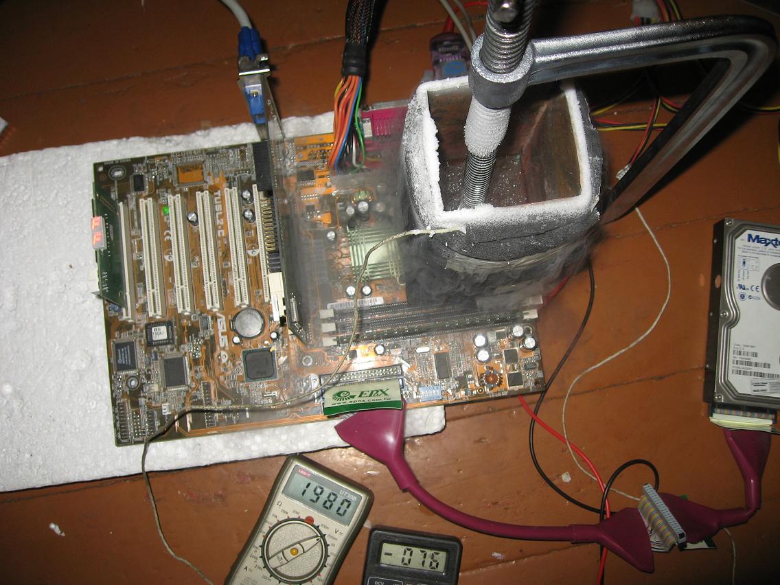

        http://valid.canardpc.com/show_oc.php?id=411593
        Achieved with Liquid Nitrogen cooling...
            He's using Kingmax PC150 RAM.
            - I have a few sticks of that stuff. I ran it in my Athlon Slot A back in the day.
            - Good stuff!
            There was also PC166 RAM but it's even more rare.
            I don't think there was ever an official spec for PC150 and PC166 but they did get manufactured by a few companies anticipating that might be the next step in SDRAM.
            Then DDR came out and they got dropped.
