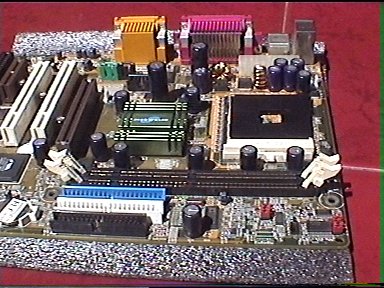

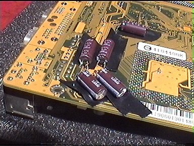

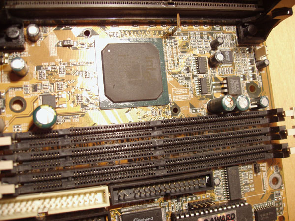

    LOL!
    Running a separate pair of wires for each capacitor would have been better from both an electrical and layout point of view...
    Removing the old capacitors properly and soldering new ones in their spots would have been even better.
    In any case, if the board works, he couldn't have fucked it up too badly... but I don't like the groups of parallel caps on long leads, especially with the thin cat5 wire. too much resistance/inductance, imho, to group all the caps together on it...
    --Randy

      reminds me of chinese firecrackers. We should do a thread with links to the worst cap replacement jobs. there are more
      the translation is funny in places "see how many cap big stomach"
      the thread is titled " in the family has the big stomach husband's mother also does not call" anyway most of it is translated well
      maybe we need to do chinese version FAQ....nah its ok, someone there has the right idea : http://forum.hkgolden.com/view.asp?message=351599

        Dear God,
        What a crap job. It does look like firecrackers waiting to go off. Hopefully he/she did not use it for long like that.

          hanging the caps on long leads esp wimpy stuff like cat5 negates the filtering capability.
          some vrms run at 200+ khz so think rf.
          the rule is shortest leads possible and put the cap as close to the load(cpu) as possible.
          i call it pure crap that cannot possibly work right.

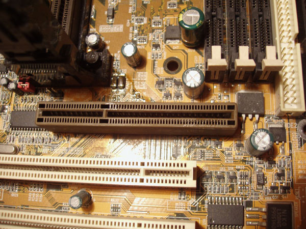

                Not that good but IMHO this MSI board still worth of looking:
                There was a whole can of flux used (you can find traces of it all over the board); some bad caps replaced with non-low-ESR ones (mostly Sanyos), some still there. The board has a toasted FET and it's a "processor killer".

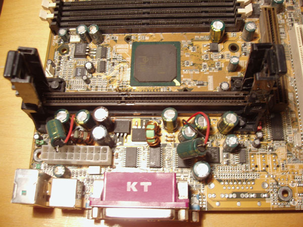

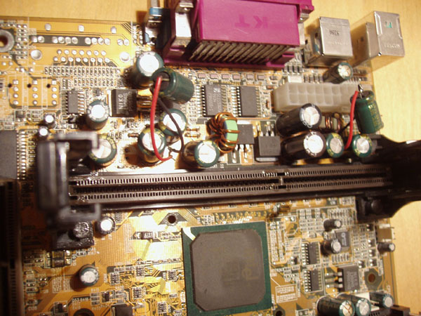

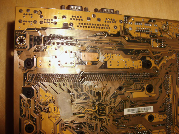

                  hmm.... whew... i think there's another solution if the space is very tight.. just go under... but it need of case modification (motherboard tray)
                  this is my shuttle mv19 (s370)...
                  under pcb: 5 chemicon kzg 1500uf 6.3v 8mm
                  up (in paralel with the kzg): 5 rubycon mbz 1500uf 10v 10mm
                  original caps: gloria 2700uf 6.3v 10mm
                  but it is also a desperate way when you can't find the right value and size of the caps in the first place...

                    yanz......please no more recapping like that
                    yanz and sulbert : can you guys upload images from now on direct to the forum. you manage attachments / upload files and then copy and paste the attachment links in the post and highlight the link and click the image button
                    it is better to have all images on the forum so nothing gets lost in the future. Sulbert i like your links to big images they are great but also include 600px wide attachments direct in the forum.
                      aha.. but it damn works...
                      well, all right i'll hunting more caps...
                      (those mbz are good anyway without the kzg, it works. so i wonder, what is more important -- the ripple current or capacitance? -- i use p3 800eb, but that board should able to handle tualatin)
                      ok, if that's better
