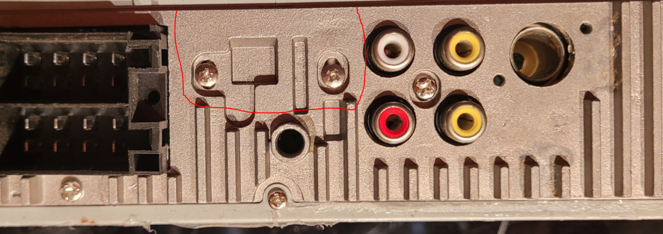

    Just bought a car that has a stereo in, thats bluetooth etc, and powers on fine and all functions seem to work, BUT there is no audio/sound.
    I have tried another unit in the car that works fine, so know it definitely a problem with this unit.
    I know it just cheap rubbish, probably of chinese origin, but its really bugging me just throwing it away and replacing it 🙈🤣
    I know zero about things like this, ans its probably unfixable, or more trouble than its worth, but just wondered if there was anything to check, as what could lead to an easy-ish fix? Havnt opened it up as yet.
    Any help or advice greatly appreciated.
    Pics of the unit attached, although isnt alot to go on unfortunately.

    push a pin into the reset hole
        Just tried that, did it for 1 second, 30 seconds, 60 seconds.... still no sound

          I found the right hole 🙈 had rst written near it

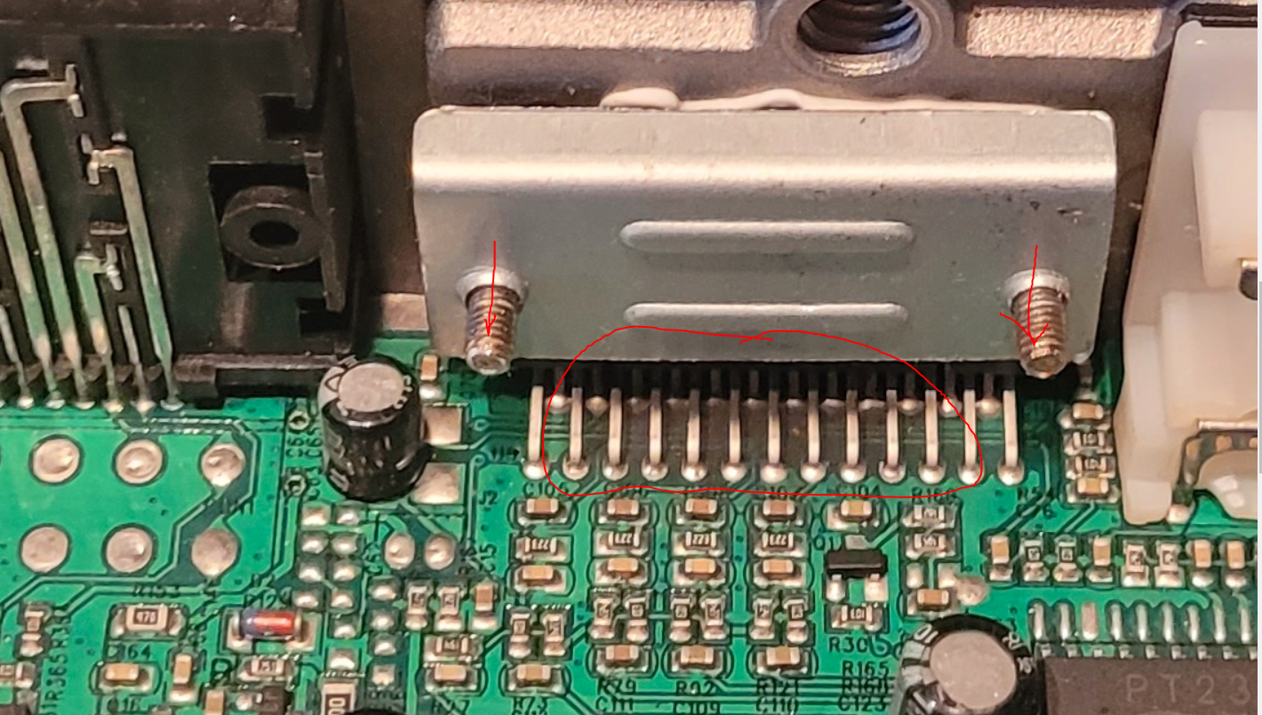

                          In this place behind the radiator there is an audio frequency power amplifier chip, if it does not heat up (cold) when the device is operating, then just change it, it usually costs TDA7388..

                                This is what it looks like from the inside

                                  I have added a picture of the inside,

                                    Unscrew the two bolts, remove the clamping bar and look at its body, it looks like burning underneath, the body may have exploded.

                                      I have done what you said, and yes it was black underneth.
                                      I had a spare basic Citroen CD player, so I desoldered the part out of that, and soldered it into this unit.
                                      It now has sound
                                      Thankyou very much
