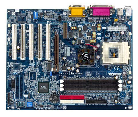

    I have two boards and I would like to replace the wet lytics with
    polymers (where or if possible)
    One mobo (already recapped) has 10 of 6.3V 1200uF Pana FMs
    Can I replace these with OSCON-SEPC 4v 560uF?
    I can alway re-use the FMs I intend to replace in boards where
    wet lytics are the only option.
    The other mobo has yet to be recapped.
    Whereas the above (1st board) is a reference design, the next and newer
    mobo has less caps on it (as usual). I intend to follow the recap
    method for the reference mobo even so, as it has the same silk
    screen as the ref design.
    In fact, I have another three boards which I keep as spares
    and if ok to replace with poly's - will do these boards as well.

    you can measure the voltage across the caps with a multimeter while the board is running.
    i dont see the point to recap with polymers except on vcore and vdimm out.
    the general guideline is half capacitance is ok for polymer. in the case of vcore and vdimm out 4v is fine and used in practice on many boards. sepc will be excellent.

        board specs say :
        vcore 1.5V/1.525V/1.55V...1.85V
        vdimm 2.5V/2.7V/2.9V
        As I understand it, they use +5V for VRM in these designs
        which is why to be careful where to put the caps, not on the input

          Y - if I have read this correctly,
          the Input side has 4 of 10V 1200uF right beside the MOSFETs
          thx

            it appears so but the GA-7DXR has strange layout. make sure to measure with multimeter prior to replacing with lower capacitance.

                  Well...
                  I have recapped the board, the GA-7DX+ as follows;
                  Replaced 4 of 3300uF 6.3V GSC with 10 of 560uF 4V Sanyo OSCON-SEPC
                  As Will stated, I have gone along the lines of the half capacitance method
                  or thereabouts, 10 of 1200uF = 12000uF (see below), 10 of 560uF = 5600uF.
                  In the ref. board GA-7DX+, there was 10 of 1200uf 6.3V GSC
                  So... the silkscreen and mobo layout is almost the same with both mobos.
                  As you surmised, the VRM is a two phase design and the input
                  is powered from the +5V rail (it is an old board but newly used) not
                  the +12V rail.
                  The I/P side of the VRM had 4 of 10V 1200uF GSC on the GA-7DXR
                  The I/P side of the VRM had 3 of 10V 1200uF GSC on the GA-7DX+
                  I replaced both mobos with 2 of 10V 1200uF and 2 of 10V 1500uF Pana FM
                  Obviously, the O/P side of the VRM and VDIMM are powered (now) by
                  the SEPCs.
                  Also, I replaced all of the 25V 330uF caps with Pana FM 16V 330uF.
                  These are obviously for the +12V power to the mobo.
                  If this is a particular problem, then it may be, I will have to replace the
                  560uF SEPCs with a higher capacitance value. As I have recapped it,
                  I do not like the prospect of taking the mobo out again for more recap
                  work.
                  BTW, the VIA Hardware Monitor v2.05 still reports VDIMM being too low,
                  this is reported as being between 1.07 and 1.09V
                  I'm going to measure it as time suits just to make sure
                  Is there anything else I should be aware of?

                    looked like 3 phase on gigabyte site
                    sorry i should have said that it would be "experimental" mod.
                    what is happening now? did you stress test ok?

                      Re: Polymer Replacement Issues
                      Thx all
                      I should issue apologies.
                      Y - I am blind, just as well as I am getting new spectacles (y, really).
                      It is a 3 phase design - this is obvious from the pic and it is so
                      on the board. You can also see, the cap decals around the CPU
                      and beside the DIMMs, these are replaced with the SEPCs.
                      The I/P side of the VRM are beside the modem slot - in this pic, 3 are populated
                      Sorry - for the confusion
                      I am actually using this board to make these posts
                      Y - I have yet to stress test the mobo - will do with Prime95
                      Will report back results in due course
                      Thx again

                        one solution to the lack of bulk capacitance noted by the naysayers would be to increase the capacitance heavily on input side. this would be quite interesting and yes experimental
                        do you intend to overclock the board? such experiments could be validated well if results before and after could be compared.
                        i dont believe the stress testing with prime95 would be a final validation though although it would certainly be useful, in respect of the reduction of capacitance you really need to heavily load the cpu and then idle repeatedly because this one of the functions of capacitors to support the cpu in load transients, not only for the smoothing function which is probably served better by the sepc.
                          Y, Will
                          That is what I have done.
                          The ref. board (GA-7DXR) has 4800uF on the I/P side of the VRM.
                          I have replaced this with 5400uF 10V Pana FM on both the ref. board
                          and the GA-7DX+.
                          I have conducted the first hour of Prime95, which test if the
                          software is working properly. The board has stood up to this
                          with no problems.
                          Of course, further testing will be necessary.

                              Just to report back on progress with this experiement.
                              First, all things seemed well...
                              Over the last two days however, the mobo has had problems
                              starting.... It will power up ok, just has problems posting.
                              However, if I use a hard reset after a min with the system powered,
                              it will POST.
                              Symptom - I suspect the polymer replacement capacitance may
                              be a problem as has been suggested by others.
                              I have reviewed the OSCON SEPC datasheet and have found,
                              1. The 560uF 4V has an SV (service voltage) of 5.2V
                              2. The 820uF 2.5V has an SV of 3.3V - these would still be suitable.
                              So... I may want to raise the VRM O/P capacitance from;
                              1. As it is, 10 x 560uF 4V SEPC (5600uF) to;
                              2. As it originally was, 10 x 1200uF (12000uF) 6.3V Pana FM or
                              3. Raise the SEPC to 10 x 860uF 2.5V (8600uF).
                              If I pursue the latter I will require to source SEPC at 860UF
                              Where might I be able to get these?
                              Of course, it may be an alternative problem.

                                Regarding your problem, i think it could may be the very low ESR of the Oscon which could cause this start up issue. Still only a guess but may be this VRM can`t handle the high inrush current.
                                But sure, changing some of the caps may be one at any phase with an larger Lytic capacitor should proof if the issue is due to low esr or low capacitance.
                                May be you can just solder an additional lytic at the bottom side of the pcb, i mean in ghetto style ;-) just to check this out.
                                If the issue would be solved with a few more capacitors, it is an capacitance, not an ESR problem.
                                  how come first it was ok now its not
                                  does not compute
                                      Just some update info
                                      Started to lose BIOS settings, changed old BIOS battery with new one.
                                      Also, as I used CrystalCPUID to set the mult of the Barton XP-M to x15
                                      It implemented an overclock of 0.52%
                                      see further
                                      https://www.badcaps.net/forum/showth...2&page=2&pp=20
                                      The RAM in situ at a stock CL of 2 by SPD had a max speed of 133MHz.
                                      The slight overclock raised the FSB above this maximum.
                                      In turn, I manually set the CL to 2.5 in the BIOS which sets the max FSB at 143MHz to accomodate the speed above 133MHz..
                                      Q - Is it possible the software setting of the multiplier to x15 with
                                      CrystalCPUID so far as it has raised the FSB etc has marginally raised
                                      the voltages and other frequencies out of specification?
                                      I will need to get a readout of these with a view to modifying them,
                                      where or if possible. Any good utils recommended?
                                      I've attached the dump of CPU-Z and it can be seen the effect of
                                      changing the CL from 2 to 2.5
                                      Ideally, I would simply lock everything to the stated speeds.
                                      So....
                                      FSB would be certain to be 133MHz
                                      DDR would be certain to be 266MHz
                                      PCI and AGP would be 33 and 66MHz respectively
                                      Same for the voltages
                                      Thanks (again)
                                        0,52% overclocking is nothing at all: this is due to fsb tolerance (1 or 2 MHz on 133 is something like 2%, almost negligible).
                                        I don't like overclocking: if you're careless, there are chances breaking something; moreover Athlons XPs were quite good at overclocking but heated a lot: mainstream liquid coolier were launched for Athlons and P4s.
                                        Remember: if you rise fsb, the gain in bandwith should at leats be equal to loss in memory latence. Programs should run at same or higher speed to justify an overclock.
                                        If you really want to, try something like 5% at first: overclock fsb from 133 to 140-142 MHz, set CAS latence from 2 to 2.5 or even 3 and lover cpu multiplier from 15 to 14. You should obtain a near standard cpu frequency (142 * 14 = 1988 MHz vs 133 * 15 = 2000 MHz) which doesn't pose a heat issue at all and you have an higher memory bandwith. Test your ram with memetset86+ for long (say 5-6 cycles after any fsb change) and revert to last stable fsb value when you get a memory error; then you can check performance improvement with SuperPI or other cpu benchmarking tools.
                                        I think you should afford a 10% oc with standard voltages: increasing vcore or ram voltage more than 6-8% is never reccomendable because it increases heat and shorten chips lifespan (increases electromigration, so chips are unstable: they require an higher voltage to be temporary stable again, then are newly unstable; this degenerative process ends only with components death or irreversible damage).
                                        Keep in mind: overclocking higher than 15% requires additional cooling and better equipment in most cases; moreover, extreme oc lasts for very small time (few hours) while your goal is having a rock stable plattform for months or, better, years.
                                        Enjoy your hacking
                                        Zandrax
