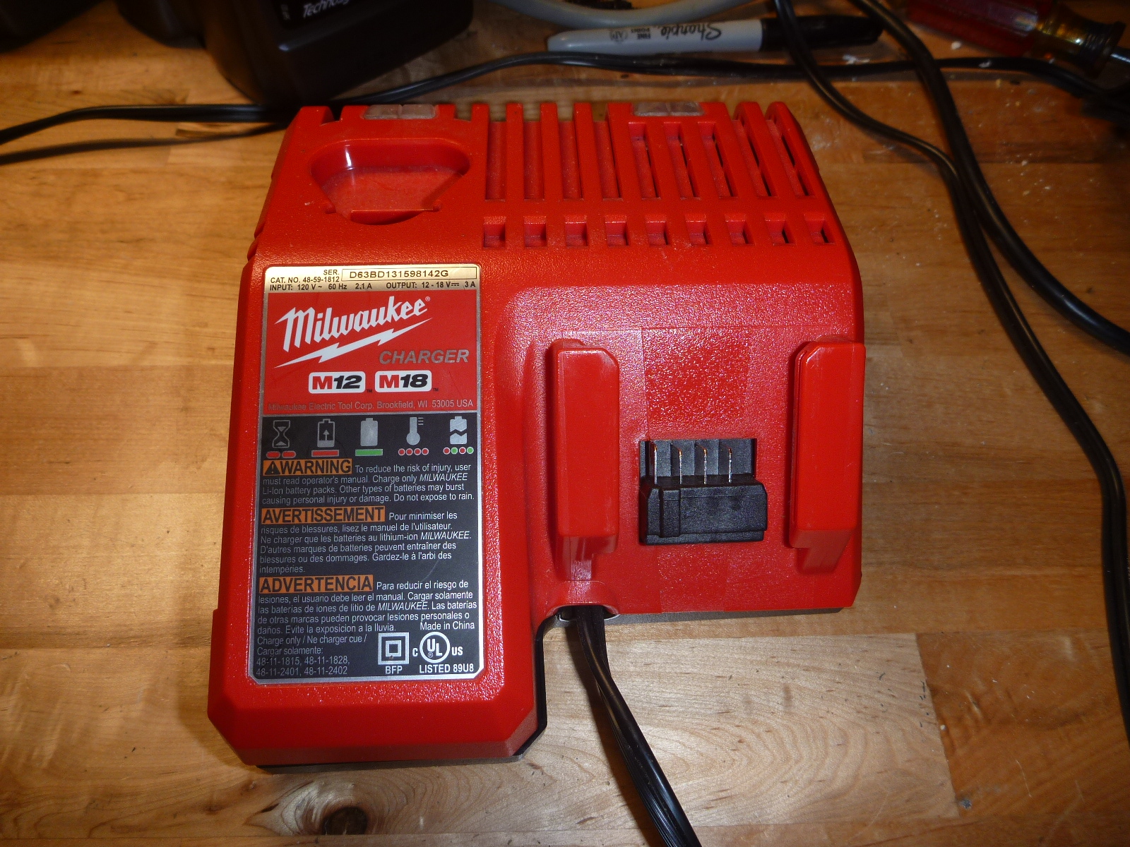

O Milwaukee, you wound me.
  • WeaselXP
    • Oct 2015
    • 107

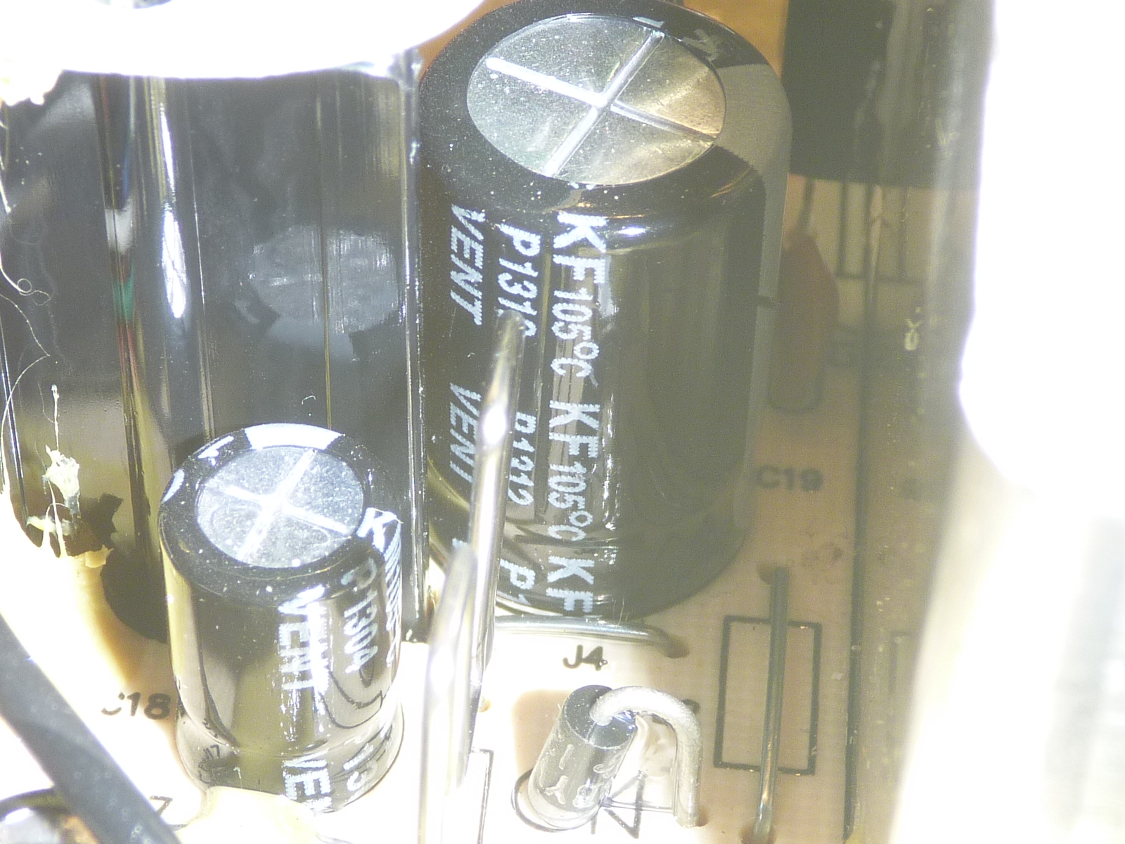

    They said you were reliable and tough. They said you were the best. I kept you around, never knowing the real you. Today, I found you out. Beneath that tough exterior was something common and cheap. I was forced to make some drastic changes...

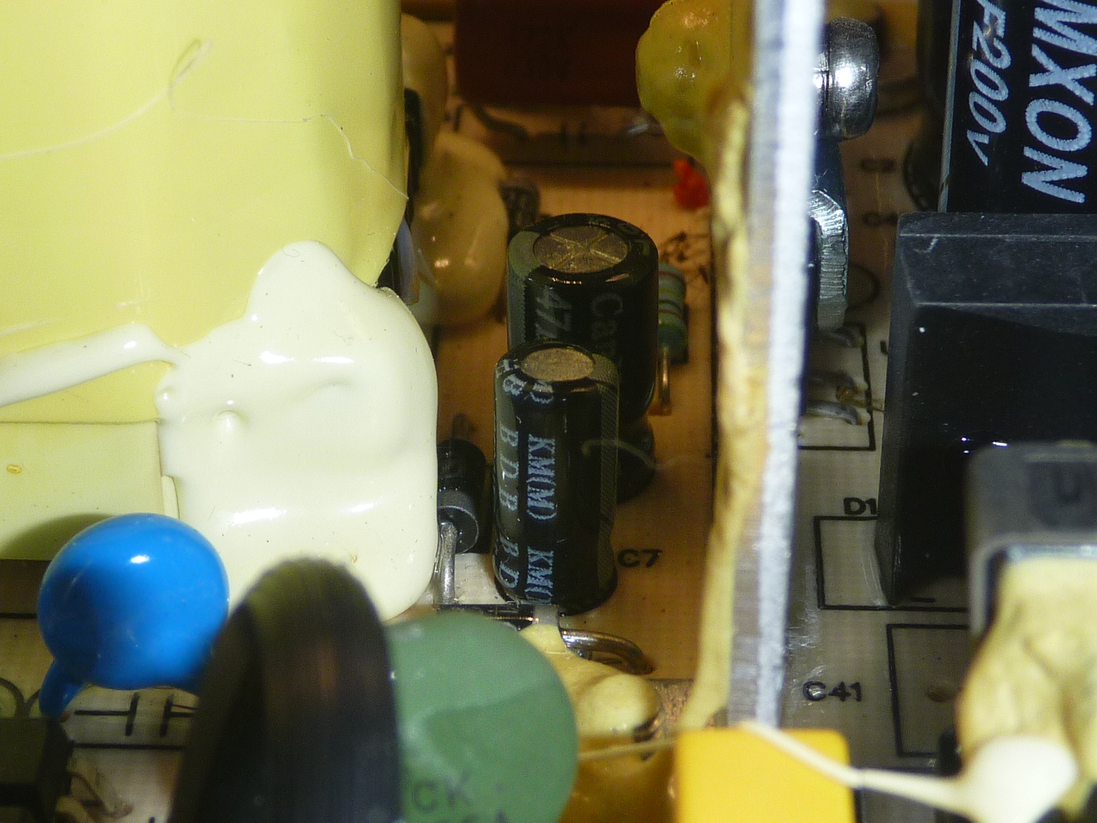

    Re: O Milwaukee, you wound me.
    Whats the problem? You buy expensive drill, not expensive charger.
    Besides, even if you do heavy daily work, which you most likely don't, you use it how long, 4 hours a day? Thats gonna last a decade with any caps.

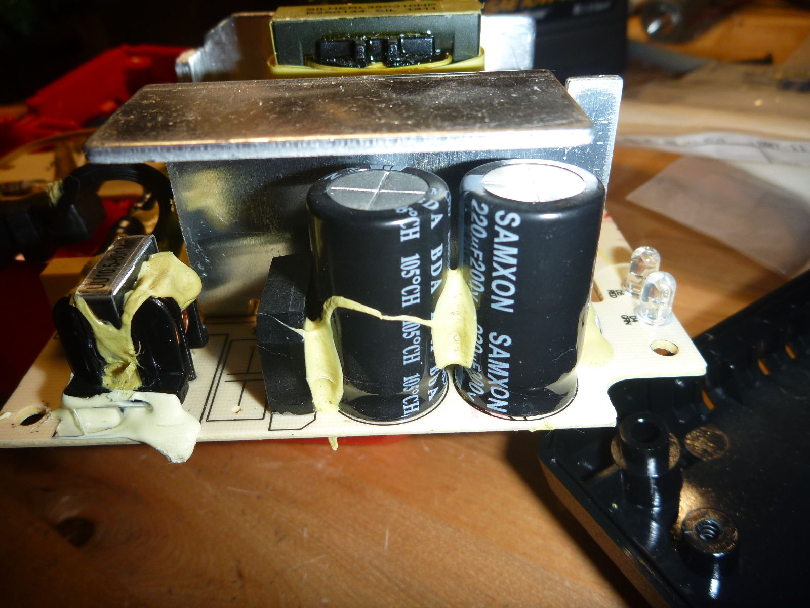

      I buy capacitors from you and then you treat me like a cheap hussy. I see how it is. I left the Samxons in place.

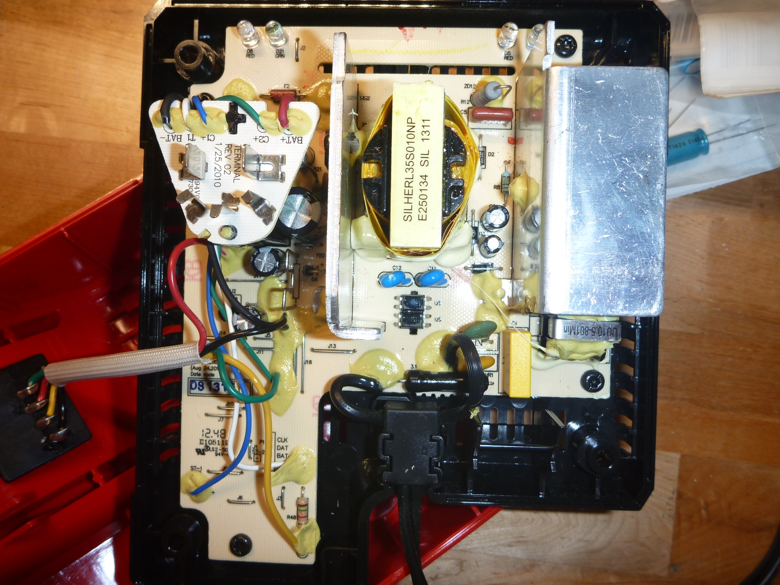

        No, I wonder what do you expect from that. These chargers "do" survive a decade, actually, they usually survive much longer than the drill (or longer than it is economically sensible to buy new battery packs for the drills). There is not too much stress put on them (couple amperes of current), they are used very occassionally, so every single manufacturer makes them as cheap as possible…does it surprise you? Makita, Milwaukee, Hitachi, Narex and many others, every single one of them is the same.
        If they do go bad, they usually cost reasonable money…and are unviersal these days (for most packs of that single manufacturer), compared to those Li-Ion packs. Expensive as hell, they drop like flies and with NO chance for renovation. Good ol' Ni-Cd packs you can renovate always. Not anymore in EU! Introducing new Ni-Cd cells is completelly forbidden since october so we run out of stock and than we are fucked. Panasonic stops making them and we can only smuggle chinese crap afterwards (but there is no sense in that).
          I expect that I now have a charger with better ripple current handling, superior filtering and better shelf life at very little cost over the common off the shelf units. Maybe. Either that or I just enjoy recapping.
            I guess Cause batteries don't mind some ripple, if it's not too much…

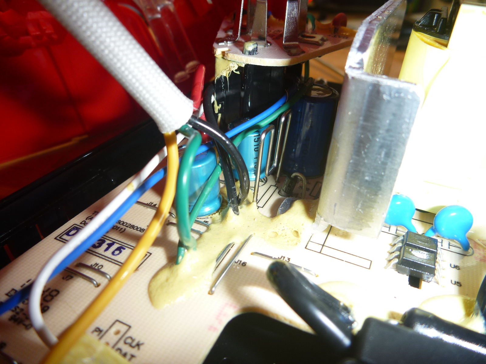

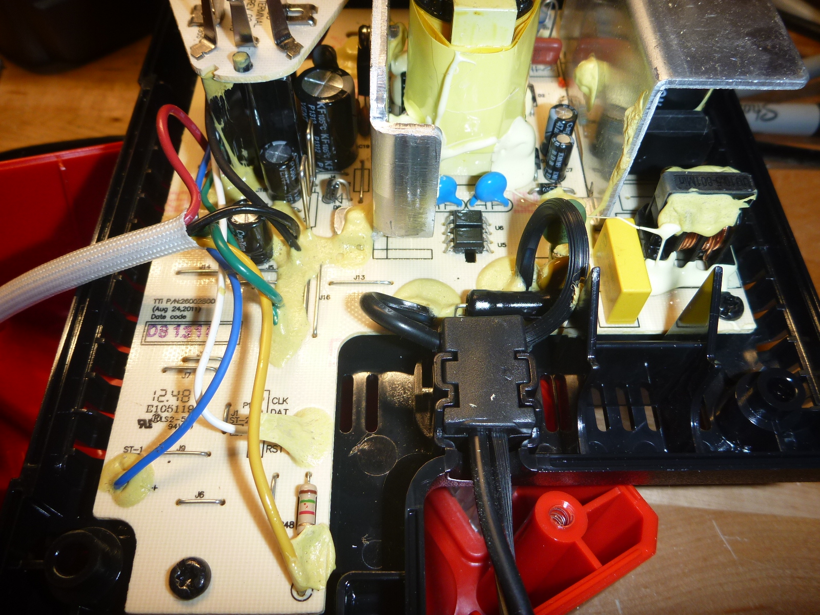

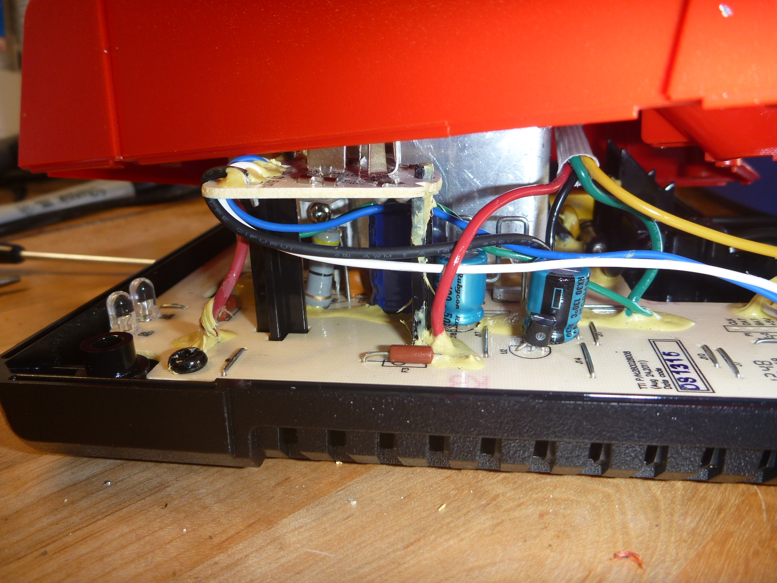

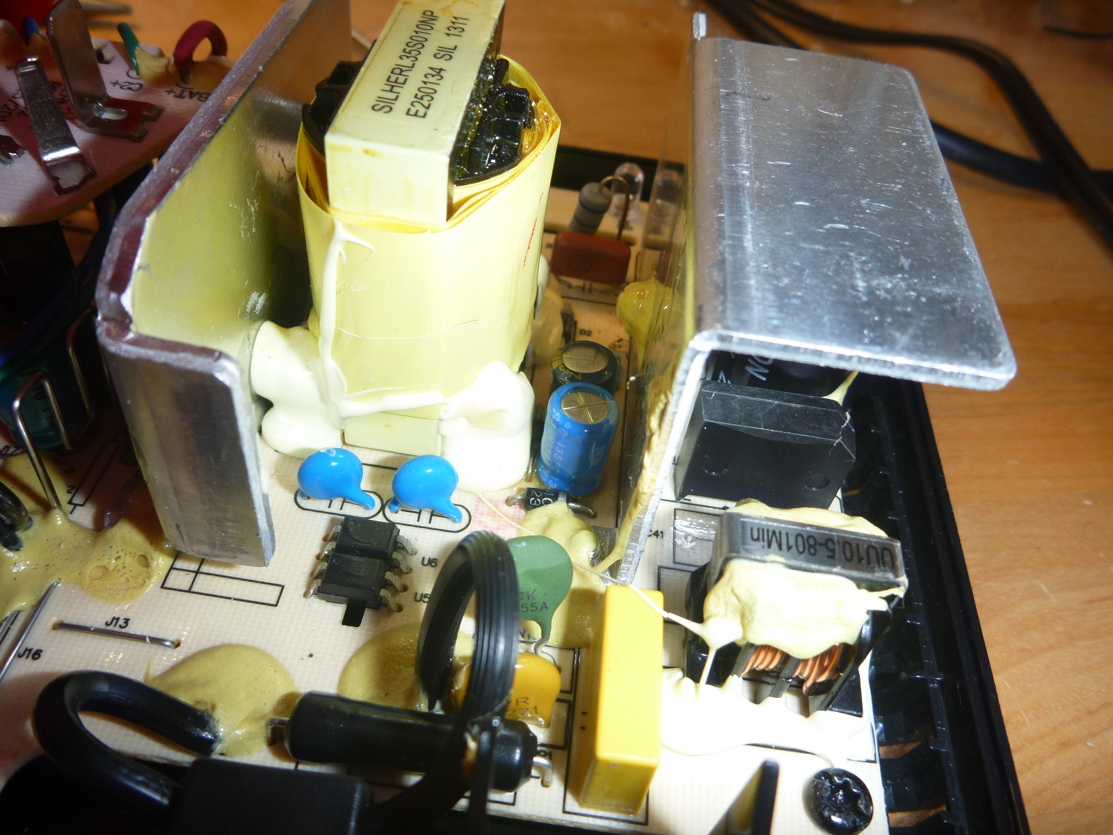

              i'm with Behemot on the caps.
              what i dont like is all the yellow glue that will go brown, and the captive single-insulated mains cable.
                Again…in this case, it will see so little operation time the glue will take decade to go brown. If it was working 10 hours a day than yes, it would be concern…
                    the glue is the real concern.
                    have rebuilt a few of the li-ion packs,a ton of the nicad but dont recall any charger failures.
                                  hu?
                                  After reading the thread title I was expecting something awful. But what I see on those pics looks like a fairly decent powersupply with fairly decent caps as well - and the 'hot one' reasonably sized as well (10mm at least, maybe even 12mm diametre)...
                                  But CapXon? c'mon...
                                  There is a bunch of things out there that is much much much much worse than that. The KF is somewhere in the middle of the cap range, not great but not total garbage either...
