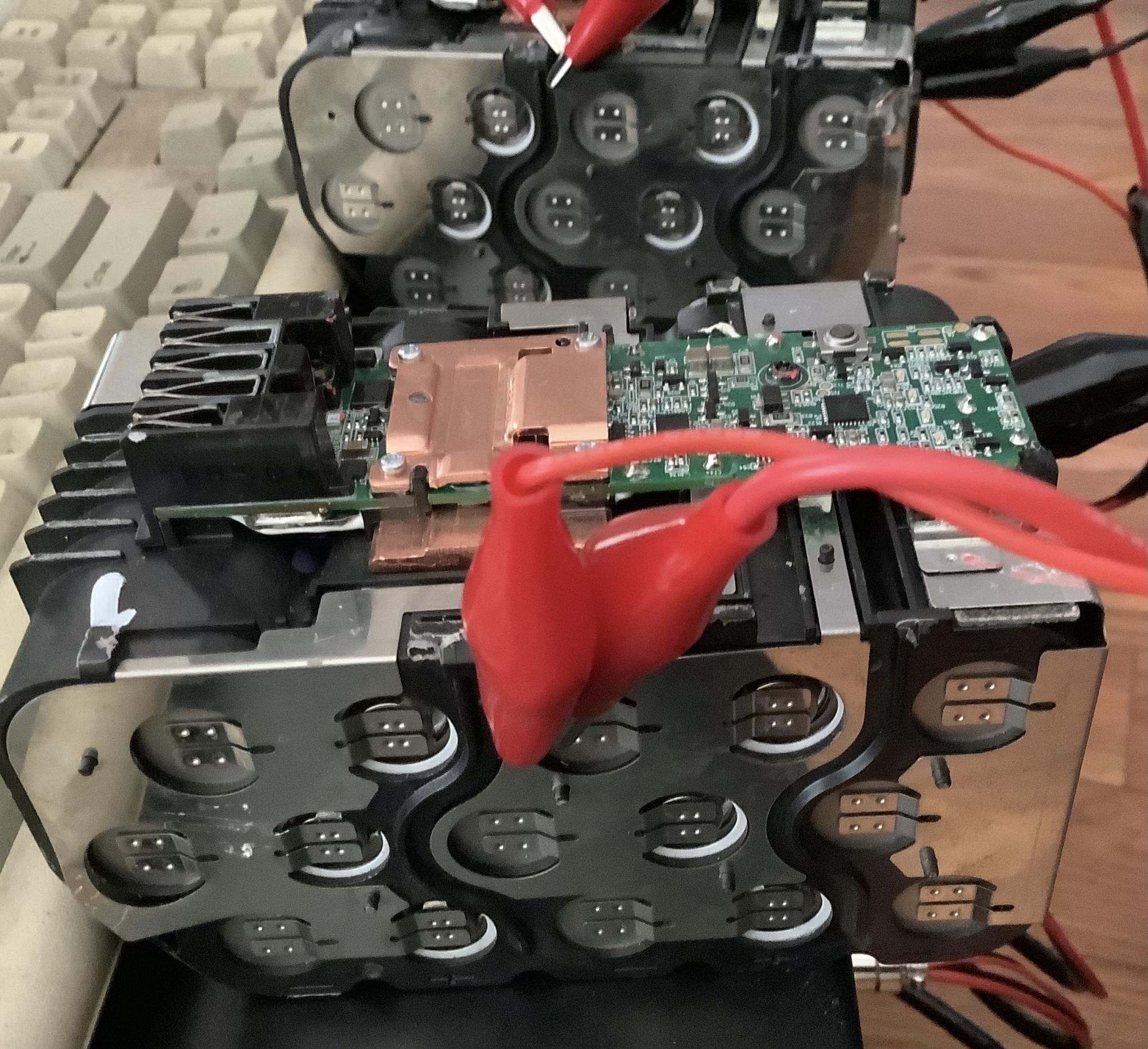

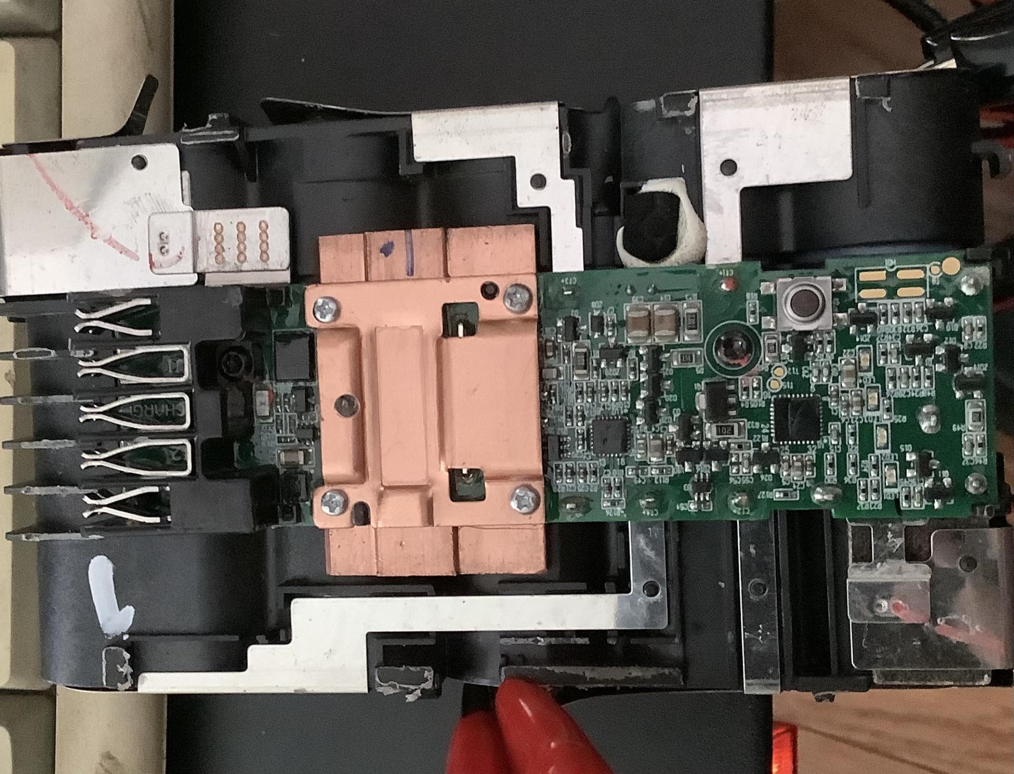

    I have two Milwaukee 12 amp hours battery packs that have an issue with battery cells very unbalanced these are probably over 4 years old and been heavily used in the past but now get occasionally used heavily and when I went to use the grinder tool the battery lost battery battery power very quickly so I decided to open it up and found some battery cells voltage from 3.6 to 4.1 no wonder the battery charger was not fully charging them 3 out of 4 LEDs were on meaning that it was only 75% charged
    So I have put them on the battery testing machine to drain each battery cell down to 3.0 volts and let battery charger for the tool do the charging cycle again and see if it will fully charge this time around or if not then I will hunting down replacement battery cells that high amp battery cells made for power tool
    Because these battery packs have really gone up in price I have only bought one new battery pack because of the price
    Home Depot in the past has had a special buy where you get two battery packs
    For what I paid for one battery pack that I bought today
    The 12 amp hour battery pack is the most expensive battery pack that they sell for the Milwaukee
    Yes I could have bought the 6 amp hour battery packs but even these do not have a special buy on these either come to think of it only the M12 battery packs are the only one that they have the dual battery packs special available right now I buy another set because they have a tool except tax free week in Florida this week so I might just take advantage of this

    Well on one battery cell grouping the amp hour rating is going to be very close to 12 amp hour but the other battery cells are coming in at over 5.something amp hour so lets see if discharging to 3 volts and letting the tool battery charger recharge the battery pack and see if it improves or not
    But it the same exact thing about 3.6 to 4.0 volts voltage range in the second battery pack as well
    At this point I do not know if these battery packs are to still be any good and are just showing there age

          I have one group of battery cells that I have to bring down to 3 volts and then put it on the power tool charger and let see what happens when this

            the BMS boards are all crap - all of them including milwalkee
            they dont actually balance anything, they just monitor the state and stop charge when they go out of balance.

                I answered the question about discharging the battery cells down to 3 volts and letting the Milwaukee battery charger to recharge the battery pack
                Unfortunately it does the same exact thing again it only gets to 3 out of 4 LEDs lights up some of the battery cells are not working correctly anymore so it time to dismantle the battery packs and put new battery cells in them
                I did not have much hope for this to really work but it was the simplest thing to try first and I now know the answer to this question of weather or not it would work
                STJ in the description of these after market Milwaukee battery pack board plastic case battery holder plastic case dose it say 21700 batteries holder in it does not mention what size that they take
                So I suspect that they are the 18650 battery holders which I did find out from a YouTube video that the HD12 amp battery pack does use the 21700 batteries in this series

                                  I did manage to get the battery pack to fully charge the battery pack but only after discharge one group of battery cells because that group of battery cells were 4.1 volts and the rest of them were 3.6 volts so I discharged that group to the same exact voltage so then the hole battery pack completely charged up
                                  So let see if when I use it again if I have decent run time or not

                                        Well an update to weather or not both battery packs were able to be fully charged the answer is yes but now I have to see how much this has effect the running time for these two battery packs
                                        One thing may have contributed to this issue was that these two battery packs sat idle for a couple of years before I put them on the charger and this is not surprising that this has happened
