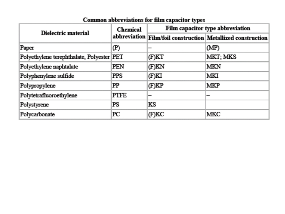

    I have a bad cap on a pcb that simply reads
    A/
    0.68/10
    250v
    1.70MKR
    What shall i replace it with ?
    250v 68000uF ????
    i dont think its aluminium either.

    That is 0.68 uf which is 680 nano farad or 680000 pico farad /10 = 10% tolerance
    Most likely a film capacitor

      1.70 is Metallized Polypropylene
        Re: What the hell is this ?
        Make sure to use the same type, especially if it is used in high frequency high pulse current circuits.
