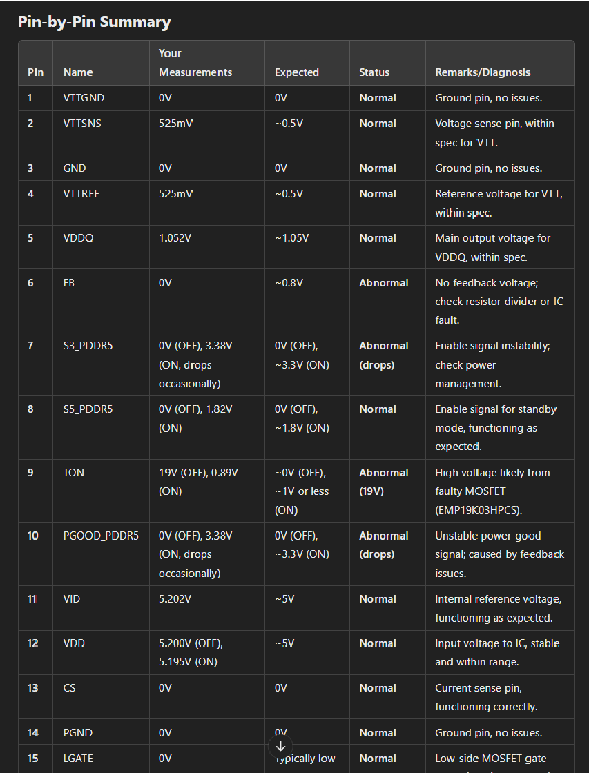

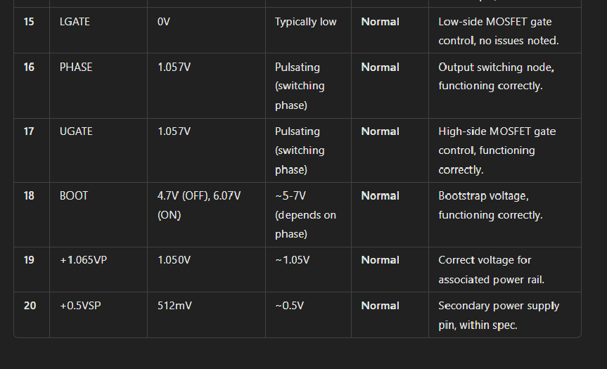

              Hey mcplsig, is it possible that the pin8 1.8v is normal?
              i tried to analyse the PUM1 RT8231BGQW_WQFN20 datasheet through chatgpt , and i provided it with my own manual measurements on each of the pins, and considering i have LPDDR5 ram, chatgpt says 1.8v is normal voltage. is this an error on chatgpt part?
              this is the table the chatgpt provided me with for each of the pins, with my own meassurments and what should be expected

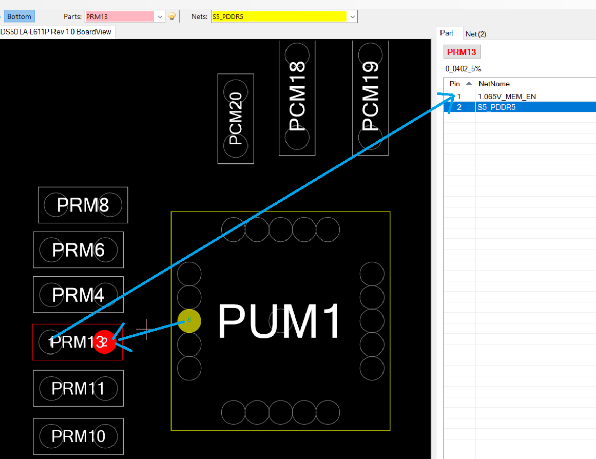

                  here is a screenshot of the PIN8 S5_PDDR5 of PUM1 which connects to the PRM13 0_0402_5% on pin 2 and the Pin1 of PRM13 is connected to the 1.065v_mem_en network.

                    NO pm received from you. You can post the boardview in schematic section and link it here.
                    PRM13 is 0 ohms? Voltage on both sides of it is same 1.8V?
                      yes its 0hms and voltage is same on both side, i manually measured it.
