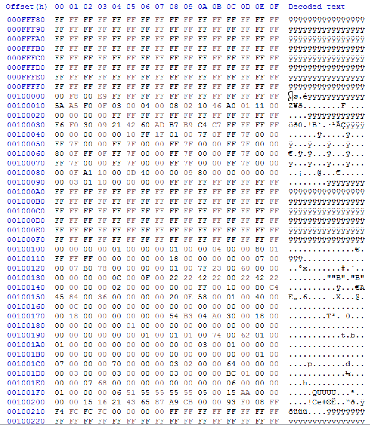

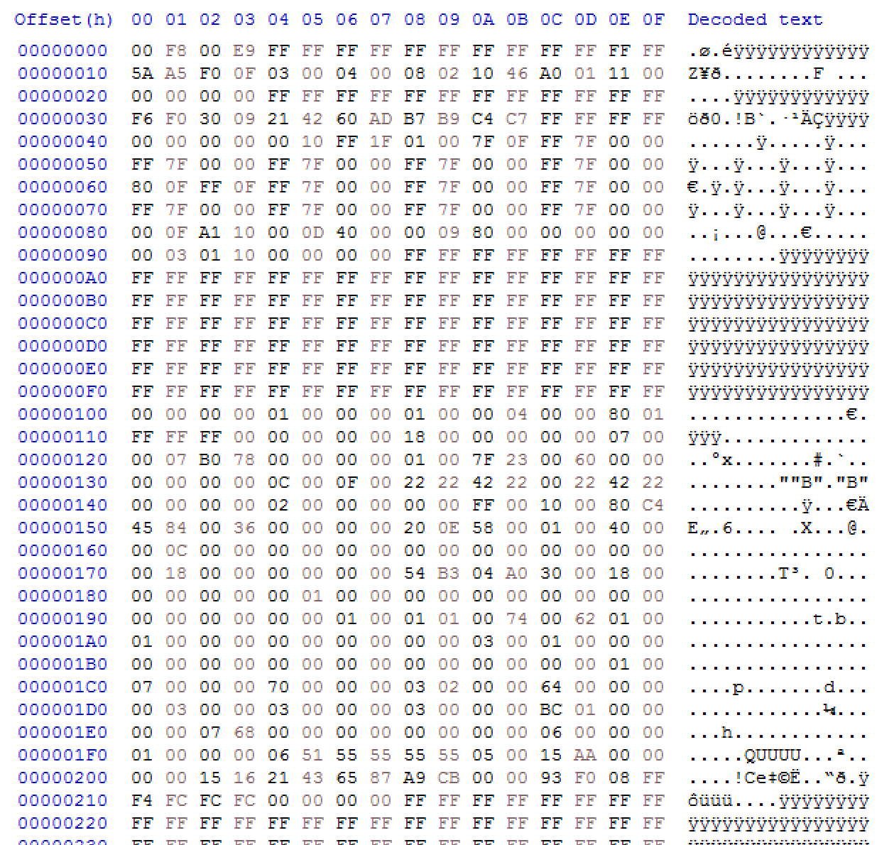

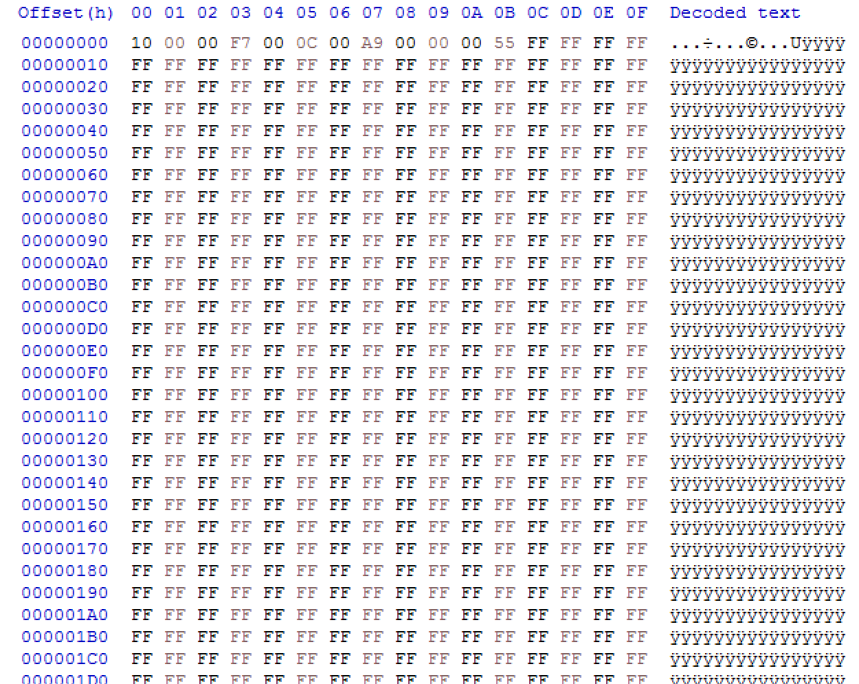

    I am trying to enable undervolt and disable me engine. I read the bios from 2 hardware programmers and FPT. Inside FPT, all looks normal. From the HW programmers, the Flash Descriptor is shifted, nvram is encrypted? or missing and LNVSEC thing isn't visible. I thought my programmer was broken but that seem to not be the case..
    Hardware Read Header
    Hardware dump header
    Normal header with FPT
    FPT header.
    Hidden header at 0x100000
    Moved Header
    FPT of course will not write the bios region despite not being read only and no nvram editing tools can write on live system.
    Is this the end of bios mods ? Anyone see a flash like this before ?
