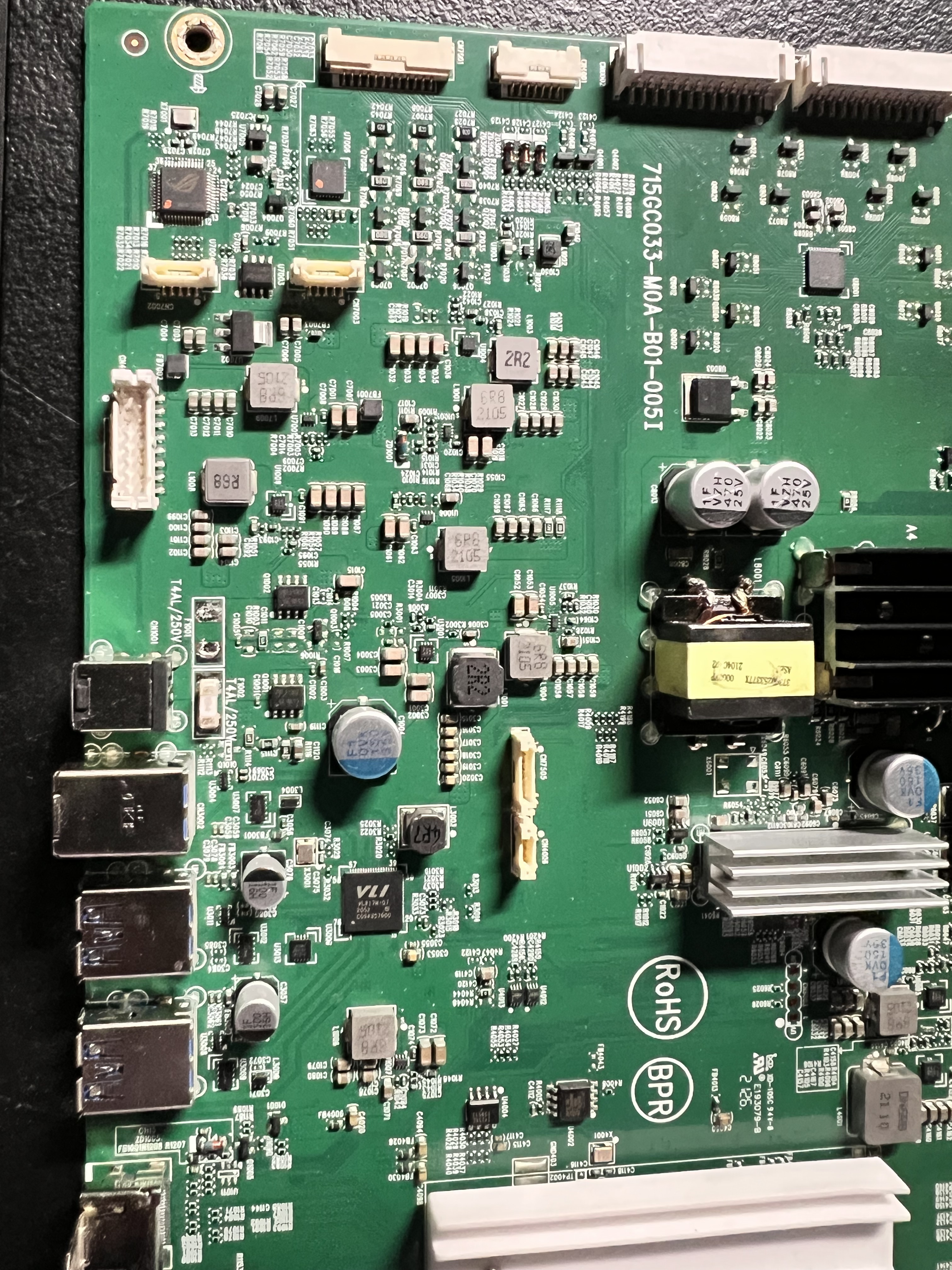

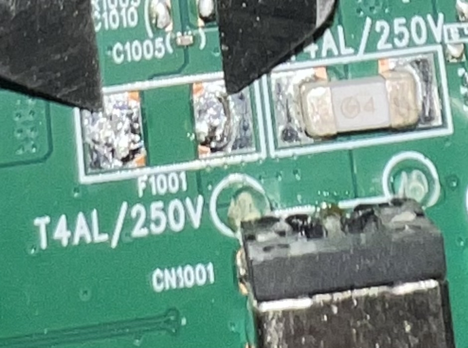

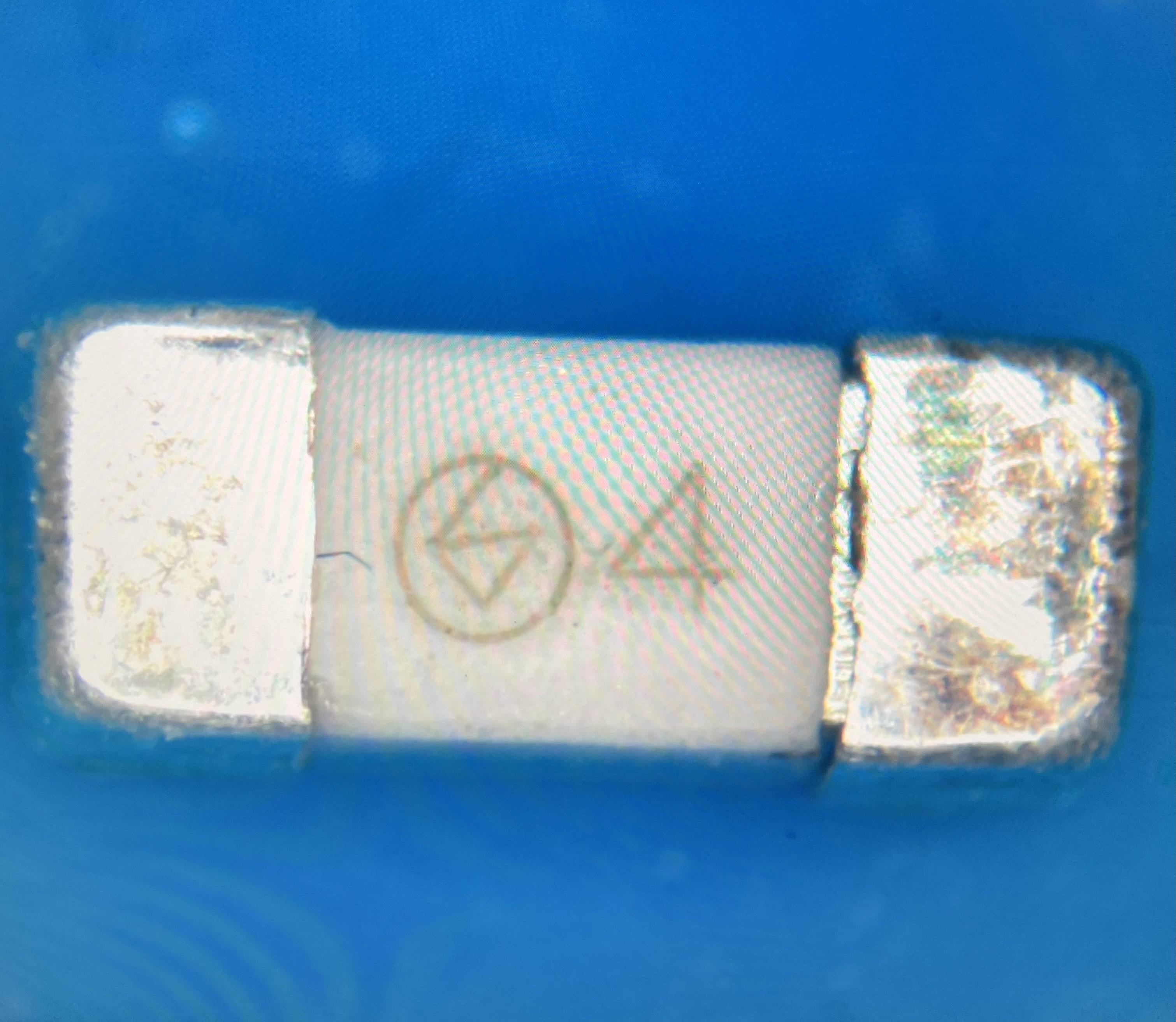

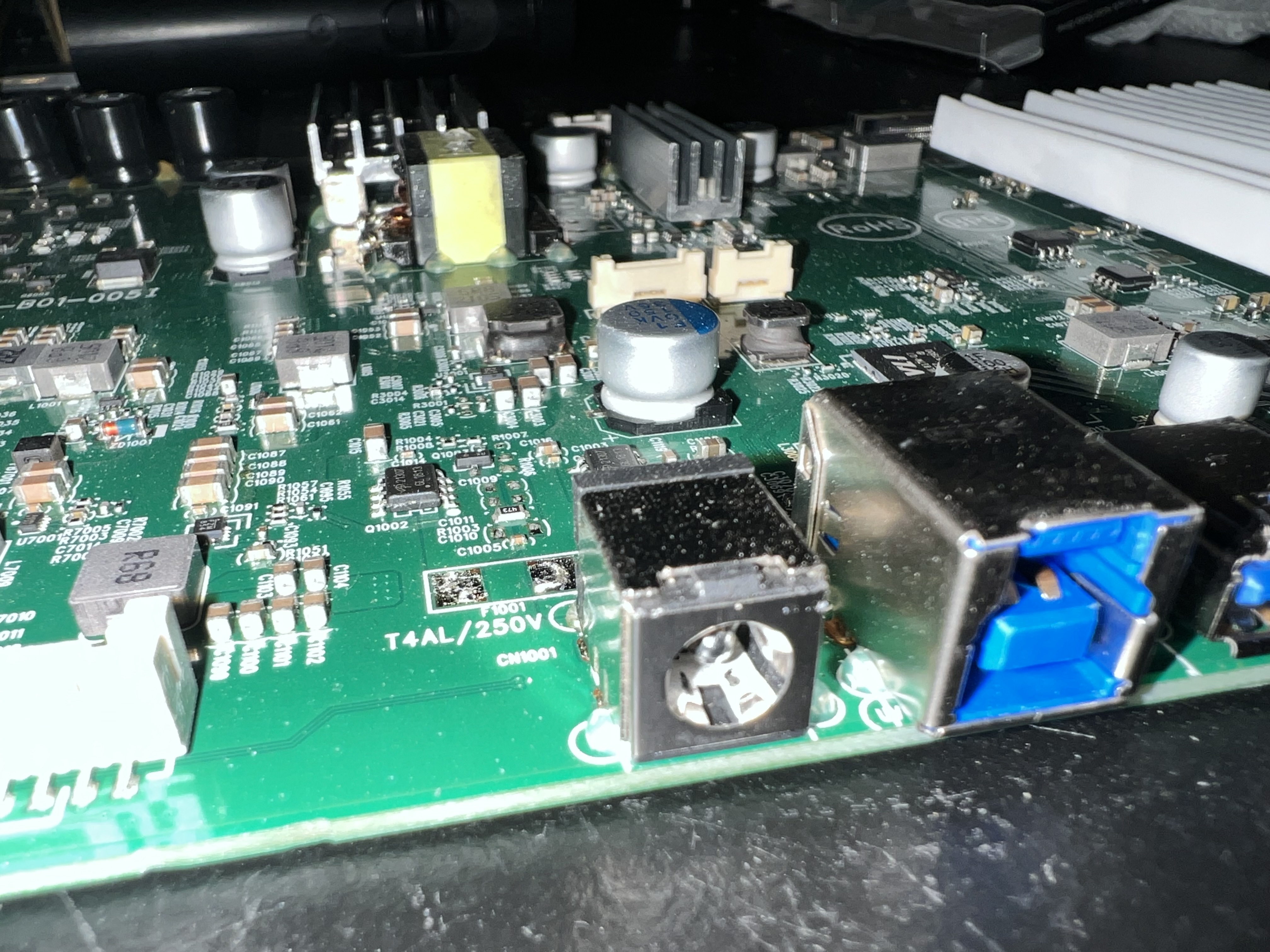

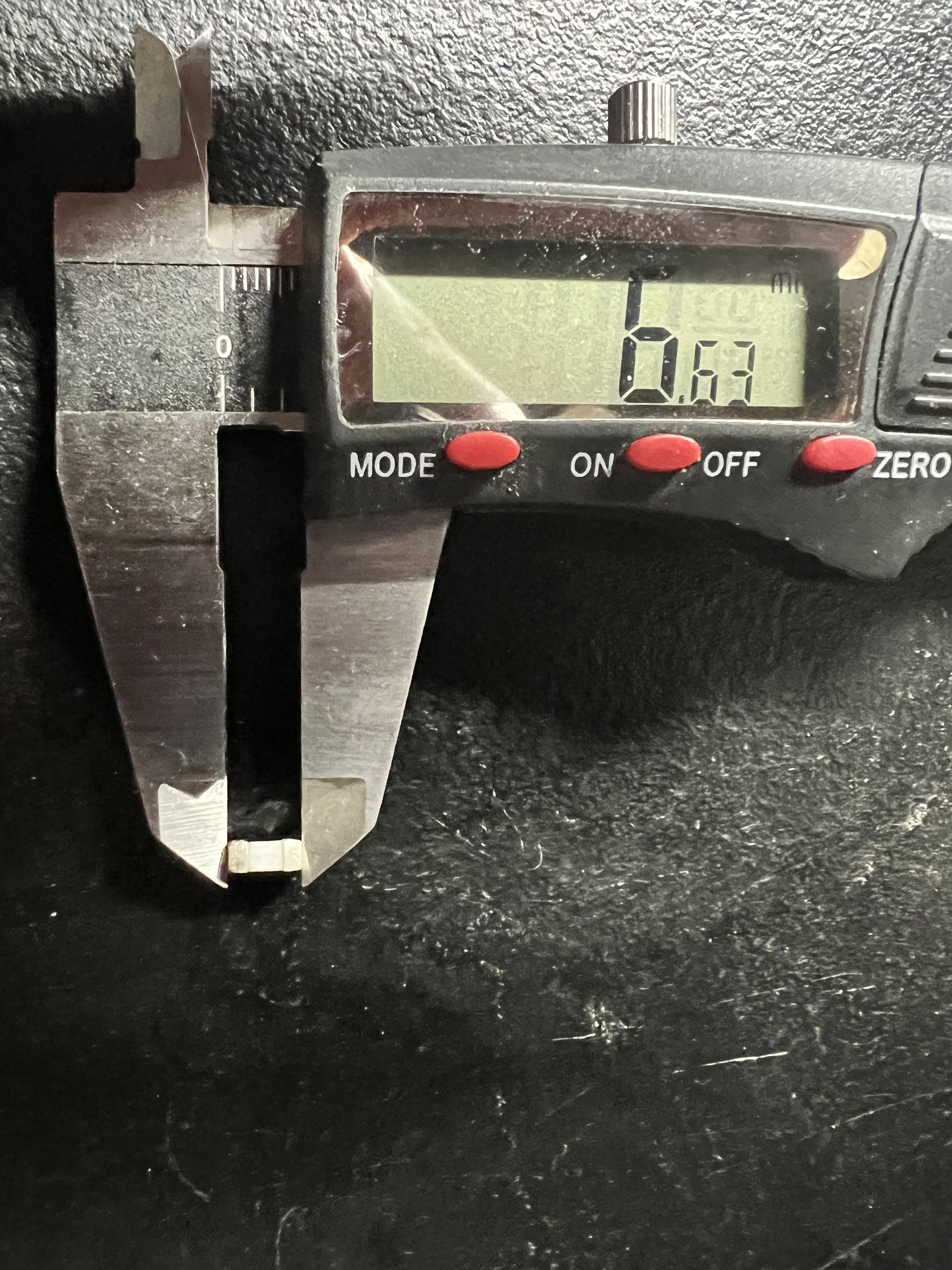

I've got a Monitor that's not showing any video, and I found this blown Fuse. As you can see from the photos, the board location has T4AL / 250V. Any assistance is greatly appreciated. Thanks!
Looking for a Fuse T4AL/250V
4A time delay 2410 (6125) package
This one for example from mouser
https://mou.sr/3HAKPvQ
Or this one https://mou.sr/3SUW2cZ
As lotas says, check what caused the fuse to blow, you may have something shorted after the fuseComment

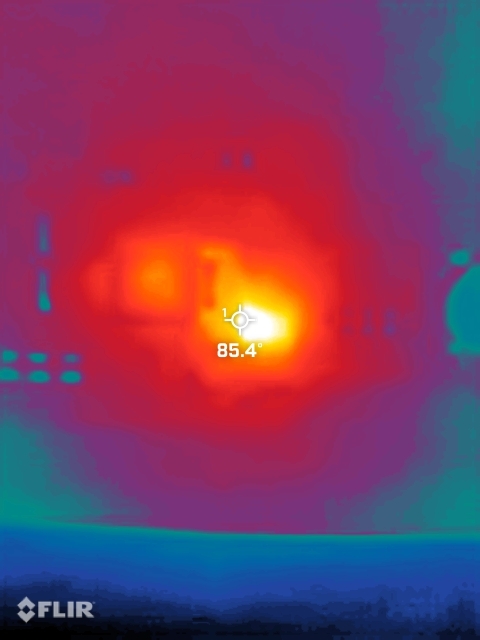

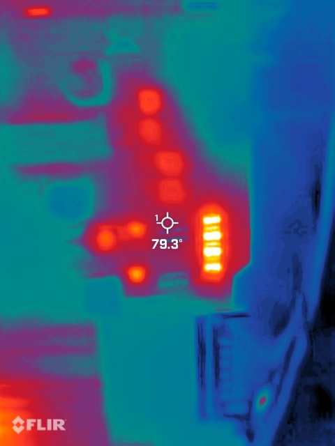

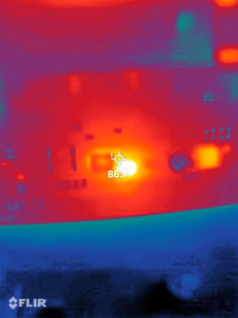

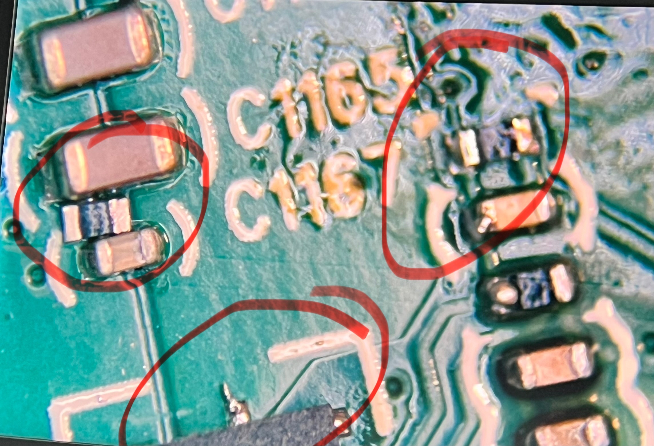

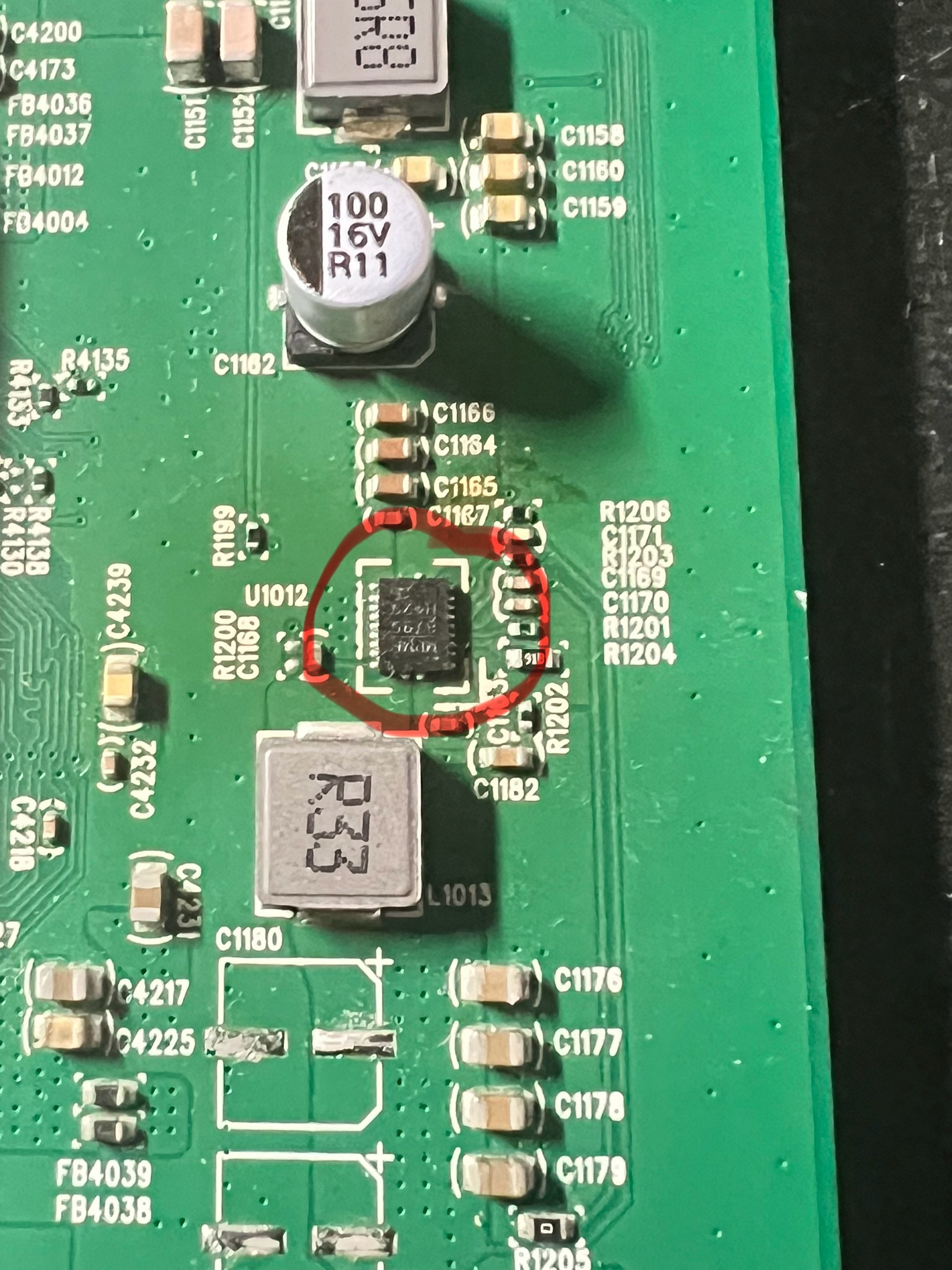

m1ch43lzm lotas I understand I need to find the cause however I haven't found any shorts in the area. I asked the owner if he had any power surges he says his lights are always flickering. He's in a know area for brown outs. Currently the monitor powers on and just won’t show any video. I’ve also gone over it with a thermal cam. The pic with the red circles is what saw when I opened it, it has never been opened before I can’t find anywhere that chip belongs either. The single red circle is in the same area where I found the loose chip and is also one of the hotspots. So not sure if this could have blown the fuse.Comment
