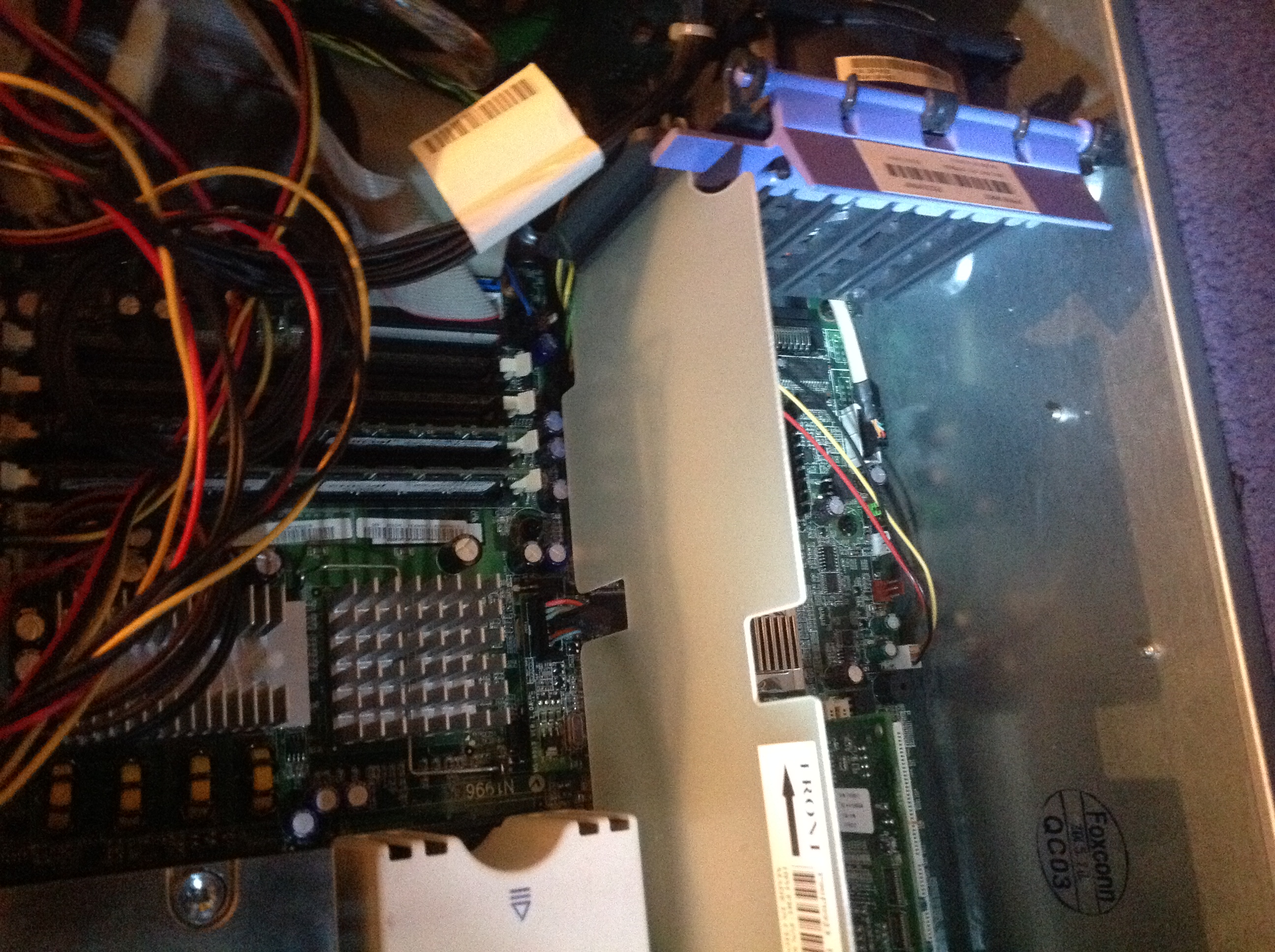

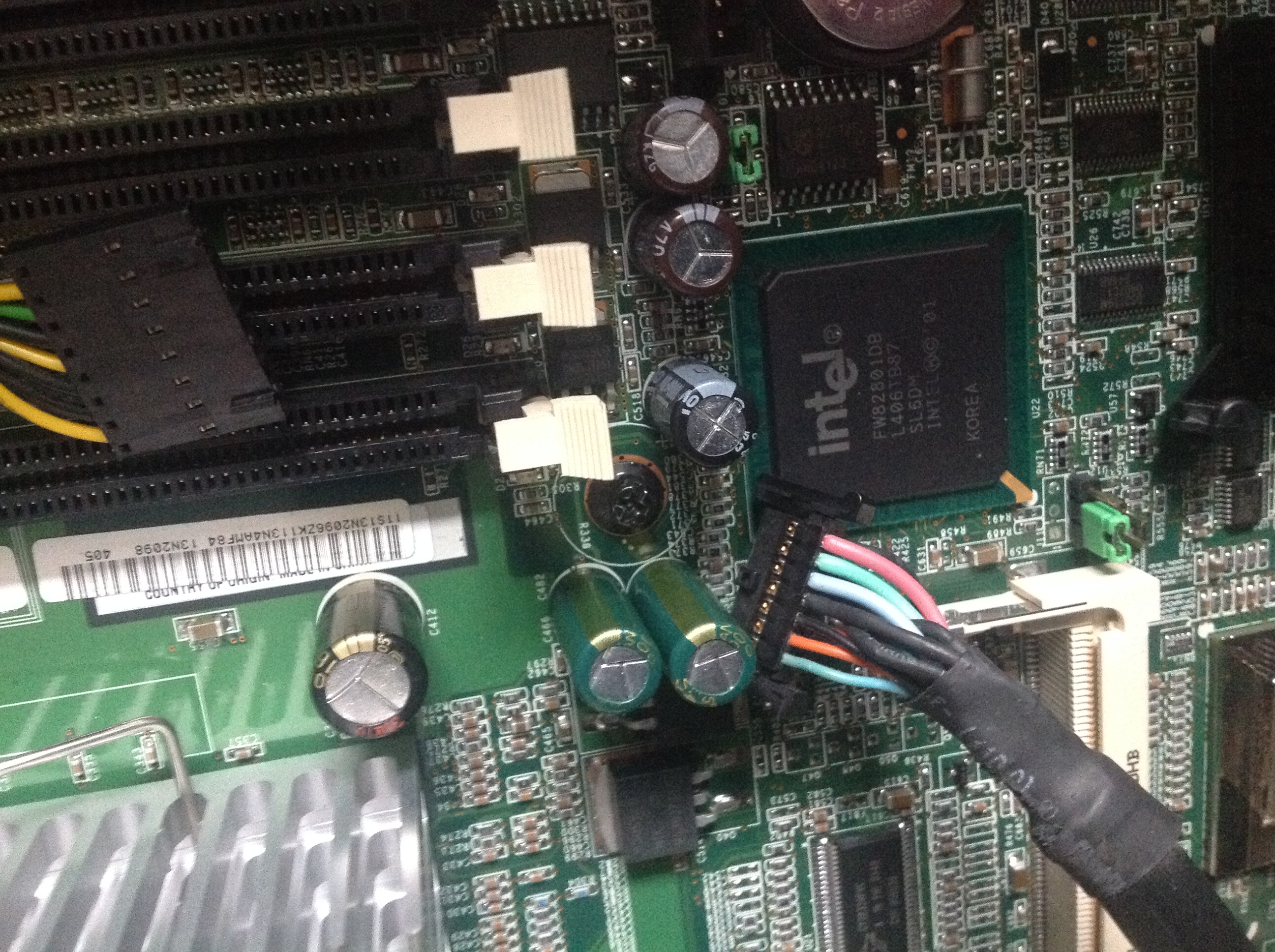

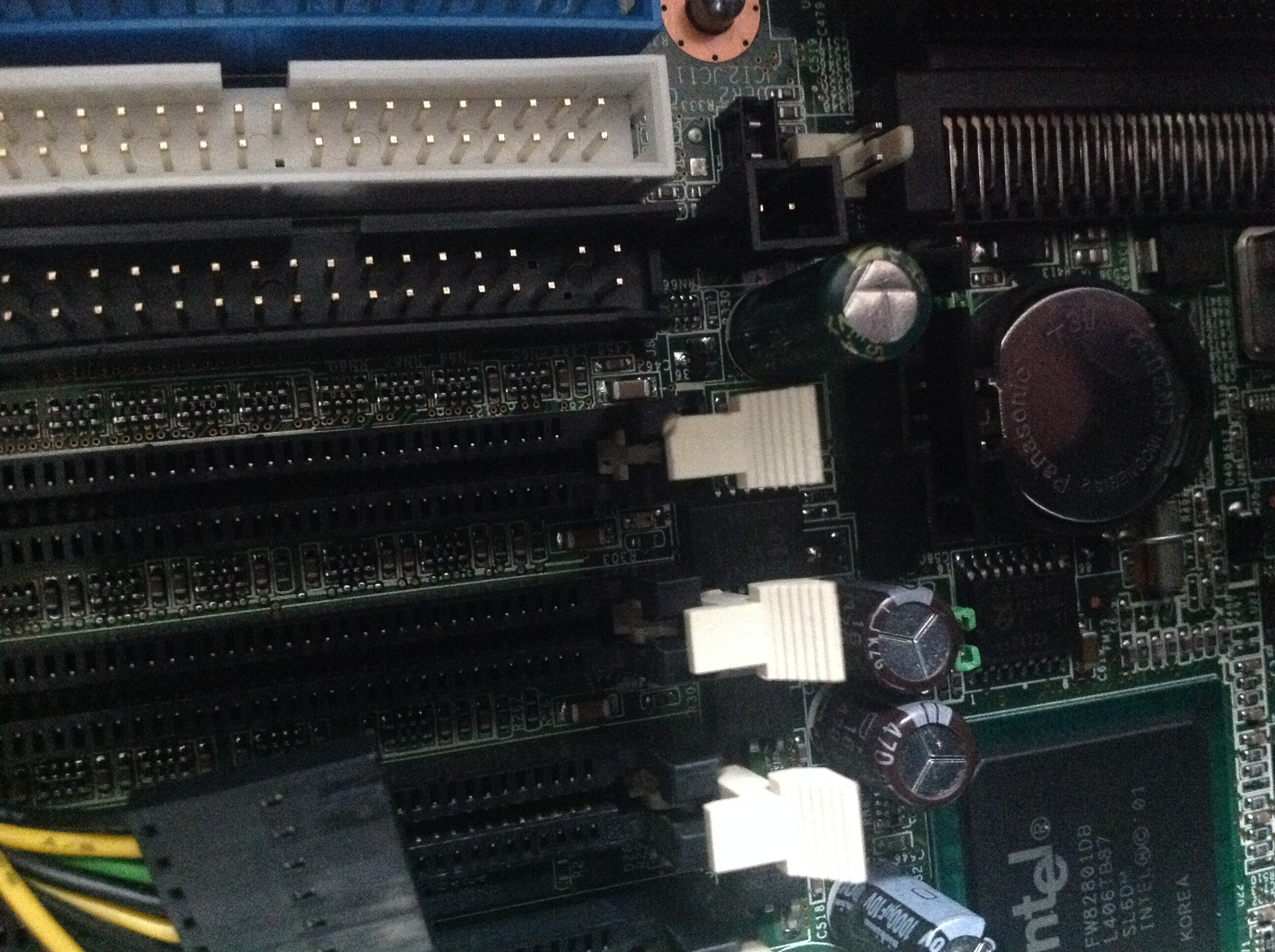

    Will this recap work ?

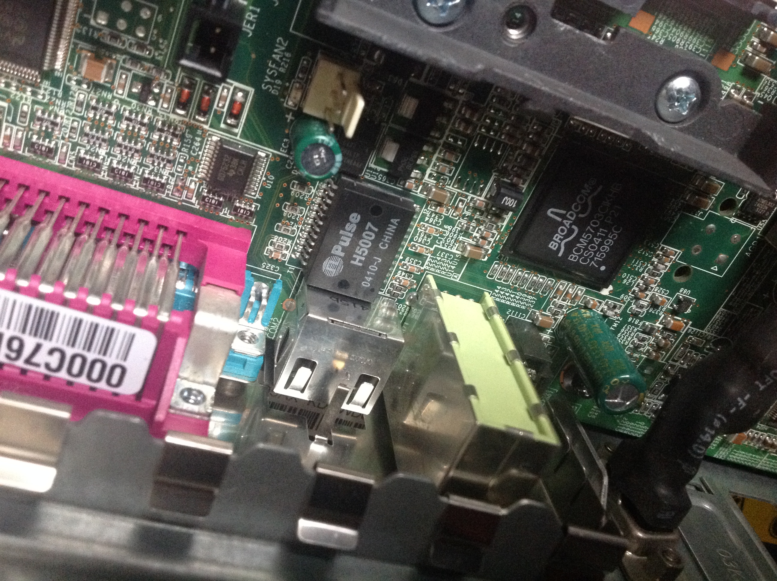

    So I brought a ibm eserver 225 off ebay it has a mixture of nichicon hm panny fj and ucc kzg, as I was looking aorund I saw that some of the caps were not soldered through the board but to the top copper pads on the surface, I was just wandering will this work or should I remove the board and resolder them ?
    The server works fine btw.

    Re: Will this recap work ?
    Someone may have done a repair job? If the date codes on the those capacitors that stand up are different from the others, then you have a good indication that someone did a repair job.
      If it isn't too much trouble you might want to pull it and inspect the bung to make sure it's a legitimate Panasonic capacitor. I know Hermei uses Panasonic's vent stamp. It'll function like that, the ESR will just be a little bit higher

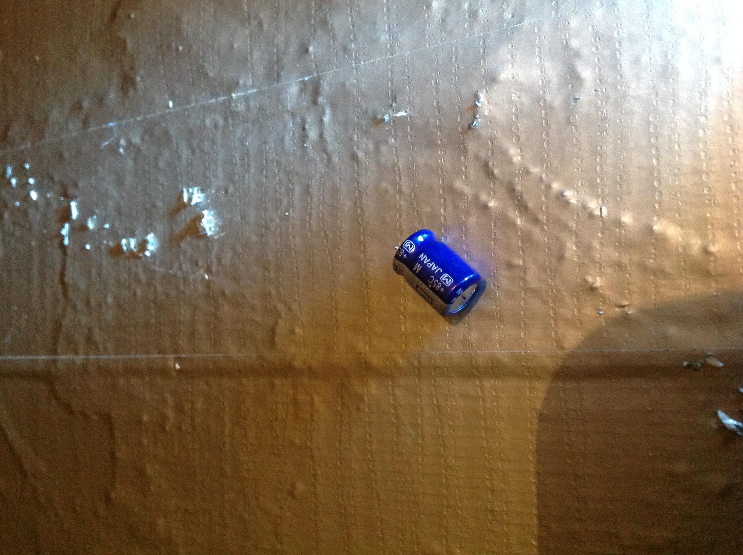

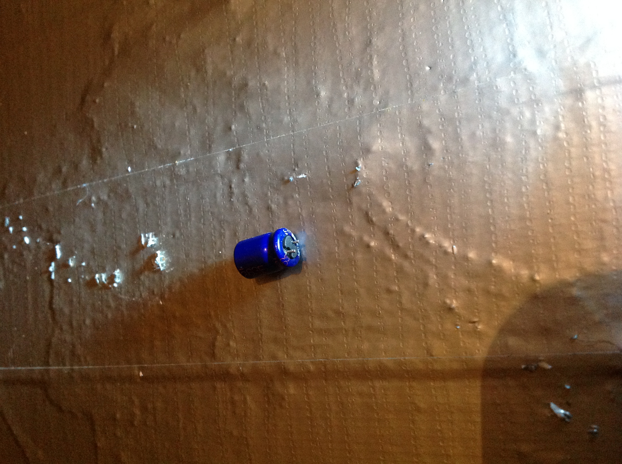

        Hello thank you for the replies it is a genuine panasonic fj the bung is fine I bent over the cap and its good, so will the repair be fine ?
          It's not done properly, but it's not too bad either. I'd say it's fine though.

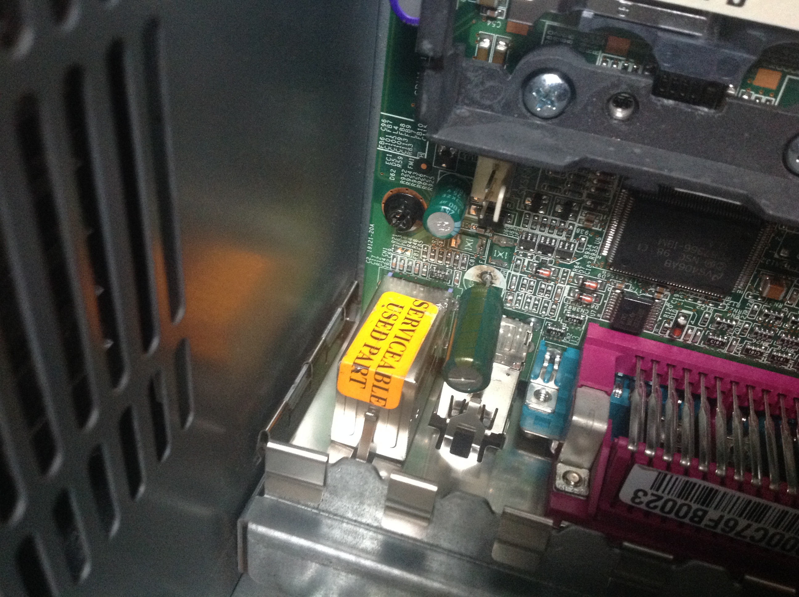

              I've never seen panasonic fj in that color before
                It all looks genuine I can take pictures if you want ?
                      Agreed. Either it's not an FJ, or someone has recapped it with fake caps. Real FJs are black with gold markings
                        Panasonic M series (general purpose 85°C) uses that color scheme.
                        Also, having the caps raised off the board and soldered like that makes me think the board was damaged while removing the old caps and that was the only way they could get it to connect to the correct trace.

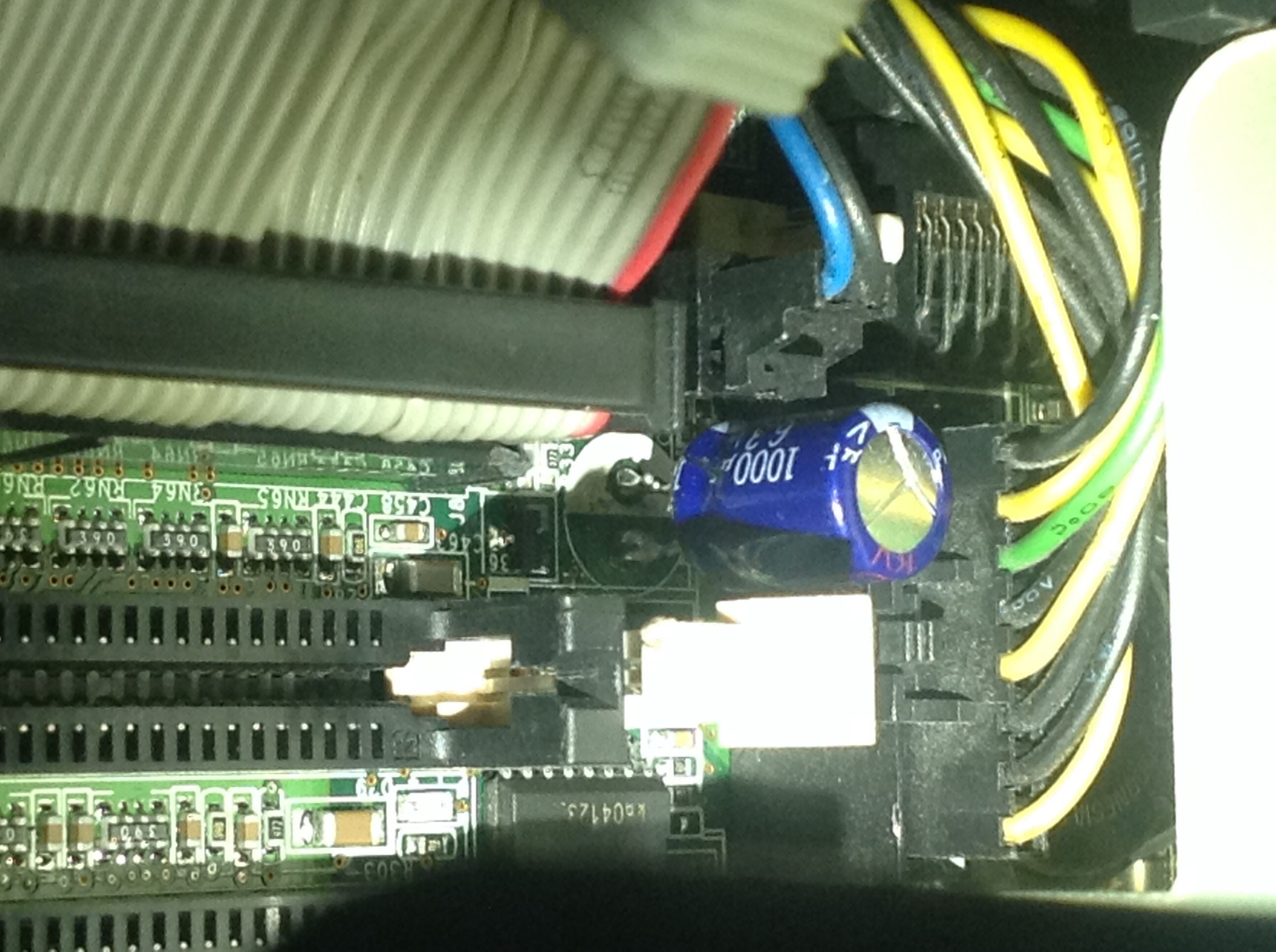

                          They appear to be genuine and I tested them with lcr meter at work and they seem perfectly in specification.
                          I re-soldered them all works fine.
                            Ah. It's an M series, not FJ. These are not suitable for use on a motherboard.
                              Ohh are they dam just put the board back in I will used nichicon hz thank you all.

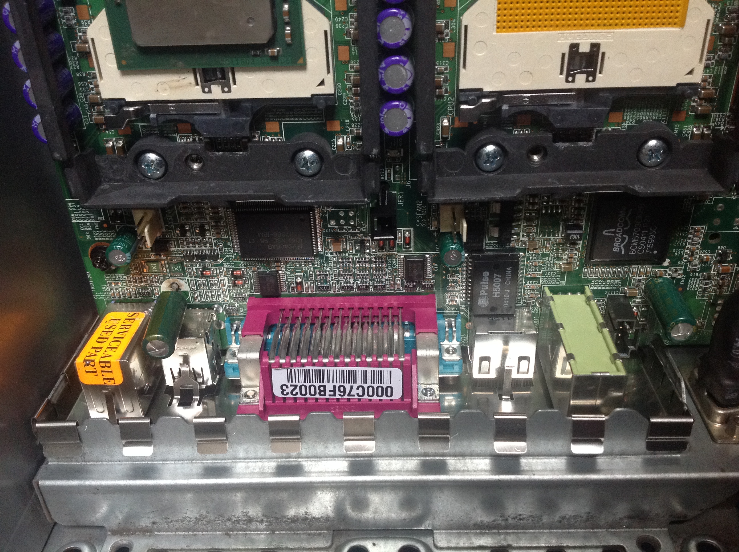

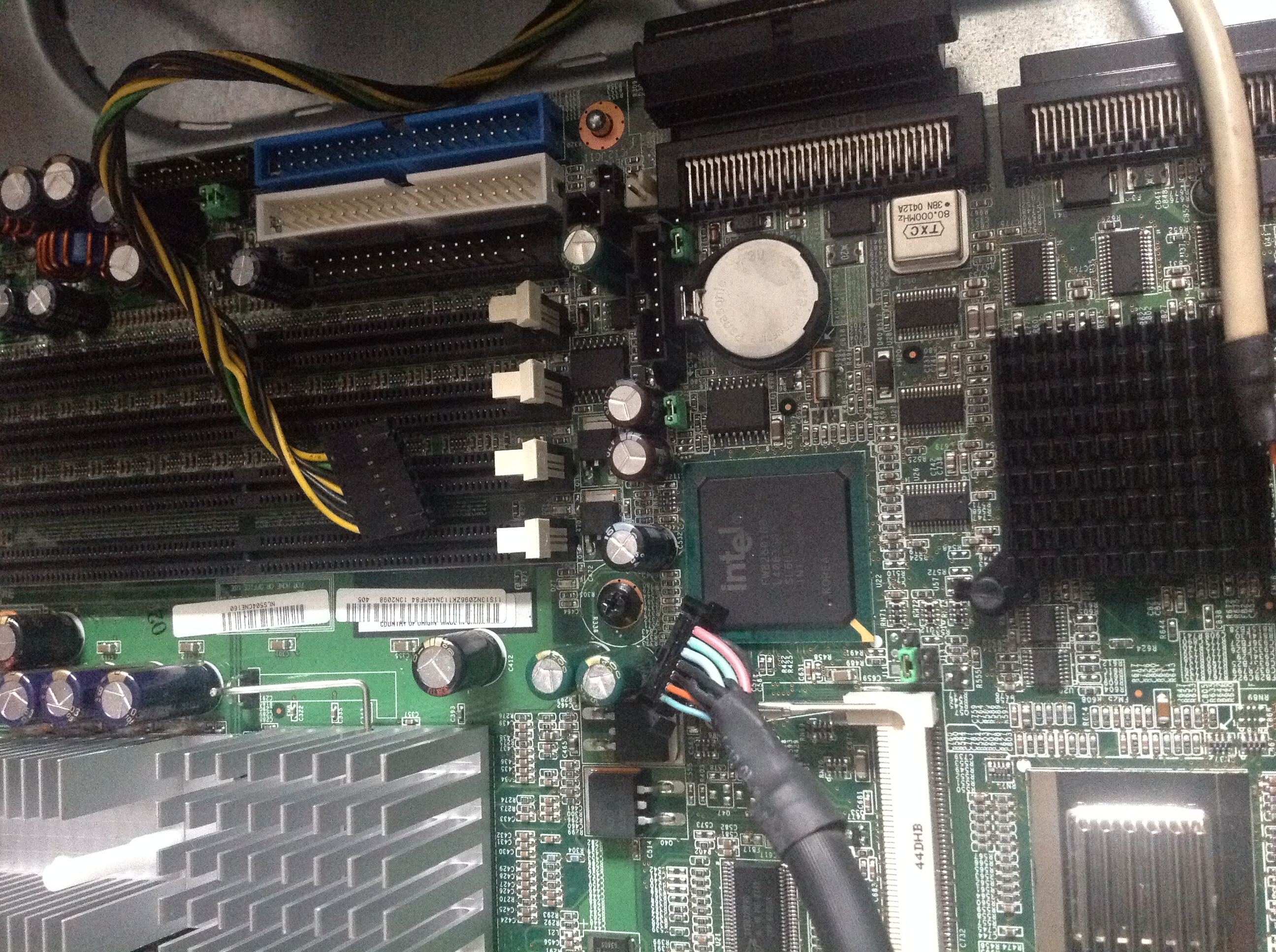

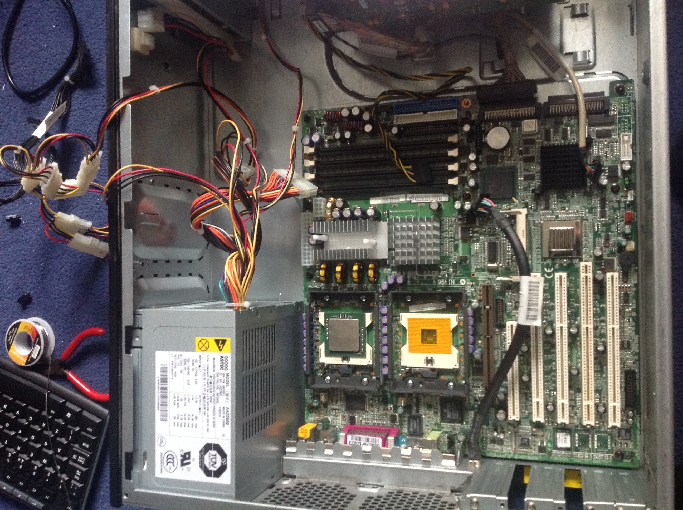

                                    Got around to recapping this board, used sanyo wx works fine had to keep one of the capacitors floating as there is a capacitor lead blocking the hole and I cant get it out with out ruining the trace so I had to keep that one floating but it works fine.
                                    Pictures showing the new capacitors.
