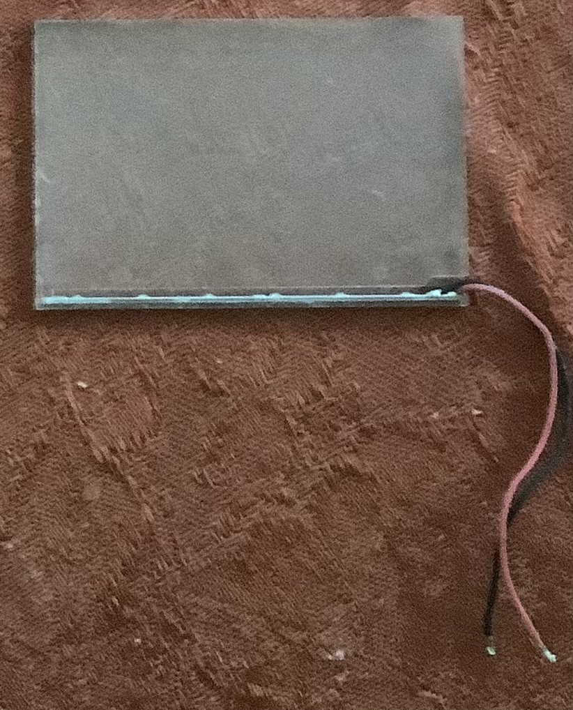

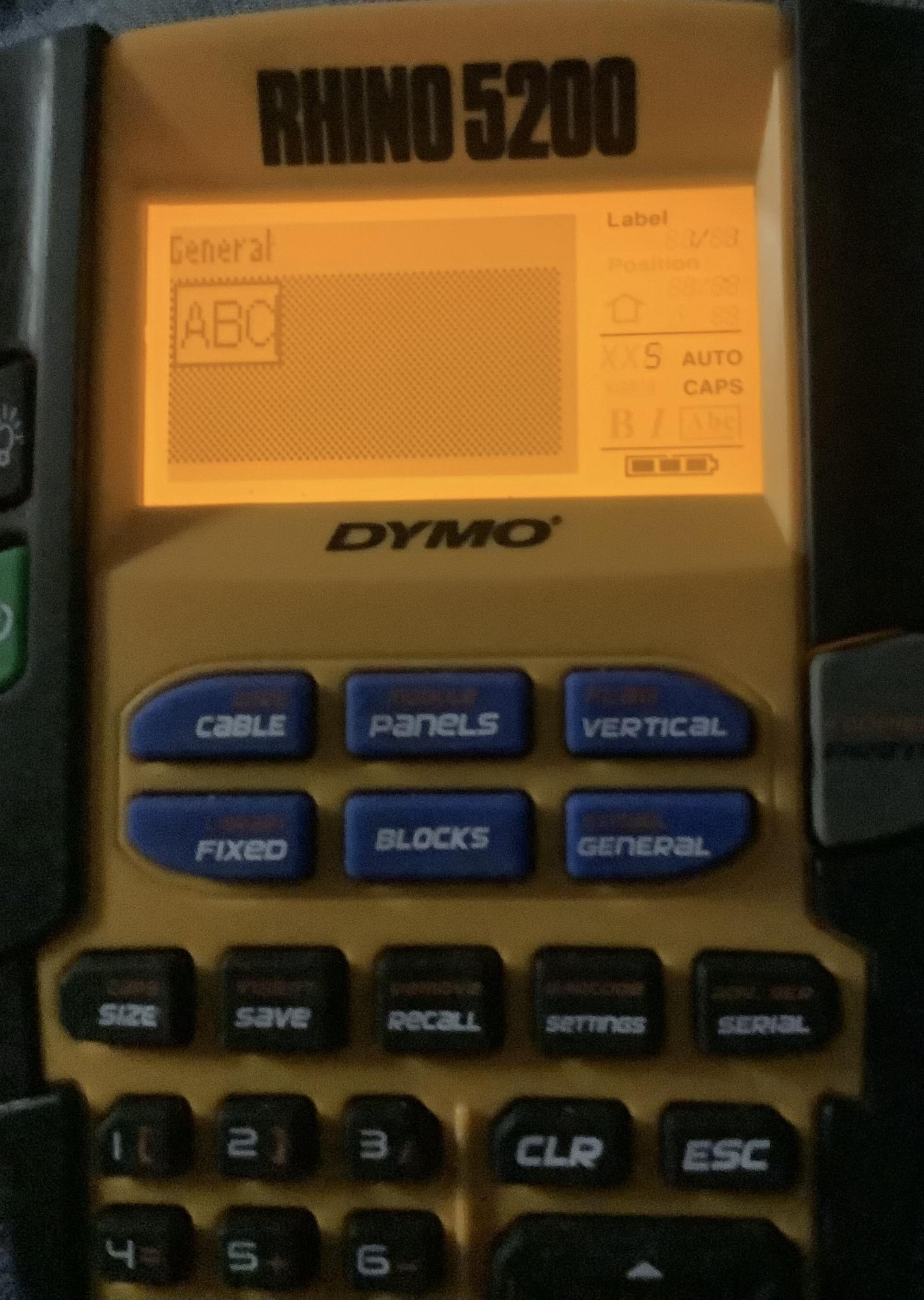

    The label maker that I bought for parts that the display is bad but the backlight was working so I looked at both board where the LEDs hooked to the circuit board and I see that the one that the backlight did not work the control transistor had fallen off the circuit board because the soldering joints looked like they did not get enough solder on the soldering pads
    So I carefully removed the transistor off the board that the backlight was working but display was bad it looked like the display had separated because the one that works if you lightly press on it you can see the image come up and disappear on the one that does not work if you press the screen you do not see anything at all just a piece of glass
    So the repair is completely done and the label maker is put back together and working properly again

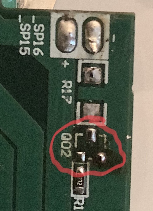

                            • Jul 2011
                            • 6070
                            Re: DYMO Rhino 5200 Industrial Label Maker that the backlight does not work any ideas
                            Originally posted by redwire
                            Post pics of the backlight LED and board to see what to change.
                            Here is the picture that you asked for sorry I did not get to it earlier
                            The resistor was removed also so I could get to the transistor pads
                            Unfortunately there is no part number on the transistor ( that I could see or make out )
                            The plus and minus is where the backlight connects are
                            I hope this helps you with what you need to know

                              • 31256
                              switching the gnd line any NPN will do
                                • Jul 2011
                                • 6070
                                I will keep this mind if I have to replace it if it stops working again
