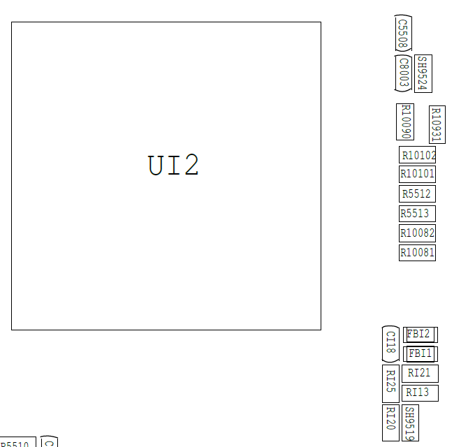

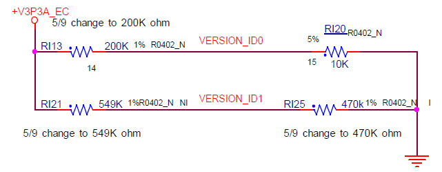

      https://www.badcaps.net/forum/troubl...4ikb-schematic
      Check post #14 for the schematics and silkscreen (no proper boardview, but it'll do)
      Compare the values of RI13, RI20, RI21, RI25 on both old and new boards, you may need to modify the new board to match

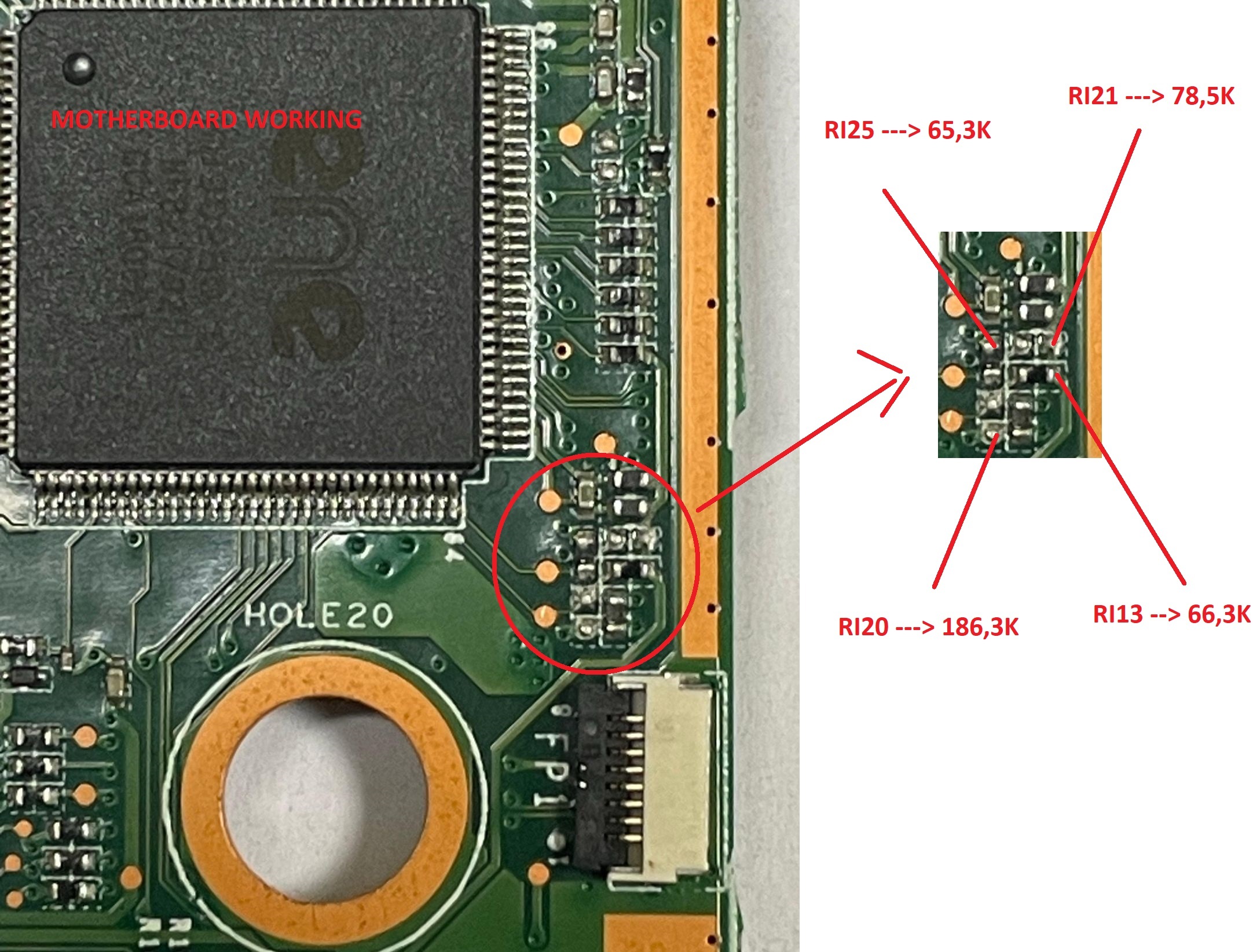

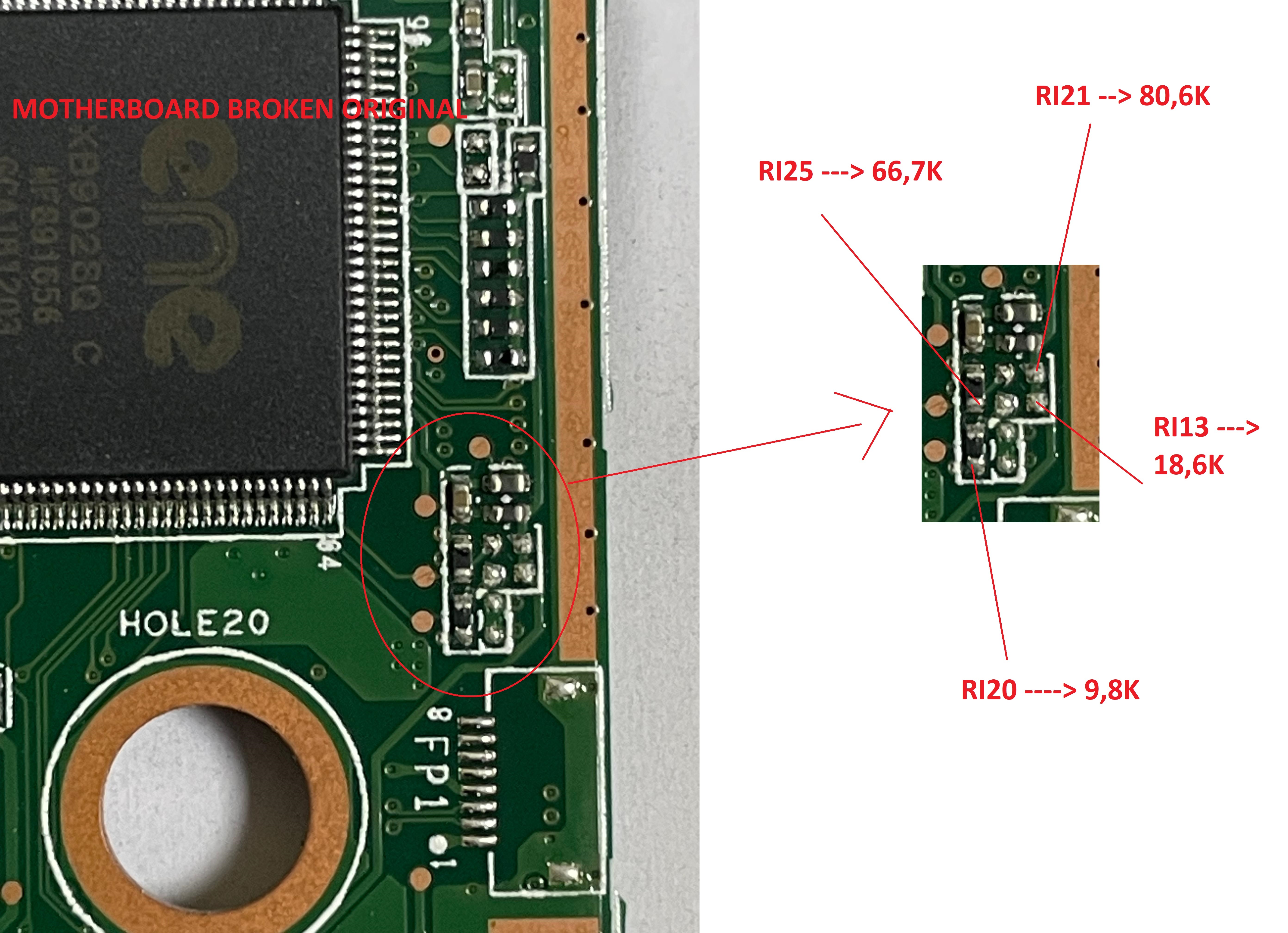

        here are the measurements between the broken motherboard and the new one, I can see (photo) that between the two motherboards the resistors are positioned differently:
        MOTHERBOARD BROKEN ORIGINAL:
        RI21 80,6K
        RI13 18,6K
        RI25 66,7K
        RI20 9,8K
        MOTHERBOARD NEW WORKING:
        RI21 78,5K
        RI13 66,3K
        RI25 65,3K
        RI20 186,3K​

          The modification should be, according to your pictures
          1. Remove RI13
          2. Install a 10k resistor at RI20, you can take it from the dead board
          You can use a soldering iron to remove RI13, otherwise you risk damaging the plastic connector below with hot air
          As i said, You got a board for the 14" model (330s-14IKB) as they look identical on the outside
