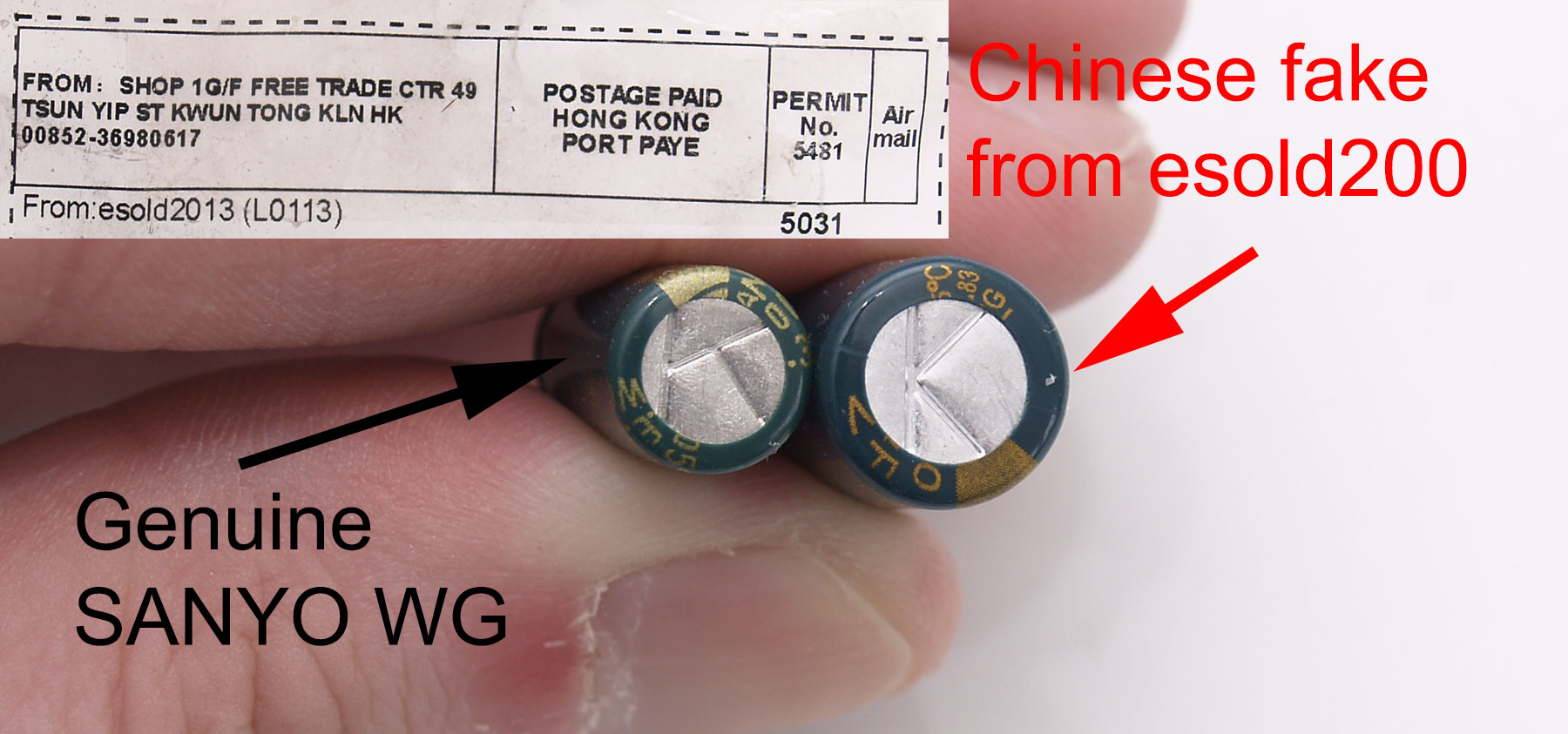

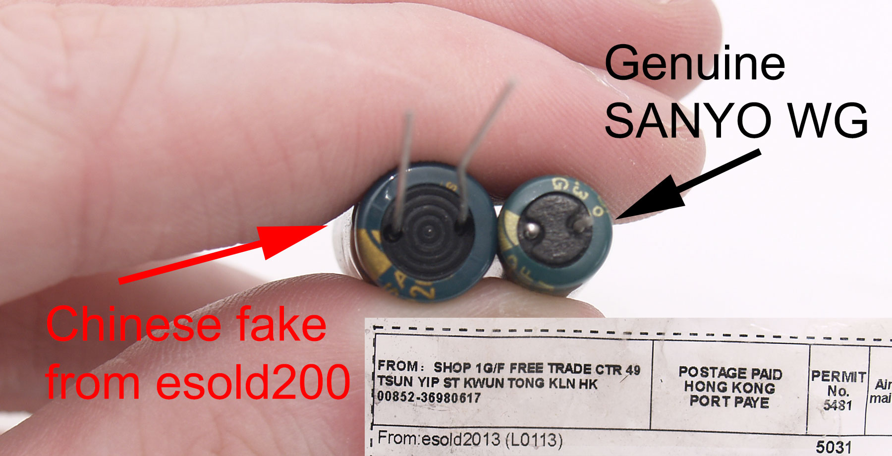

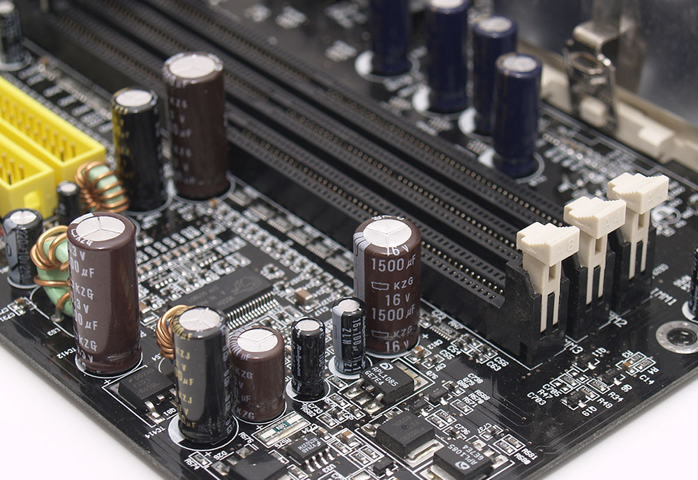

    A few days ago I got to fix office PC... with no value and Lelon craps. I was use some older capacitors from my own stocks and buy extreamly cheap capacitors on eBay.
    Nippon KZJ (5x 1500uF/6.3V d8): http://www.ebay.com/itm/150794452255...84.m1439.l2649
    Nippon KZG (10x 3300/uF/6.3V d10): http://www.ebay.com/itm/161008568298...84.m1439.l2649
    Sanyo WG (10x 2200/6.3V d10): http://www.ebay.com/itm/10Pcs-SANYO-...-/160878388372
    Nippon (10x 1000uF/6.3V d8): http://www.ebay.com/itm/150884877068...84.m1439.l2649
    Total price including shipping: $7.7 + $10 one hour my work (at first sight it looks awesome)
    Item specifics
    Condition: New: A brand-new, unused, unopened, undamaged item in its original packaging (where packaging is applicable). Packaging should be the same as what is found in a retail store, unless the item is handmade or was packaged by the manufacturer in non-retail packaging, such as an unprinted box or plastic bag.

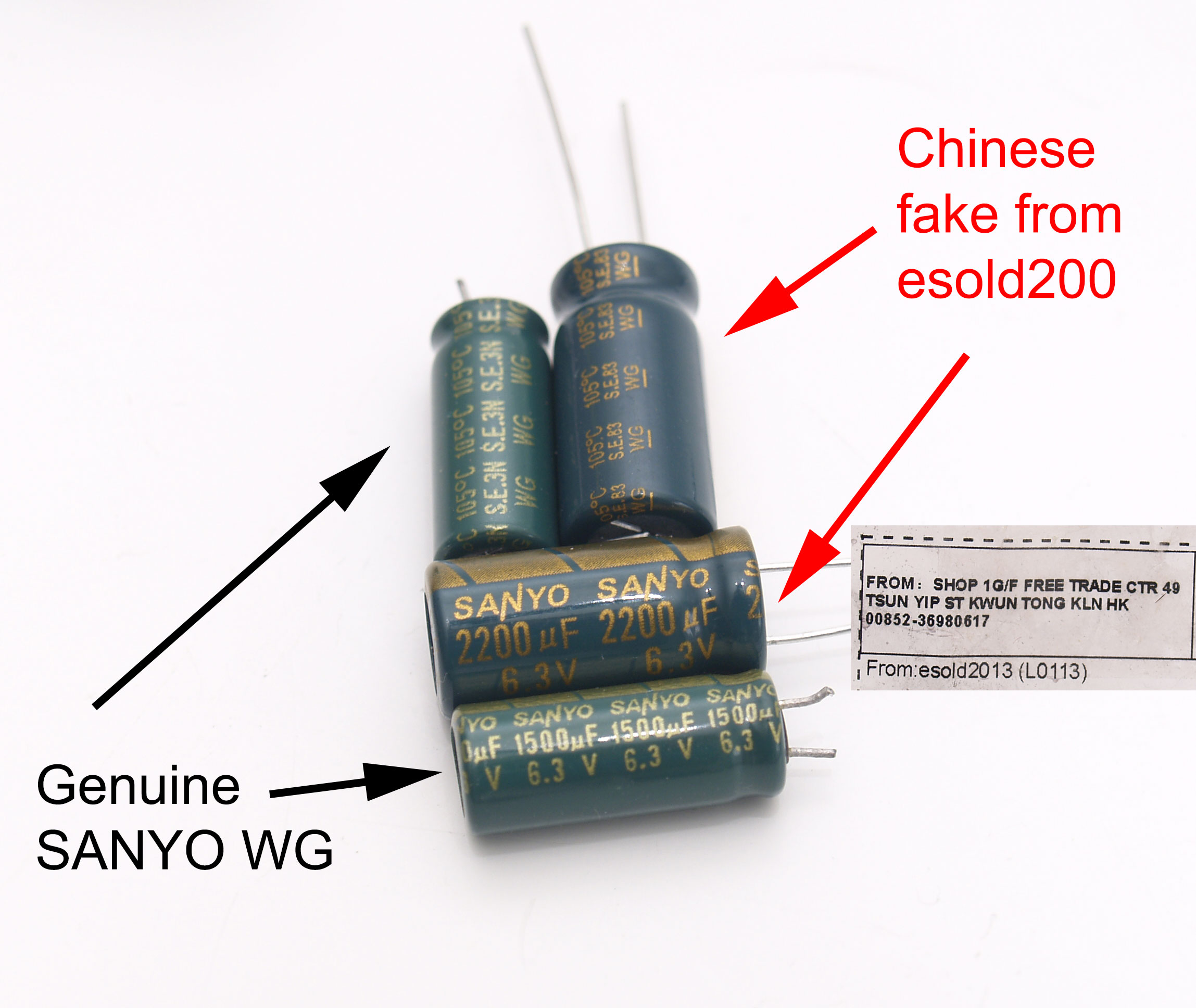

    Chemicon has arrived used (but only two is bad, others are in perfect condition) and 10 "brand new genuine" Sanyo WG. I measured it... 90 mΩ.

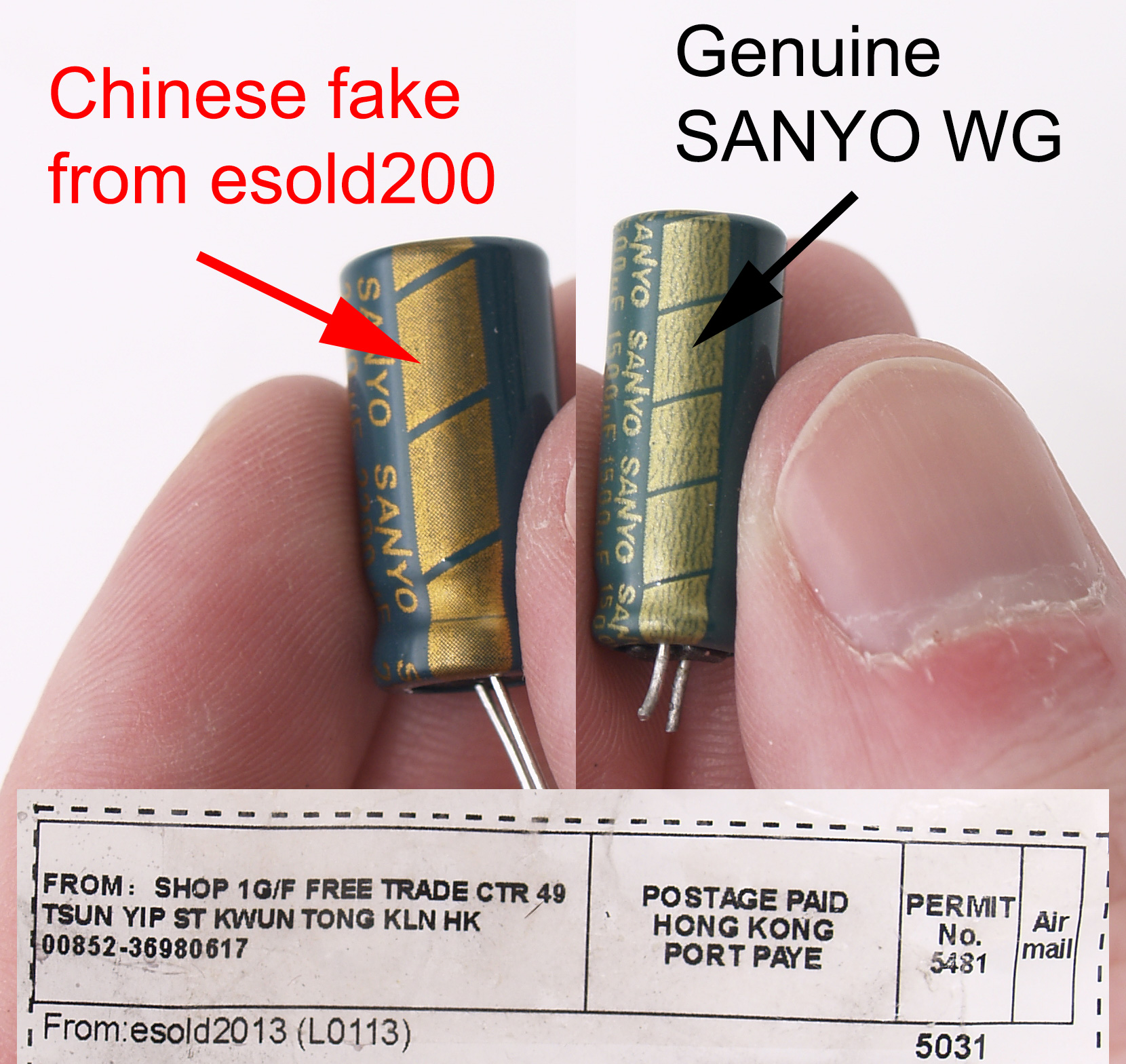

    My communication with seller:
    Me: "It's not genuine Sanyo WG Series capacitor. Original Sanyo have different vent and gold color marking."
    Seller's message:
    "I am regret to hear about this,i think you make a mistake,it is no all the Sanyo have gold marking,they are not packing the same package all the way by the factory,you can check it again and more clearly,and i many buyers purchased these items from me without any problem,i am a honest seller,and if the capacitors have any quality problem problem,i will issue you full refund. Please feel free to contact me if you have any problem. Sincerly yours"

    there are also nichicon fakes with those same colors.
    good job making all aware of these crooks!
    as fakes go those are lousy.what isnt wrong?

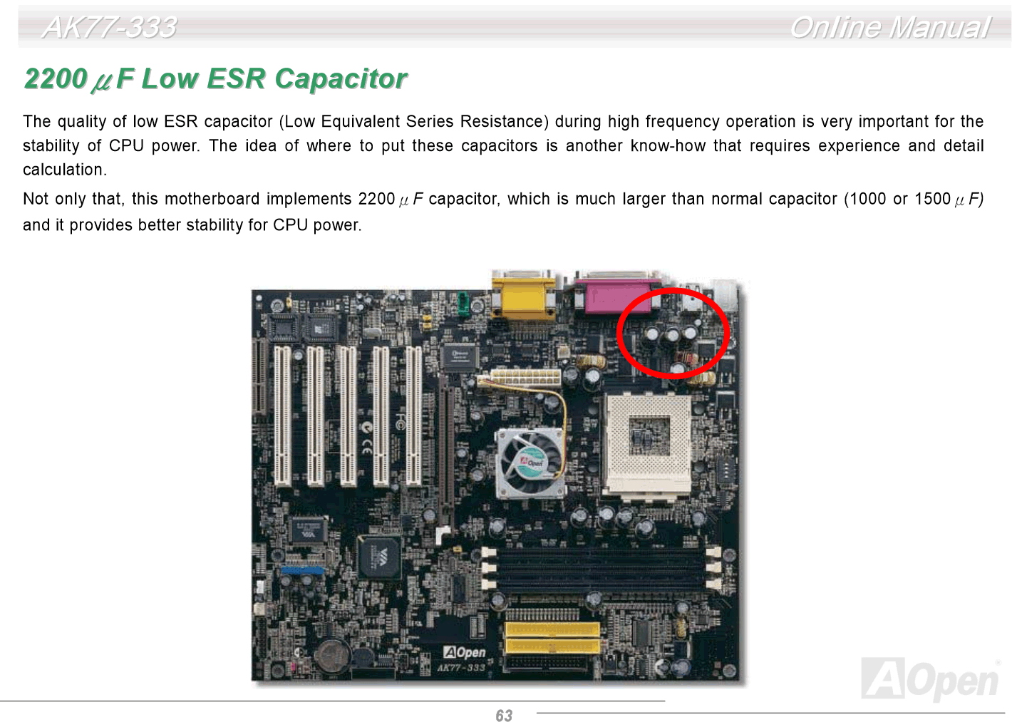

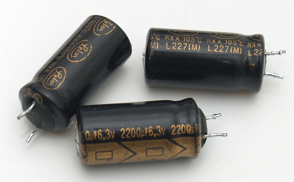

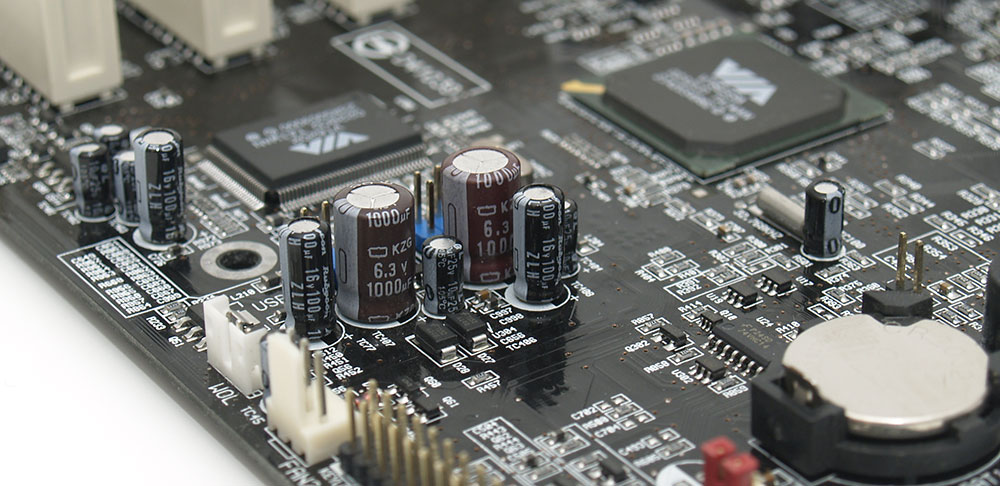

          Do you know about cheaper option how to fix it 10 year old motherboard AOpen AK77-333? There were two options:
          a) trash
          b) gamble with Chinese seller and extremely cheap capacitors
          It's not joke, AOpen says: "Lelon is kind of quality brand"

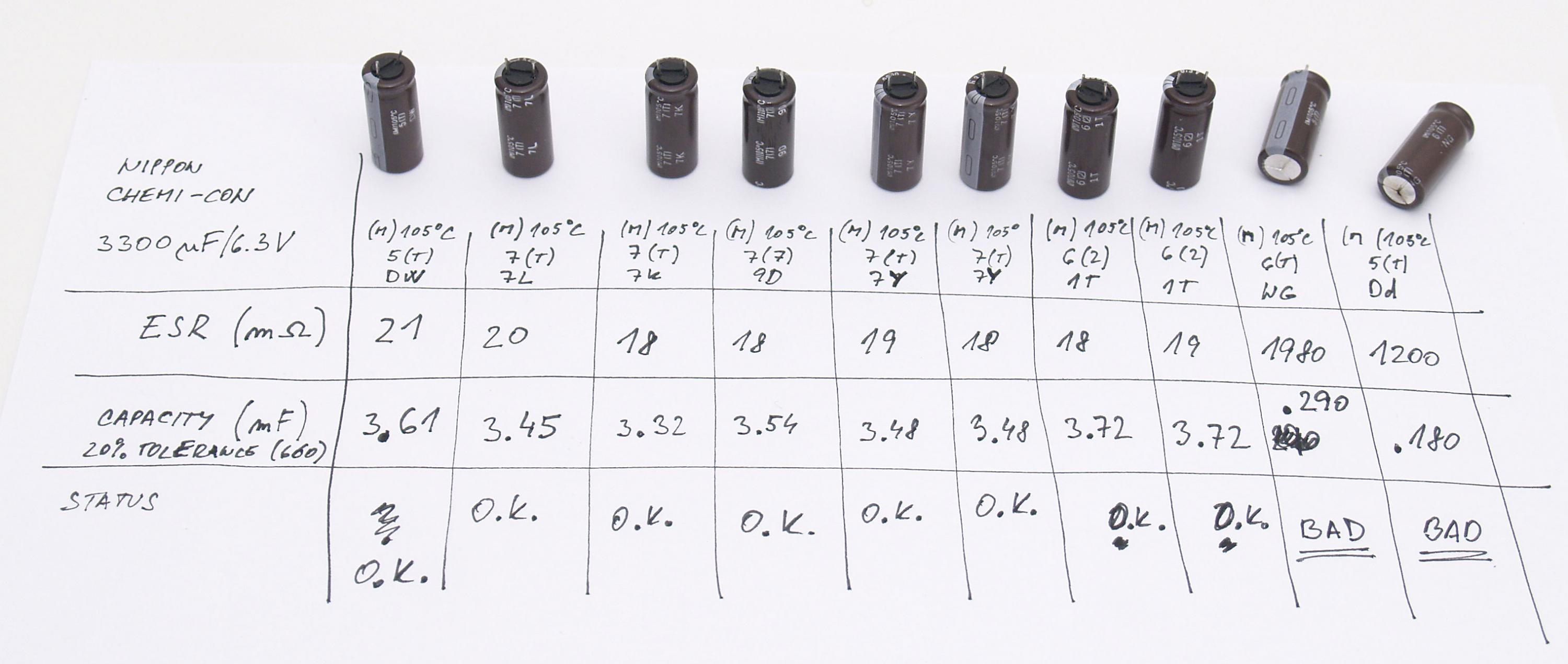

          Everything is better than Lelon. All of used capacitors (proclaimed as brand
          new) have between 18-25 mΩ ESR. Only two were defective (plus 10 fakes).
          After recap photos:

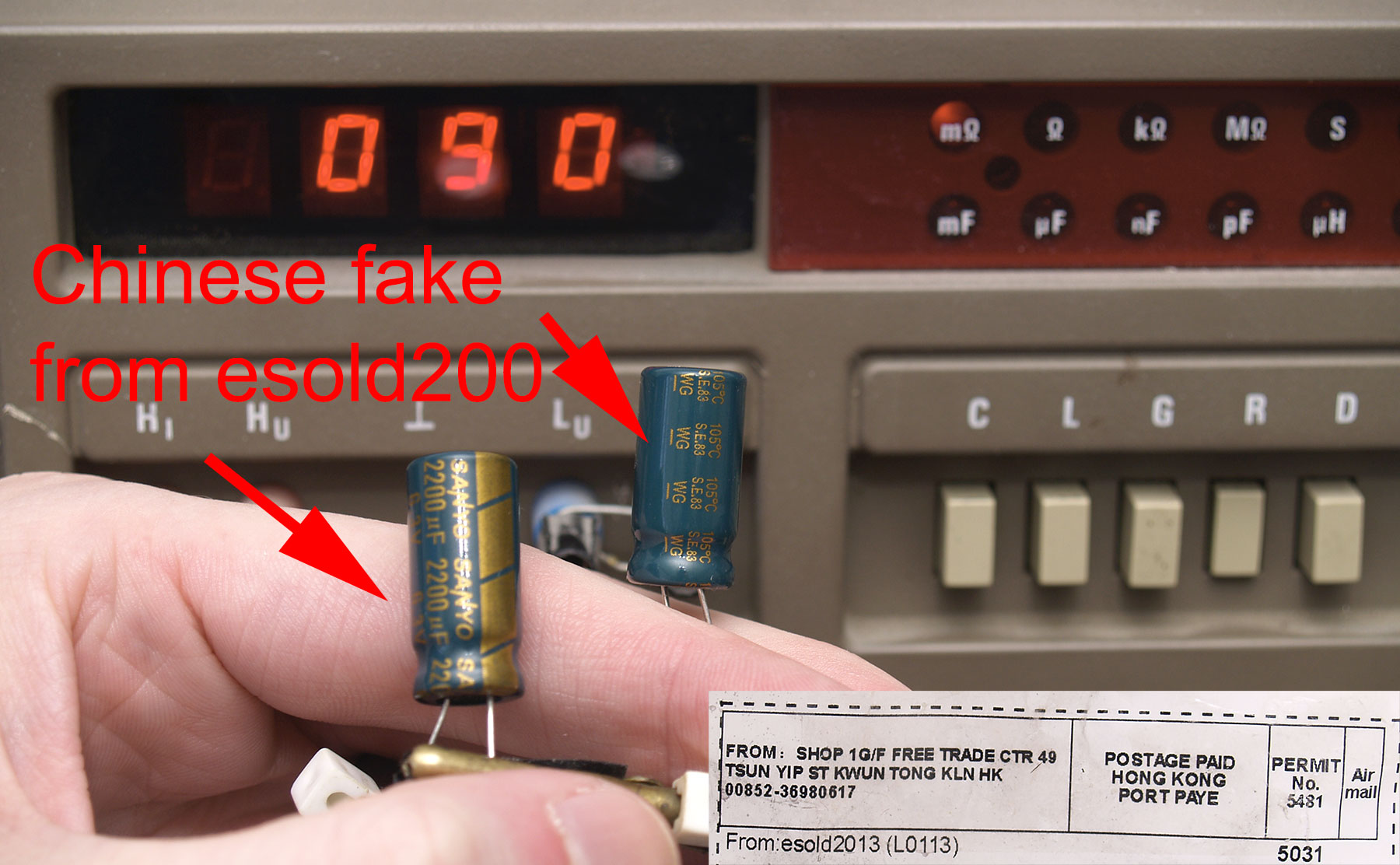

                Which is the brand / model & test frequency of this old meter ?

                  Man I love ebay for caps.. Almost certain to get some fake ones.. Theres a few good sellers I use. Anybody else I expect to get fakes.. I have a few of those Sanyos laying around..
                  Edit: Do we have a thread for ebay sellers? Bad or good? That "esold" guy is almost certainly 100% fakes..
                  These are same seller here..
                  Please note this seller is definately selling counterfeit capacitors.. Under the ebay usernames: Esold200 \ Drqueen2012
                  Do we have any other usernames for this seller?

                    Re: Beware next generation Chinese fake Sanyo WG!
                    They put a Rubycon vent on a fake Sanyo; do these guys even look at the capacitors they fake? It sounds like someone described the Sanyo over the phone: "it's got a kind of K-shaped vent, the casing is green with gold print, it has some diagonal lines on one strip..."

                            Total value of computer with AMD Athlon XP 2000+, AOpen AK77-333, 384 MB DDR333, 20 GB HDD, CD Burner, 250W FSP is less then $30. Profitability is the most important thing!
                            For more expensive motherboards I use Rubycons and Chemi-con from local resellers (Distrelec, Farnell, Ecom...). And I agree - buying capacitors from Chinese eBay is gamble.
                            Tesla BM 591.
