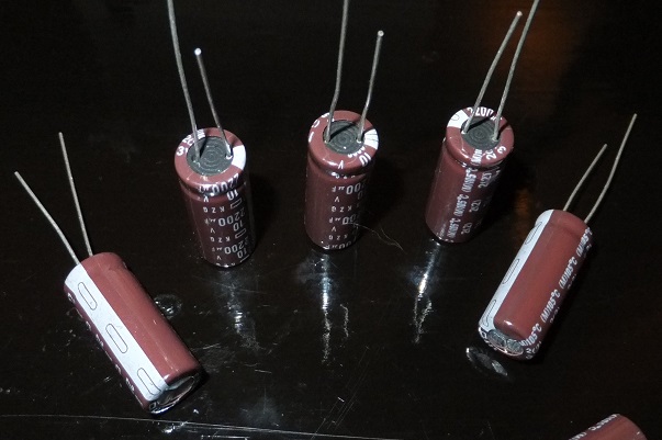

          I just came across some fake KZG's. Like seriously, why even bother faking KZG?
          They measure correct capacitance and 0.02 ohm ESR

            You sure they are fakes? I have very strong feeling that NCC actually started using this sealing. I have noticed the new KYA caps I have from chinese distributor for low voltage have this sealings and for higher voltage have different. So I checked older KY from reliable source (Digi-Key) and was quite surprised they also have different sealings for different voltages (although not directly this circular).
            As also Samxon started using these circular sealings, I have acquired the opinion they are all slowly switching to this type. Probably somewhat cheaper and still good enough.
              I get fresh Chemi-con caps in every week from authorized sources Mouser and Digi-Key, and I just sat here and checked dozens out of curiosity, and there is no Chemi-con cap I have ever seen with a bung like that, so they are fakes. - the Chinese will fake anything that is or was popular, so this is not so surprising.
              Stick with factory authorized sources only!

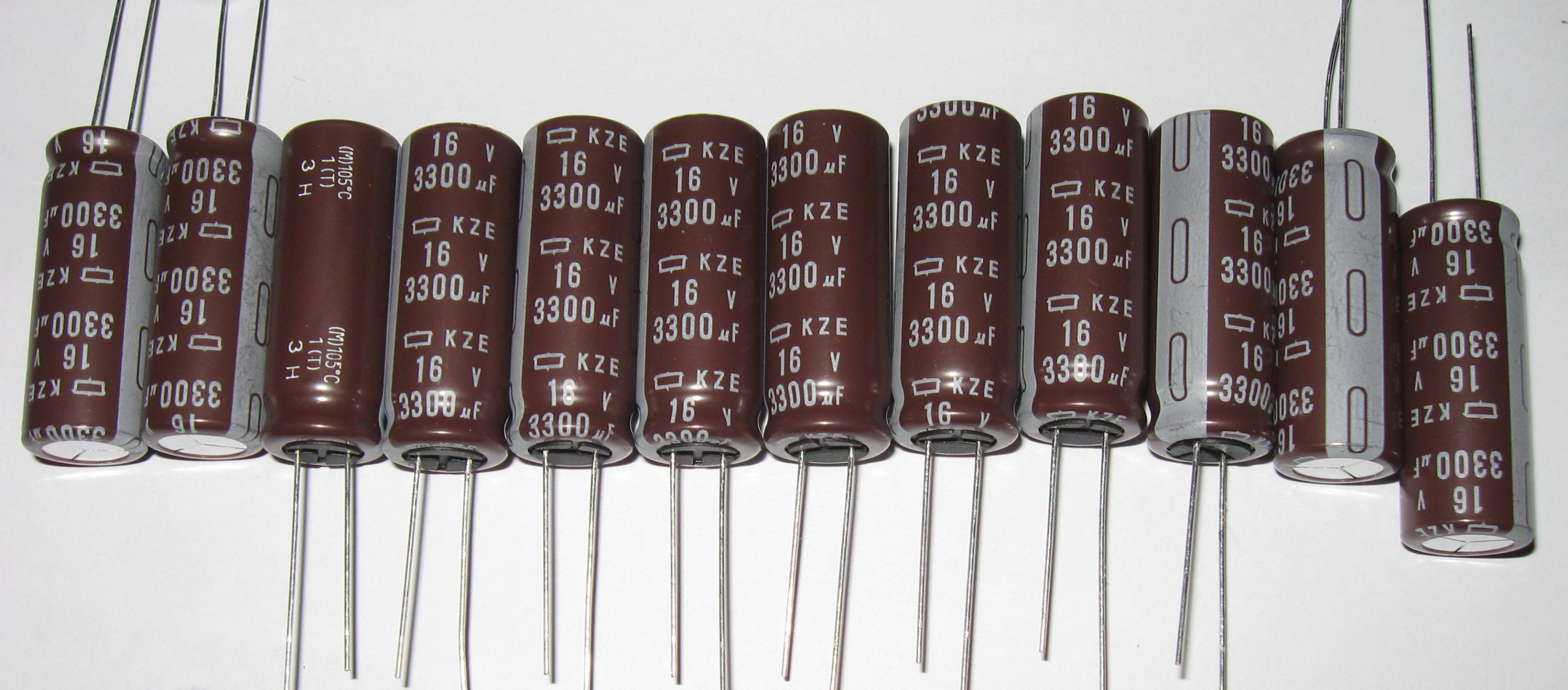

                  Here's a picture of the KZE caps.. the bottom has solder flow channels.
                  Circular bung is just cheap.

                    I've never, ever seen a NCC cap with a circular bung, so I am thinking you got fakes.

                      Are you all just basing your ideas on the fact it has never been used before->it will never be used in future? Do you see this flaw in your logic or not?

                        Changing the bung in the middle of a series is highly unlikely. If a manufacturer would change the bung, it would probably be at the beginning of a new series.
                        That and KZG being discontinued makes me definitely think it's a fake.
                        Rubycon MBZ, UCC KZG, some Sanyo series etc ... basically discontinued. People fake what's hard to obtain officially, everything you see on eBay it's either old stock or simply fakes.

                          Sure, but the KYA is new series…though it seems they have the sealings specified in datasheet, I'll chek that.
                            The datasheet shows they (the KYA series) use the normal bung, which is designed for allowing the flux cleaner to get under the capacitor to remove the flux near the legs.
                            Yeah, my ideas might be wrong, but I highly doubt NCC would make a move like that!
                            Try taking one apart to see if the bung has been put on wrong. I highly doubt that too.

                                Maybe the inner side of the bung is what we see on the outside. AKA it is inside-out.
                                Could you get a picture or two of the vent stamping? EDIT: Whoops, you weren't the one who posted the pics... LOL

                                  I have opened one, the sealing is same from both sides. The electrolyte vaporized quite fast from the aluminium foil. Also I noticed the uF has different font and the V is too far from the number. They defnitelly are fakes, all of them. Will be very mad at the seller…it's SKY FOUNDATION TECHNOLOGY CO, LIMITED.
                                  It's unpleasant findings, really, they looked quite authentic. I don't have anything else ATM so I'll need to keep offering them but will offer 5 years warranty with full refund/replacement if they go wrong as I am looking for source of originals right away.
