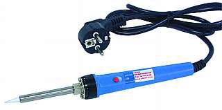

    I have a faulty MS-6340 mainboard in a five/six-year-old noname PC bought from Staples (UK) in around 2000. The PC started showing weird symptoms only a couple of years after I bought it, but at the time I had other stuff to deal with so I just stuck it in a cupboard and used another PC. Now I've dug the Staples/6340 out again, cleaned dust off the m/b (bristle brush/Hoover) and got it going. But the erratic working is soon evident (BSODs, fatal exception errors, freeze-ups, sudden reboots). I got it working for long enough to wipe the hard disk and reinstall 98SE from scratch. I also used System File Checker/Scandisk/Scanreg, so I reckon the software is okay. This is a basic machine. No NIC. No cards other than the graphics card. I've disabled the onboard sound chip. Often I switch the PC on, the green power LED comes on, the CPU and power supply fans come on, but there is no POST, zilch. Then I power down the machine, pull the power cord, tweak* one or two of the large caps, and ten-to-one this lets the machine reboot again - till the next time the failure occurs.
    I suspect the capacitors are faulty. See my pics at http://www.visualbasic.fsnet.co.uk/Capacitors-1.jpg and .../Capacitors-2.jpg. The tall ones marked (A) in the first jpg don't look too healthy, do they? (The ones at (B) look okay.) The big question: Can I replace these myself? I have soldered circuits before and can use a solder pump! But I am not an electronics wiz (motor fitter by trade originally). Is this a difficult job? Since I could probably buy a replacement m/b for £50, it may not be worth the hassle. I have read elsewhere that m/b's have several layers, so maybe soldering in new caps is not something that beginners can do. Any comments are welcome!
    * gently rock cap 1 - 2 mm from side to side

    i suggest you read a bit here and learn about the tools and parts needed.
    you definatly have a case of badcaps.a replacement board will likely fail the same way.
    i would practice on scrap boards and get some experiance first.

      Well i would say it isn`t that hard. Actually some basic soldering skills are required too. Most important take a good soldering iron, i suggest some about 50 to 80w, preferably tempcontroled and long life chisel tip. And there are some tip cleaner aorund (no, not the usuall wet sponge, "tipy" small dose with some cleansing flux and powdered thin). I noticed recently, that they are very very good for soldering at high temp. The holes are small and you need a very clean tip to conduct the necesarry heat. if you don`t want to spend a fortune for an iron, i suggest either the Weller W60P with an 450°c tip or one of those like in the attached pic for ultra small budget. i have the cheap one, if the tip is cleaned, you can recapp with it. But the tip is not a chisel and the heat is not that mutch, that you can do a busines with it. But for about 7€ there is nothing better i think. And obviousely, the board isn`t worth that mutch.

          I have not used lead-free solder yet. Is this old m/b likely to use lead-free?
          Are these caps easy to get hold of? (As in: purchase)

            No, leadfree is only after mid 2006 used. May be some months early but not before the end of 2005. At least on motherboards and other IT stuff.
            The caps are usually not easy to get, but depends on where you are located you can order them from the owner of this site if you are located in the USA or from other sources. Lock at the recapping section, there are some distributor listed.
            The replacement board will have the same ugly badcaps as your actuall. So nothing won on the long time.

                  There are four large caps and two smaller ones (all about 30mm high, 12mm dia).
                  The large ones are all 4700uF 6.3V
                  The smalls are 3900uF 10V
                  I've found the large ones at Farnell UK (Panasonic EEUFM0J472L).
                  But for the small ones Farnell only do 3900 6.3V, not 10V
                  Is it imperative that these exactly match the ones I'm replacing?

                              "I've found the large ones at Farnell UK (Panasonic EEUFM0J472L).
                              Is it imperative that these exactly match the ones I'm replacing?"
                              Kappa, replacing 10v with 6.3v should be OK.

                                The 10v components have been used for their low 'ESR' values, 6.3v of same capacitance will be fine
